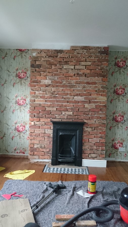

Hi,
We'd like some floating shelves installed either side of the chimney stack in our bedroom. Measurements are slightly different each side but are around 960mm wide and 330mm deep. 330 will sit them back into the recesses slightly.
In total we would like 10 shelves. 5 each side. We don't like the idea of any angled brackets and so thought floating would be best but realise they're a bit more of a pain to install.
There is nothing off of the shelf that would fit these recesses. I looked into ikea's solutions but unfortunately they're too shallow.
I found a company online that did bespoke woodworking projects. Total cost was £960. This to me seems very steep. Am I right in thinking this? We simply want them installed and we're happy to paint and finish them ourselves.
Any advice would be great. Thanks very much.
Attached is a pic of the space in question.

Depends on what wood it was? If it's oak. I'd say it's not too bad. Especially seeing your in London?
What thickness are the shelves?
We did some oak shelves, supply only to a fella the other day. 2 of them at around 650x350x20 and 6 small strips of 10mmx80mmx2m and it came to nearly £400. Because the waste involved in thicknessing down a 25mm board down to these sizes. And the labour involved takes a while.
I'd still shop around if I was you though.

You said floating shelves , so you don't want them to touch the sides .?
Happy for them to touch the sides. It'll probably be necessary for the battens I imagine? Oak isn't necessary either.
It's a shame as the Ikea ones are exactly the sort of look we're after but just not deep enough. The recesses are very deep.
5cm thick shelves would be good.

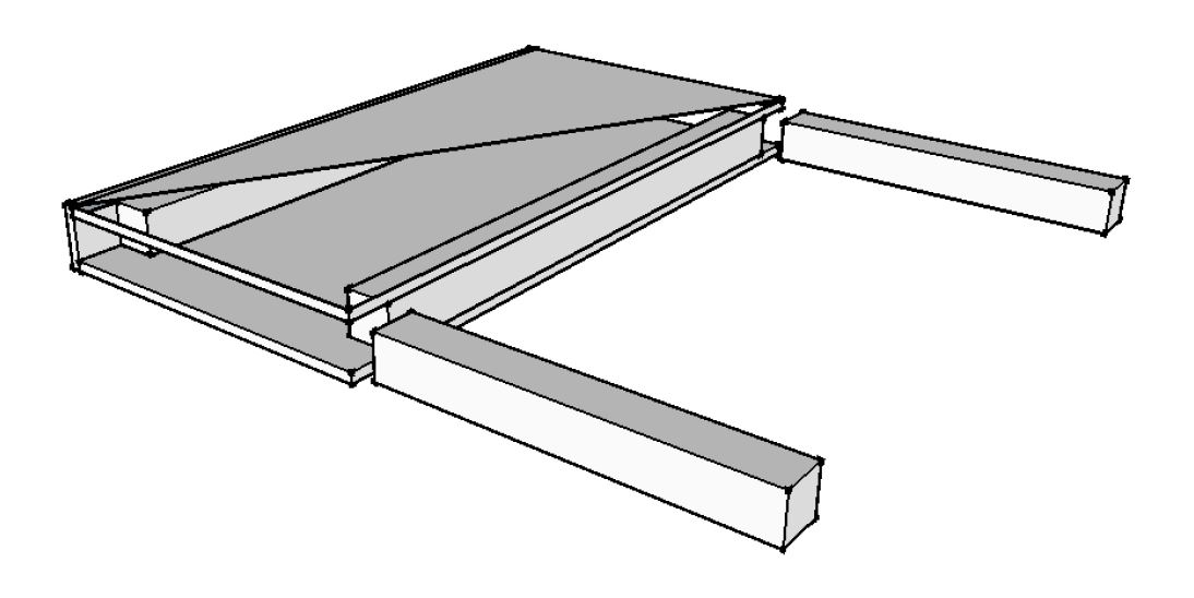

This is how I'd do it. Presuming you were to use ply or MDF sheet material to form the faces of the shelves, I'd prefer to mitre the three sides and set them up with glue, easiest way would be to get yourself a set of collins mitre clamps, glued around the same timber you'd use for the battens. You can add glue to this and screws on the underside that wouldn't be easily visible.. I'd fix a batten to either cheek of the recess the sides of the chimney breast, my quick sketch is roughly based on 2x2 material. Then slide the whole thing over the two battens and if you require fix with screws on the underside along the recess walls.
Not sure if my explanation is clear but with the sketch it might become a little more so.

Thanks for all the advice. I'm looking at tackling this at the weekend so again thanks for all the help.
