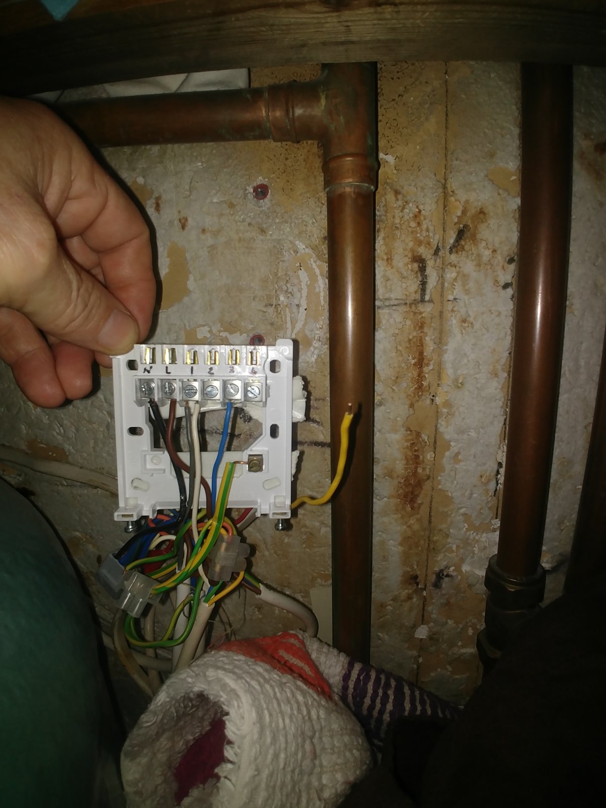

20181006_181331.jpg Hi i was hoping for a bit of advice.
Have just tried to put central heating on and the programmer came off the wall .
As i was about to refix it back i have noticed a loose yellow wire and am unsure as to where it goes as there are 2 free terminals
99% probability that it is 4.
However that entire thing is a horrid mess, and far more work is required that just fixing it to a wall.
All of those wires and connectors need to be in an enclosure / junction box.
