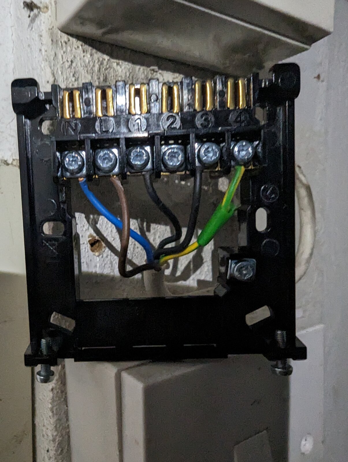

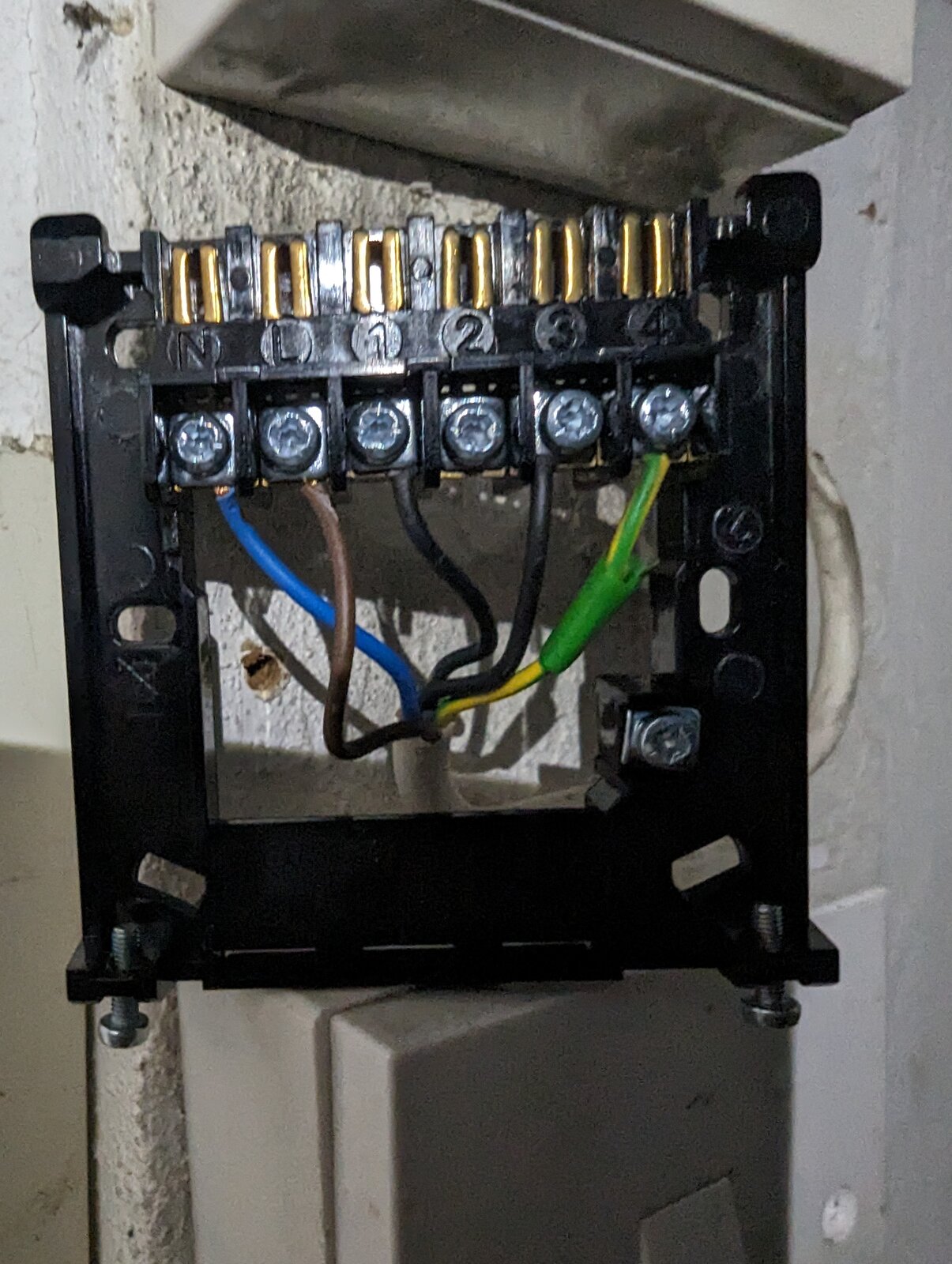

Hi,
I had a Drayton Tempus 7 programmer (2 channel) and wired thermostat and the programmer screen died. All heating/hw and the thermostat were working fine.

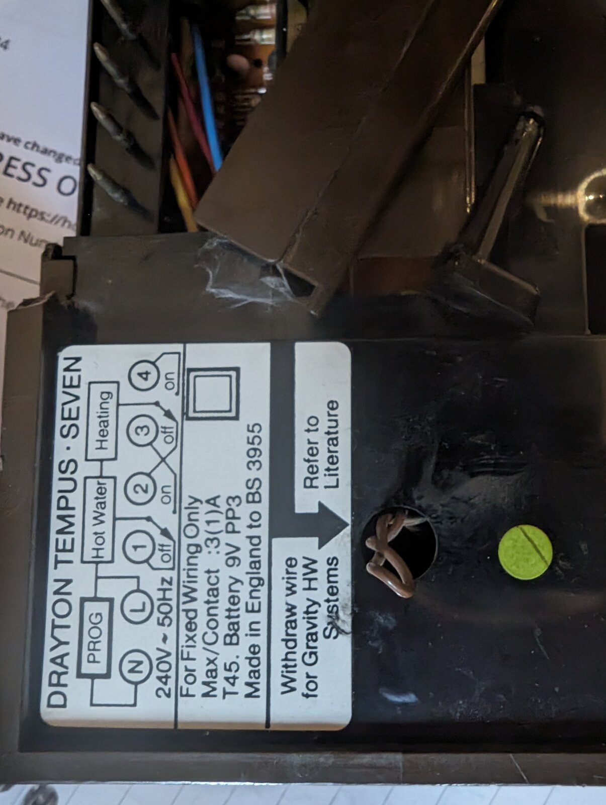

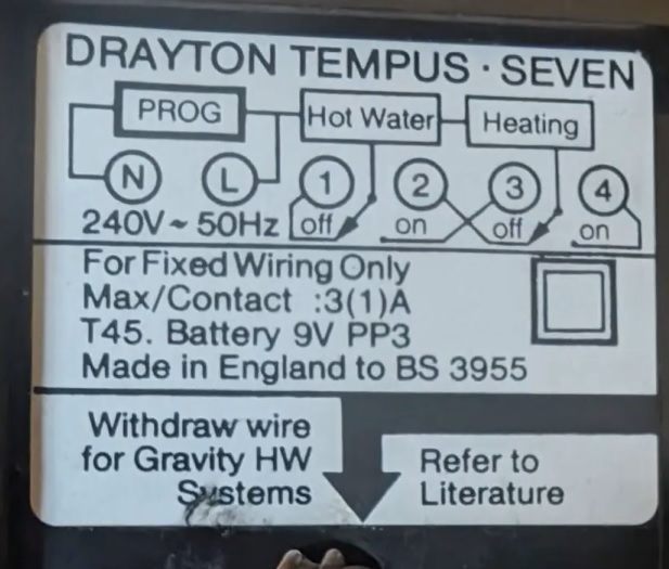

I bought the wiser 2 kit to replace the old programmer, however the old Drayton backplate was very old and too big for the new programmer. I have attached a picture of the old Drayton Tempus wiring diagram and also how it was wired up when i removed the old programmer (images 1 and 2).

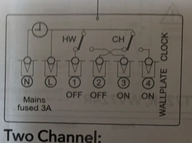

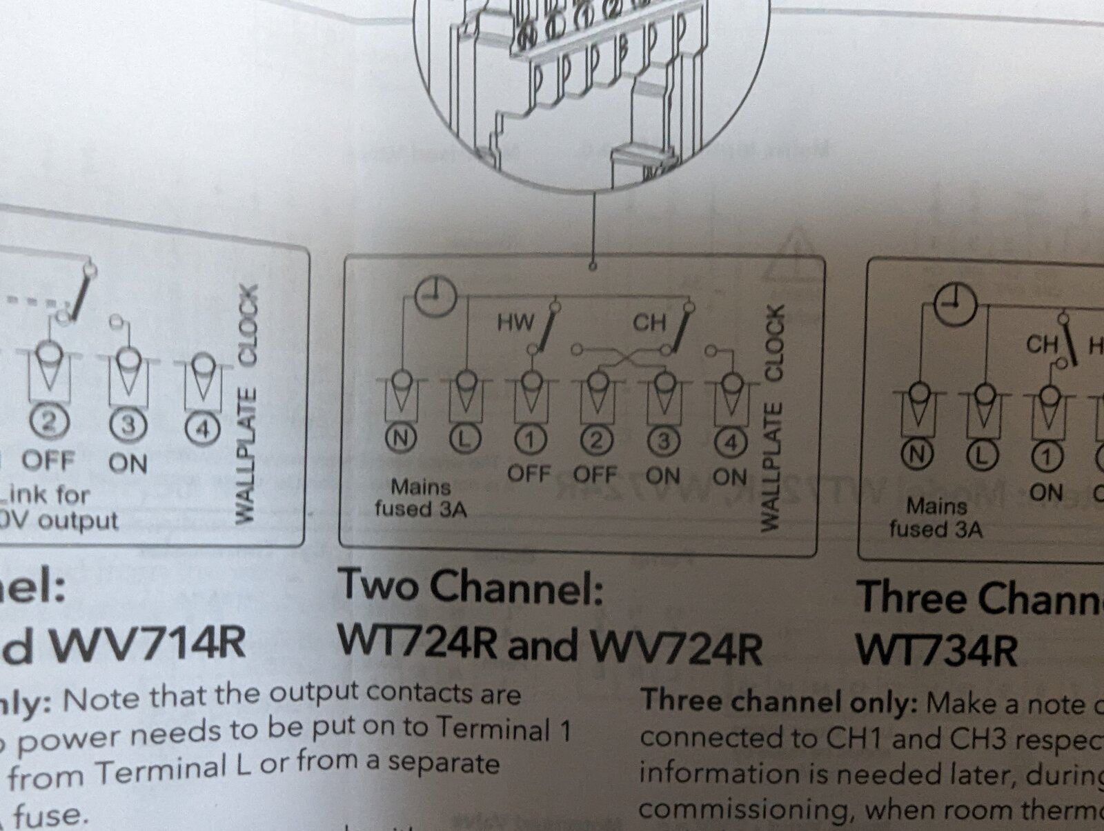

I've also put a picture of the wiring diagram for the new Drayton wiser 2 (image 3).
I first tried wiring up to exact same terminals as was on the old backplate. I get power to the new programmer, can connect to the app and wireless thermostat. Old wired thermostat has been put to max so always on. New wireless thermostat sends the fire up signal to the new programmer but no CH comes on, no boiler fire up. Also tried the manual override and again no CH firing up.
I've since checked wiring diagram for the new programmer and two terminals appear to be switched compared to the old (terminals 2 and 3). Should I be switching these wires around (terminal 2 was empty before)? Anything else I could be doing wrong/should try?

Wiring seems the same, although what's weird is the earth/CPC has been used as a live, but sleeved green indicating earth/cpc, and should be changed really. However, can you post a photo of the wiring you've done for the wiser?
As you can see, the two units have identical terminal locations as per your photos. So, the wires should be moved from the Drayton to the Wiser terminal for terminal like for like, and any empty terminals would remain empty.

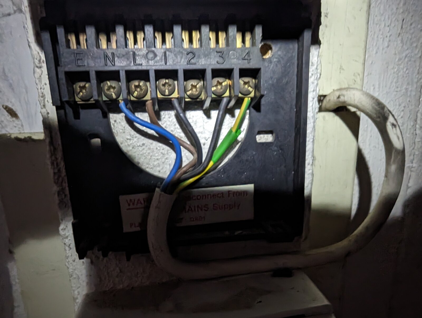

Thanks for quick replies, wired up exactly the same as previous backplate (see attached). The new wiser programmer says the heating is on but it doesn't fire up the boiler. We've got a main multipoint boiler and a baxi, the hot water seems to come on, on demand even when programmer is not in the wall, so maybe its wires don't matter?

Is the Baxi just for the radiators? Or does it have a hot water cylinder connected to it as well? The wiring in your diagrams suggests that it does (or has at some point in the past). Under normal circumstances a system that is wired as yours is has a hot water cylinder that is heated when terminal 3 is made live and the radiators come on when terminal 4 is made live.

If you temporarily link the yellow/green (C/H switched live 4), to Live, does the boiler fire up?

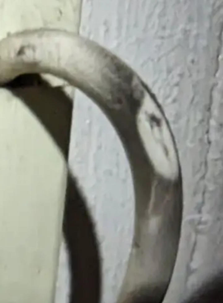

...and is this just a mark, or damage to the cable?
If I put the central heating wire into the live terminal, boiler also doesn't fire up. I think the programmer is wired up correctly though as, when the power is on (either in live or terminal4), if I put the old wired thermostat up to the max, I can hear the pump upstairs kick and in and start whirring. I'm no expert but tells me the correct signal is going from the thermomstat so programmer must be OK....the issue is somewhere between the thermostat and the boiler (or the boiler itself)....thoughts?
I'm no expert but tells me the correct signal is going from the thermostat so programmer must be OK....the issue is somewhere between the thermostat and the boiler (or the boiler itself)....thoughts?
That all depends...... With some old systems usually pre 1980's, the HW channel of the programmer controls the boiler, and the thermostat just the pump. However, with more recent systems [e.g. S-Plan & Y-Plan] the thermostat only opens a motorised valve, and it's the motorised valve that operates the boiler.
The older systems don't require a wire in terminal 1 (HW Off) so the presence of a wire in that terminal would indicate that you have a 3 port motorised valve [Y-Plan] in which case the three port valve will start the boiler when central heating is required, and the hot water cylinder thermostat when hot water is required.
From your before and after photos it does appear that the wires are still in the same places. So, from an electrical point of view you have swapped one product with an identical product. Nothing else should have changed. :unsure:
I'm still a bit puzzled by the green / yellow wire mentioned earlier by @CBW. it's odd that it also has green tape on, unless it's been put there to cover damage. Normally where a green/yellow wire is used as a live (which is not ideal btw) it has a brown sleeve on, but if it was in terminal 4 before when the system was working, that's where it needs to remain.
