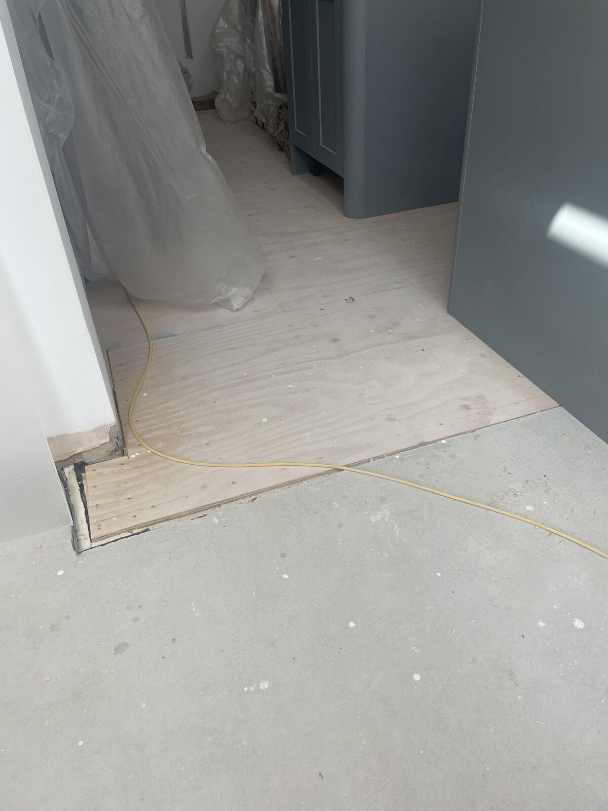

Hi All,
I've seen some pretty similar posts to this on the forum, but not quite the same.
I've used a bit of self leveller in my time... literally 1 bag to fill a bit of a hole - So limited experience of it.

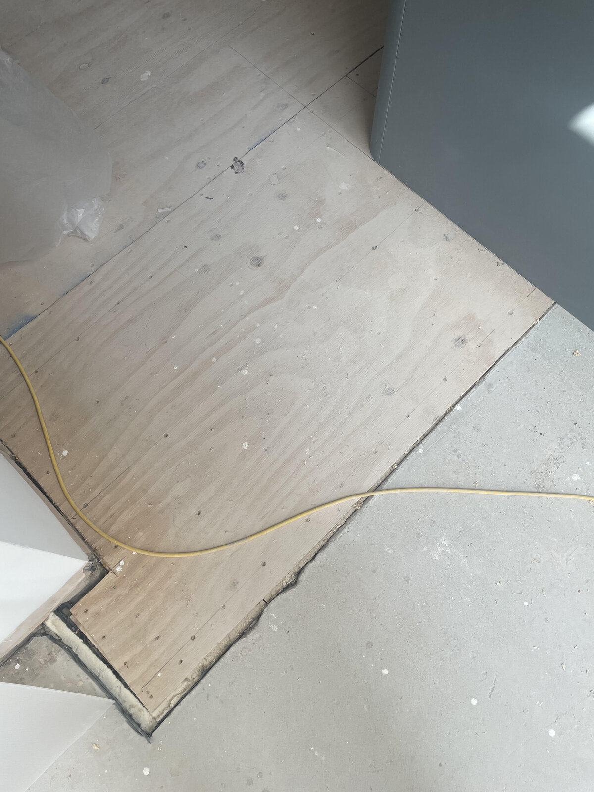

Where our extension meets the existing floor i.e. screed meets 12mm ply (over floor boards and joists) - there's a slight gap increasing towards the "corner" of the ply. The ply and screed are pretty level but the ply does ramps up towards the "corner" by approx. 5mm.
I was also thinking of gouging out a bit more of the perimeter insulation to flood with something, thick set self leveller or something?
I'll be laying LVT planks so need a reasonably tidy finish - what would you guys recommend? Self levelling compoung/Ardex feather finish?
All ideas welcome! Cheers,
You want some ardex a45 rapid and some mesh mate to bridge the ply and screed. Then prime and a full coat of a fibre compound like ardex k40HB
Hi Daz,
Thanks a lot for the response.
Do you think it’s necessary to coat the whole for LVT click planks (not glue down).
Cheers,
Sorry mate. Thought it was glue down.
I’d just use a45 in the joint and sand it flat in that case
