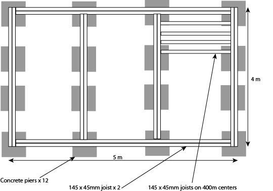

Floor loading question
10 Jun 2009
31
Essex
I have a new built shed which I plan to use as a workshop and am looking to buy some new woodworking tools ;-) ..however some will be quite heavy - ~160kg or so on a base of 460 x 710mm. Question is this - my base is concrete piers with wood joists as per the picture below. Will this be sufficient to take these type of floor loading, or will it all get a bit springy?
Cheers
