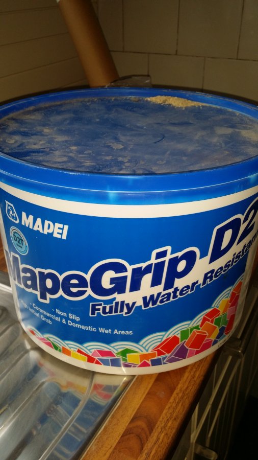

Hi
I'm in the process of deciding Wetherby to tile or lino my bathroom floor and need some help in deciding.
Currently I have 22mm tongue and groove floor boards screwdriver into the joist.
Each board is about 100mm wide I think.
Do I still need to ply board the area and if so what size thickness would be sufficient.
The tiled area would be approx 2 by 2.5 meters.
Also would this adhesive be OK to use?

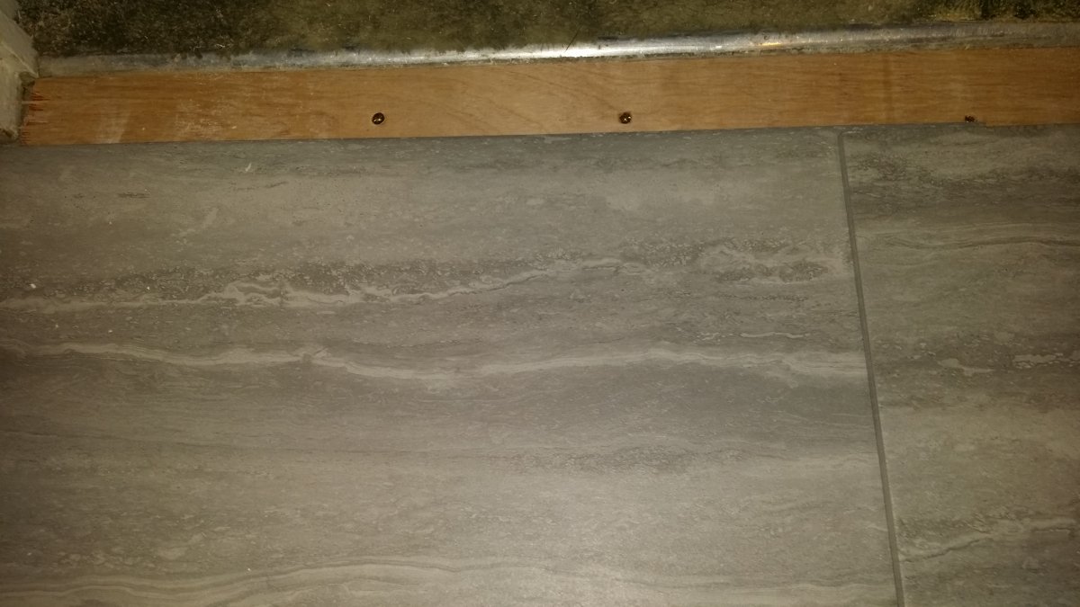

Hi
I'm setting out the tiles and have a question regarding a small pieces just by the door.
Will it be ok to tile this in with a narrow cut just by the door entry or should I pull all the tiles in and make a cut in a full piece and cut the others along the wall down too?
Make sure all the existing boards are well screwed down, now just lay some 6 - 9 mm ply down, and remember to glue it down don't just rely on nails or staples.
a nice coat of unibond and you're ready for tiling. make sure that you use flexi tile adhesive for wood flooring. good luck
