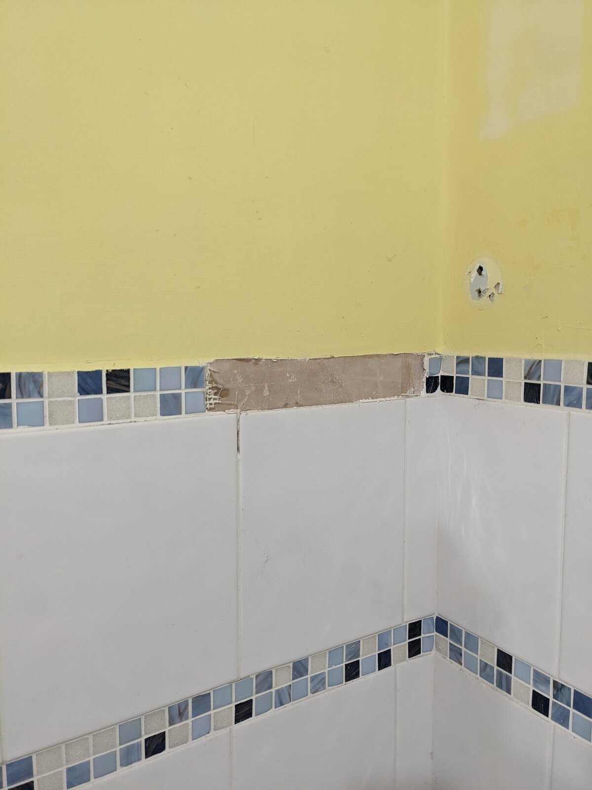

That's really helpful thank you. Ad for the walls, I've just taken off a couple of the tiles to see what's behind and it looks so far to just be plaster and in ok condition. If I smooth it down, will it be ok to tile directly onto or does it need some prep work too?

If the wall plaster is solid plaster then after removing the tile - & belt sanding & priming you can tile on it.
But if you have plasterboard on any wet walls then remove them & use the above Hardi boards.
I use white plastic tile trim for most jobs - no raw or exposed edges.
The mosaics that you've taken off will always look that clean and give you a false sense of "easyness". Take off some more of those larger white ceramics before assessing the state of the wall. Also, if that paint is proper waterproof bathroom paint, and you're tiling above it, then it needs to come off, or at least be sanded and primed as Ree posts above.
Personally, I would take the whole wall off, especially if the intended new tiles are a small size like those originals, as you'll never get them to look flat if you're covering holes.
Different kettle of fish if you're using 300 x 600 or above Porcelain tiles.
Unfortunately it's painted wallpaper so will be taking it off to see what else is happening behind. I've managed to get the bigger tiles off which seem ok but it's just a small segment of the wall so need to see what the rest of the room is doing.
What would you recommend priming with?
