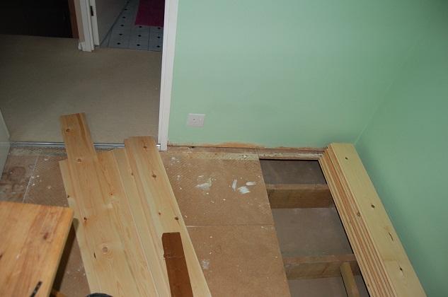

I intend to reboard a 3 X 2m room by replacing the old warped 18mm T&G chipboards with decent 20mm T&G softwood boards.
One of the sides of the room has its chipboard running under a partition wall.

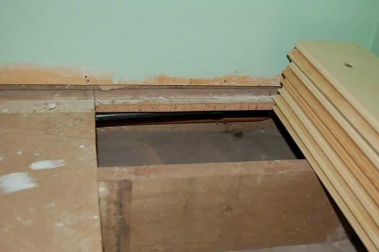

While cutting this board as close as I could to the wall I noticed that there was no joist under the wall (the cut line is 220mm away from the nearest joist which are all 450mm apart).
As this is precisely where the edge of my softwood boards will be resting I'm wondering if, in order to support the edge of the future board I should:
a) install some noggins between the joists on either side of the partition wall.
b) install a small joists (one side fixed with a joist hanger onto the masonry and the other, going to the other side of the room 2m away, supported by a noggin)
c) Not bother
d) None of the first 3
Any advice would be very much appreciated!
Cheers,
Chris
