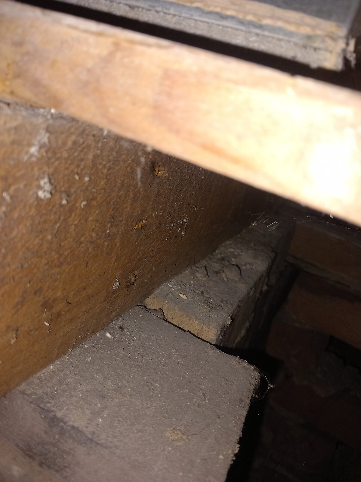

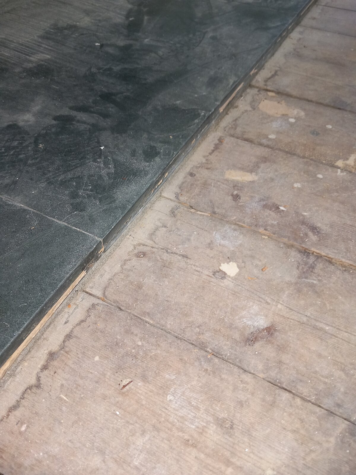

I'm currently in the process of putting in under-floor insulation and have pulled up a number of the original floor boards to open up the space. There are two areas which are proving to be tricky.
The first is where the boards meet the fireplace hearth. When I try and lift the board, I can see the hearth starting to lift......so my question is, could the hearth sit on top of the floorboards? I've tried to look underneath but it's not clear. The two pictures may help.

Can't help you with the hall/door threshold, but it looks like your hearth has been tiled. That probably means that the tiles have been laid on the original constructional hearth which will be smaller than that required by modern standards. There's a good chance that the hearth will have been laid larger than the original, so yes the tiles probably overlap the floor boards.

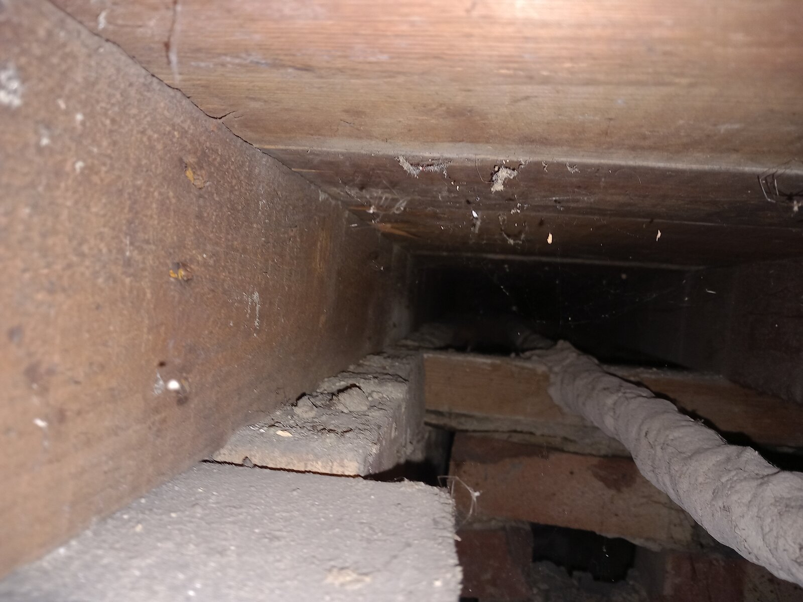

Thanks Lower.....I read your response and looked again and I think you are right.
If I look from the side, I can see that the hearth tiles stick out past the joist......if I then look at the original picture, it seems like the boards go up to the joists (at least)......so I can see there's 10cm of boards under the hearth tiles, if not more.
I've bought a tool to cut the boards now. Thanks for your help.
