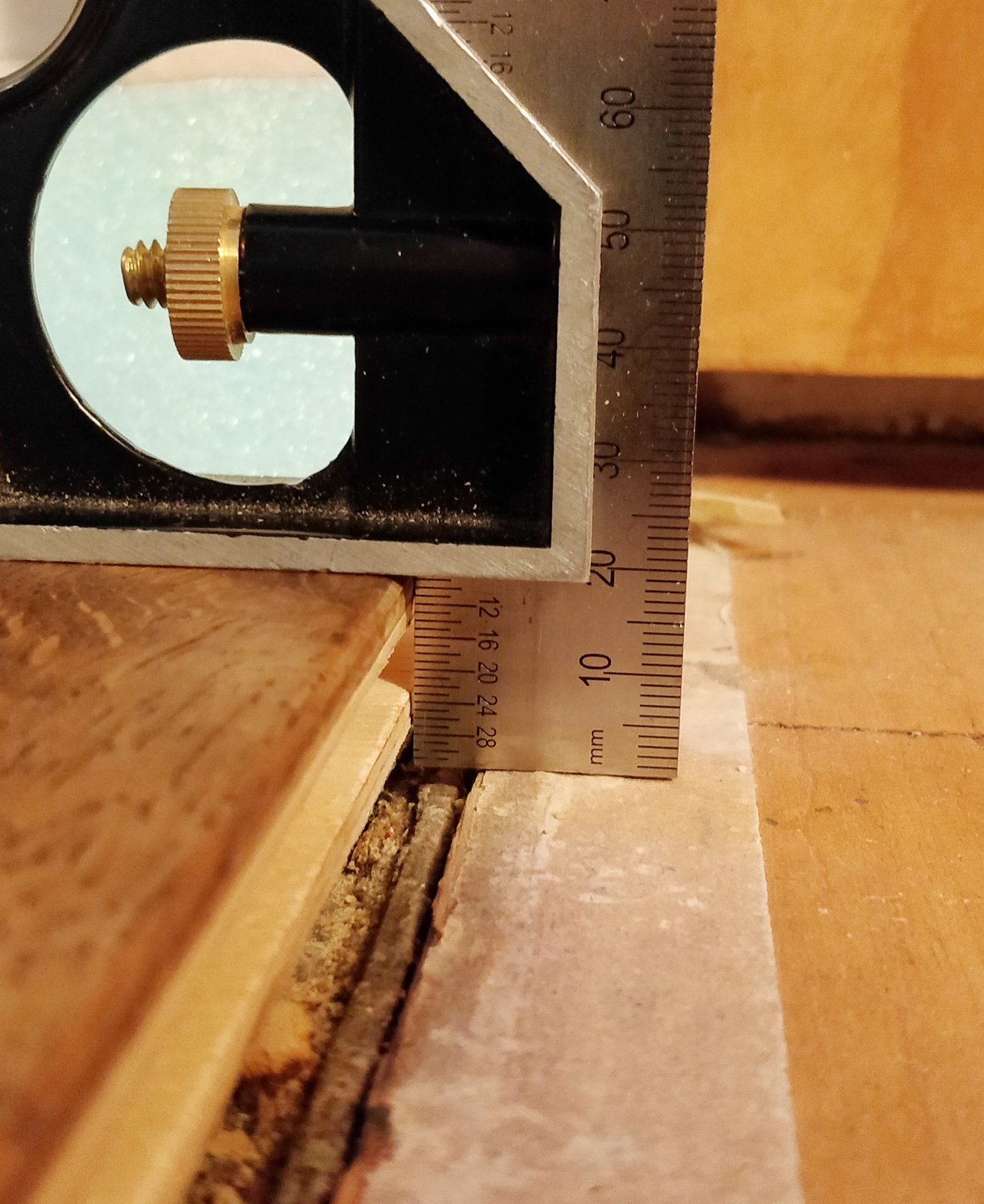

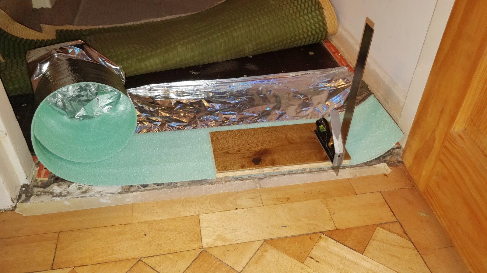

I am planning on doing the hallway floor with engineered wood. we have some samples, and realised that the transition into the lounge (which is parquet flooring) could be up to 20mm.
Any suggestions or good ideas on what could bridge a big gap with out it becoming a 'step' or an annoying trip hazzard?

But in the end I used a wide threshold, 50mm wide and it worked. It was relatively steepish, but not too much overall.
