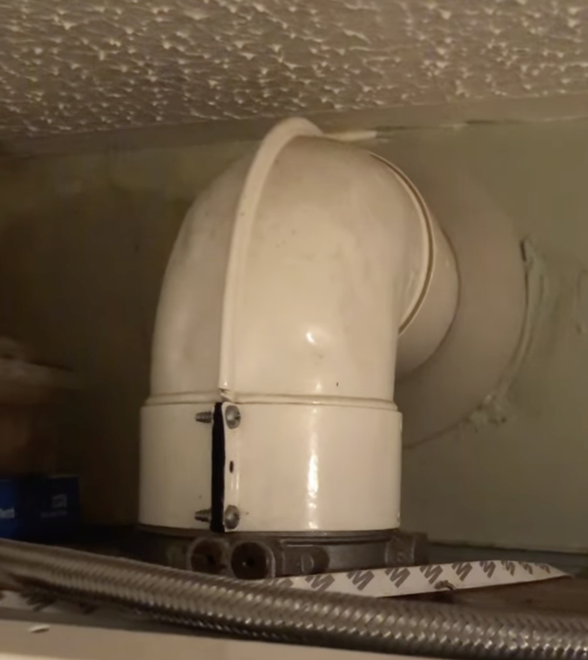

Hello All.
My Ariston A23 Combi boiler has started to make a rattling sound coming from the flue and it's fan.
It doesn't happen all the time but just very annoying when it does.
Is this a simple fix of removing the flue 90˚ pipe and cleaning it out please or is it something more serious please?
I've tried to attach a short video, but an image only available.
It is very likely that a noisy fan will need to be replaced with a new one.
Some firms do recondition fans although the quality of their work varies very widely.
One of the best firms was sold about a year ago and I do not know if the purchaser is doing a good job or not.
