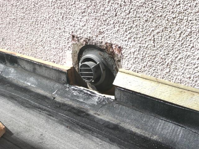

morning all, I'd welcome advice on this little problem......
[/img]
I'm constructing a new flat roof that abuts my neighbours property - all above board, planning permission, building regs etc etc. Problem is that my neighbours flue is very close to the new roof surface, see pic above. We knew it would be close before we started the job, but since the building inspector wanted upstand ventilation the whole deck is now sitting on battens which has made the problem worse.
My neighbour is happy for me do to whatever I need to do as long as it's gas checked etc. What I'm thinking of doing is adding an elbow + vertical straight section to his flue, then encapsulate the elbow/ base of flue in sand/cement using a bit of shuttering to create a box. I'd put a slope on the top of the box and then flash with lead. I might make a lead cap that completely covers the top of the sand/cement box. What do you think? Any better ideas gratefully received! If I do what I'm planning to do should I do the sand/cement before the roof is finished? (what you see in the picture is just the first layer of felt, roofer is back to finish the job in a week or so)

You have a problem here! You cannot stick an elbow on the flue and raise it verticaly. Non condensing flues should fall away from the boiler always. This ensures any rain or condensation forming in the flue falls out the end and not onto the heat exchanger. THIS IS THE OPPOSITE FOR A CONDENSING MODEL.
You cant raise upwards inside and then out for reasons explained above and this boiler has only rear or side exit options for the flue.
You may if space permits raise the boiler maintaining the rear flue exit option, however, will need to comply with boiler clearances etc. the flue will need to clear 300mm min from the roof surface to the bottom of the flue, remember flue surface means any upstands.
When this boiler was fitted there were no specific guidelines in place with regards to flues exiting over boundaries, this only came about around 2005 when condensing boilers and pluming problems became apparent.
It is NOT retrospective and no neighbour would be able to force another to move it FACT!
Only option is to:
Raise boiler or
drop roof or
buy your neighbour a new boiler.
