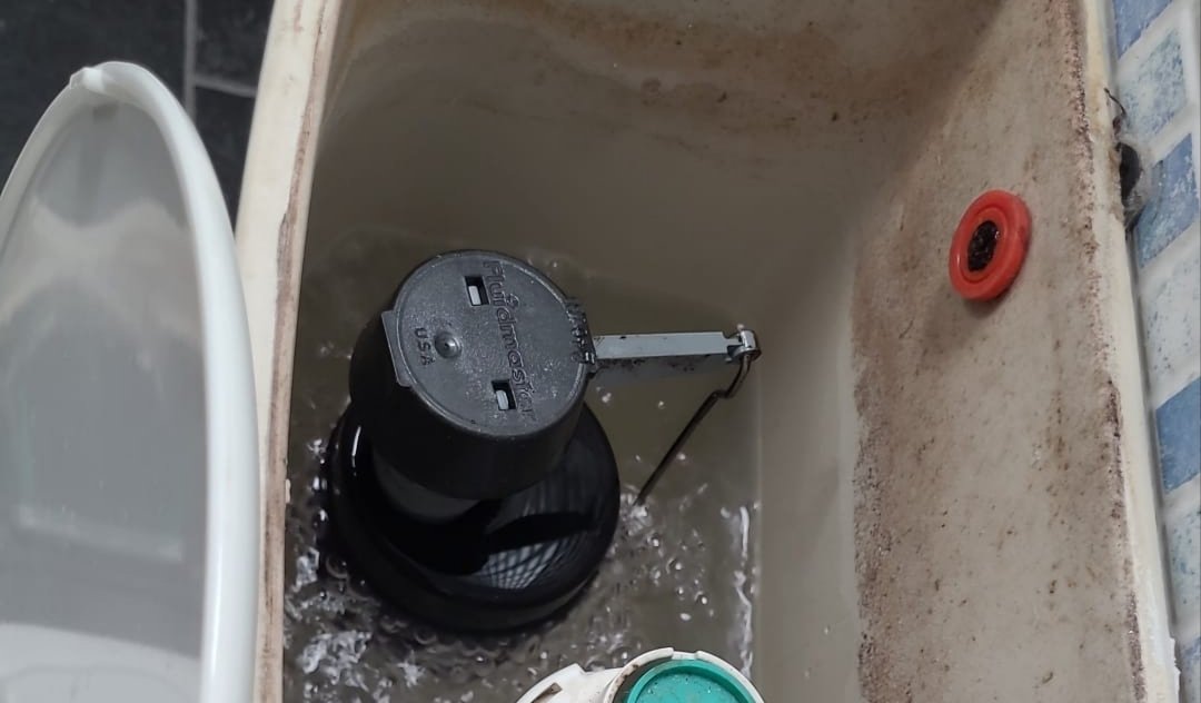

Fluidmaster fill valve
16 Jul 2009
1,208
17
Hull
How do you re-washer this do I need to remove the metal rod to remove the plastic cover?
That's the syphon not the fill valve.
Is the toilet not flushing?
It's also not one I recognise.
Every time I changed a washer or seal on fill valves and syphon, it leaked.
I now just change the whole assembly; only a few quid and works first time.
I do not buy Fluidmaster fill valves anymore after I had a couple of them failing very early.
I have.
The fill valve is white with green top in picture.
The syphon is black.
You saying that green top unit is the syphon?
Yes...
The syphon is the flush/dump valve.
The fill valve is the black one with the float arm ;)
