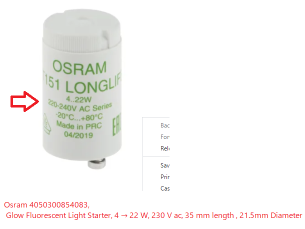

I should be grateful if you or anyone else can tell me the meaning/purpose of the large code-number that shows on these starters. For example, the one that I fitted yesterday (which was the correct one, because it locks in and it works) shows the code P6SU. When I looked on eBay (just to get a clearer picture, in case I need to buy more), the code number shown on most of these is FS U. I would be concerned about buying in ignorance, and buying the wrong type.
L.L.
That is clearly wrongly marked. It is a series type for 2 up to 20w tubes in series
Yes it is a starter for a two tube lamp where the lamps share one ballast, my error in choosing that as an example of a starter with a voltage rating on the label.
This is the RS page for the starter LINK
This is the RS data sheet DATA
The data sheet shows that each tube has its own starter
This is a starter for a lamp with single tube
image from HERE
I still maintain marking it as 220/240v is misleading. I use such starters in my jukebox which uses one 20w and several 8w tubes singly on a 115v supply from an auto transformer for the whole juke box.

FSU means Fluorescent Starter Universal, though why its called that i dont know as it only does some not all, single tubes, usually 4watt to 65watt mainly.
All are physically same connection, though as you found some cases vary shape, why some are tight, who knows.
The codes can be a bit of a minefield, never seen P6 before, its likely a personal manufacturers code.
Best thing is to say what tube you have or post a picture of the writing on the end.
The main 2 starters you are likely to ever need are,
FSU 4-65 watt these will do 2ft 20watt,4ft 36watt and 5ft 58watt, single tubes amongst less popular other sizes.
Fs125 will mainly do 6ft 70watt single tube but ensure it has 70w stamped on it, 6ft is a temperamental size, one marked 75w 6ft is not the same as one specifically marked 70w 6ft.
As a guide ensure the **W printed on the tube is also printed on the starter., ie 58W is within the range of a 4-65w starter, its as simple as that.
Uk starters should all be the correct voltage you need 220-240 volt, the only series starters with different voltages stamped on them will likely state 4-22 watts on them and its unlikely your tubes are within that wattage range anyway.
These are mainly in 4 tube commercial lights, where as Winston implies they series two lamps together.
