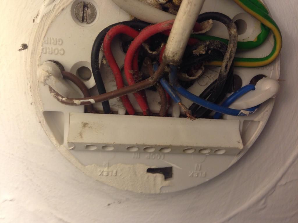

Clearing out the loft today and I caught my foot on our TV aerial booster located in the loft, powered from the landing light, anyway seems one of the cables has come out (see pic) blue and brown seem to be coming from the TV booster, can anyone make out where the blue should be from the pic??
Any help would be greatly appreciated
Into any of the first three terminals on the right, where ever it'll fit.
You need to turn the power off at your fuse box before attempting this, as the ceiling rose will always be live even if it isn't lit up.
Thank you, that's where I assumed it would go but just wanted someone to confirm.... I'll defo flip the breaker for upstairs lighting before touching it
