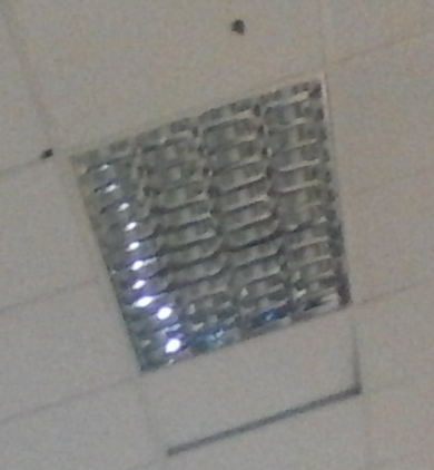

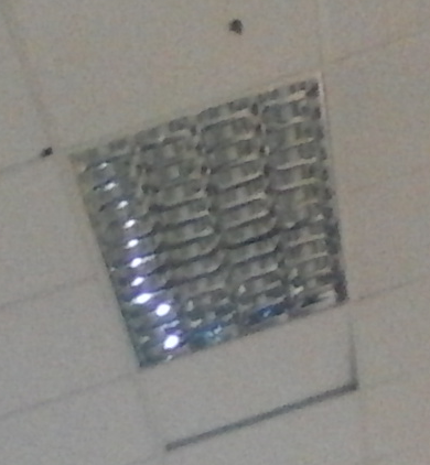

In our local church hall the Fluo fittings, consisting of 2 4ft tubes in a fitting resting in the ceiling grid, have recently been replaced with LED panels.
replacements are much brighter to look at and cool white, however they are 90W vs 72W so 25% increase and some regulars, mostly elderly, are commenting they are not as bright and also complaining of headaches.
Similar to these but 2 tubes

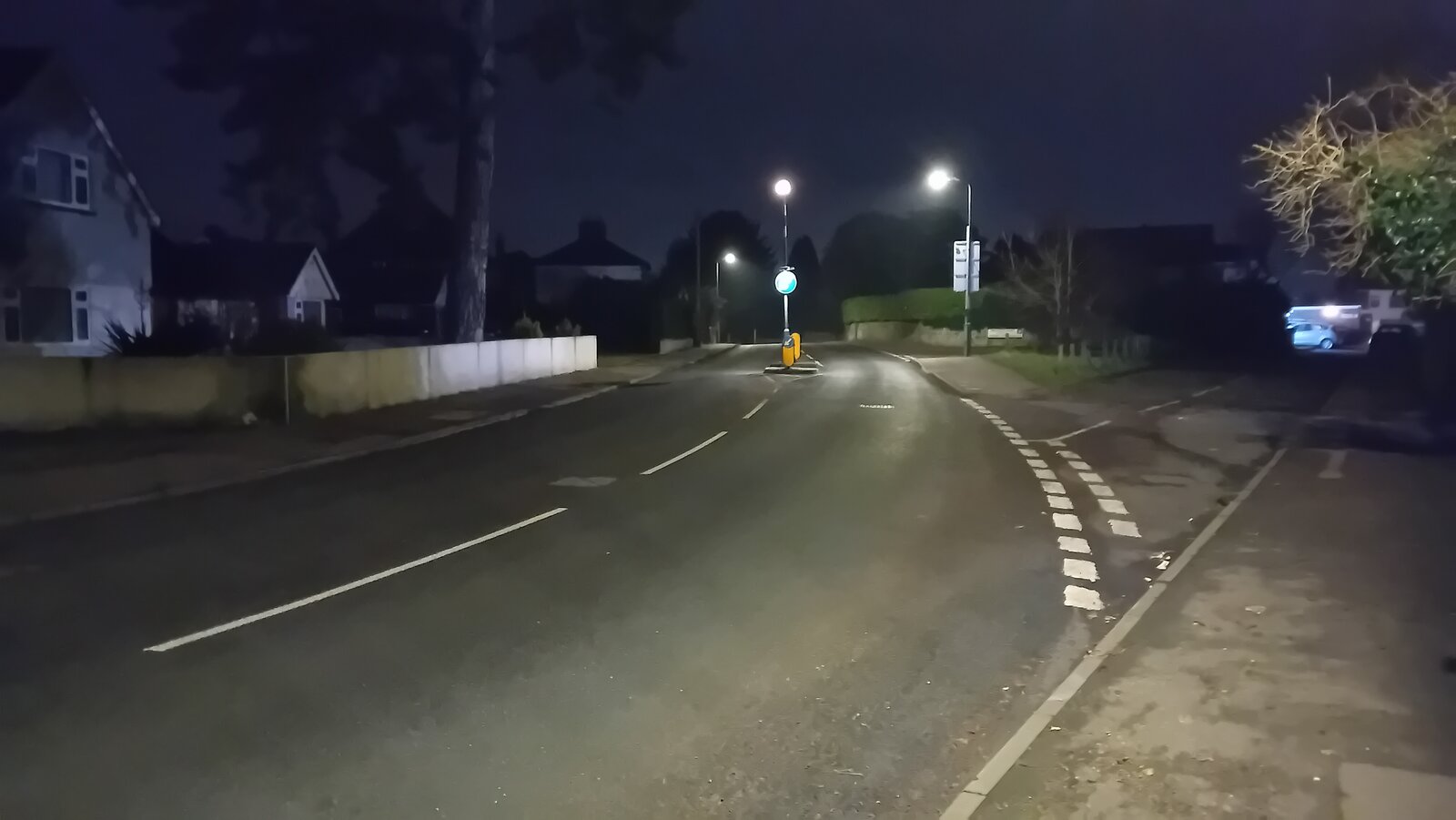

A picture tells a thousand words

oops, my mistake. However that may be a better indication than I intended, the previous post is the road ours is a turning off of; the white wall on the left in the is the corner house, our street is bottom left.

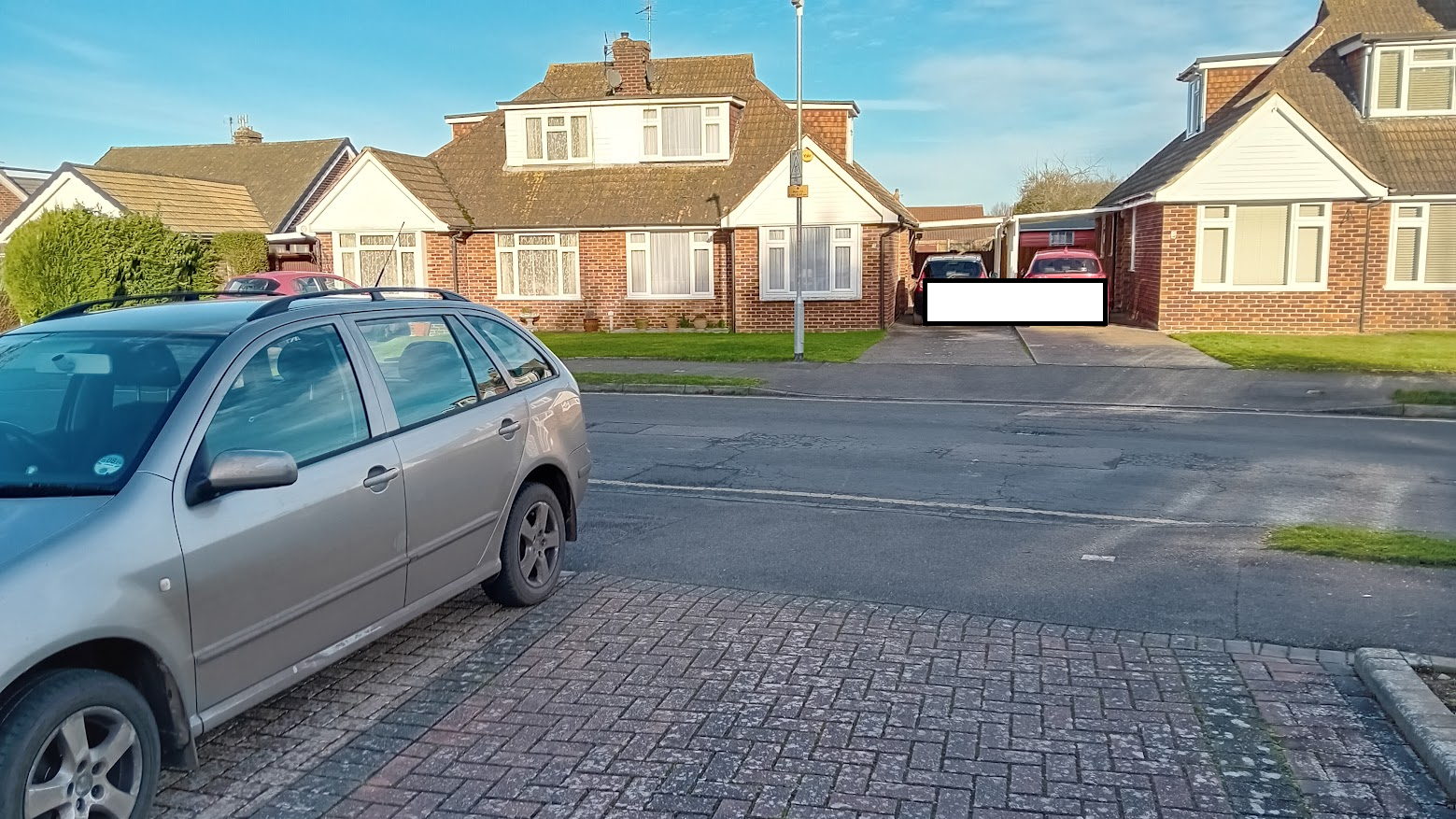

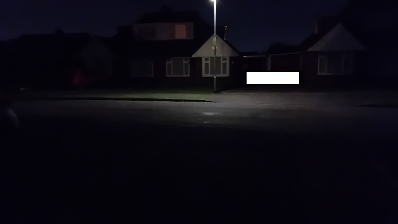

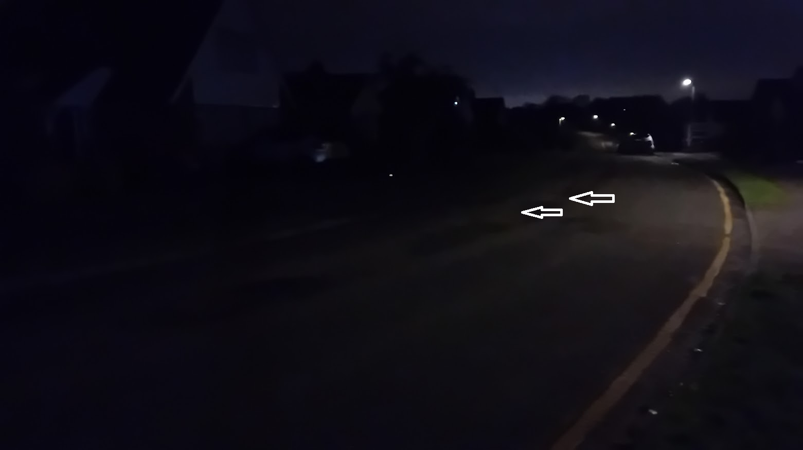

This is looking down our street and the white wall finished a few meters behind this photo.
The 2 white arrows show the dropped kerb to my and neighbours drives.
2 similar views looking towards the light directly across from our drive showing how far sideways the LED lamp standard illuminates and how little light extends onto the road or the opposite pavement, and how little light comes from the standard some 25m to the right.
