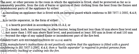

We're looking to install a reclaimed original victorian fireplace with a gas effect burner(fake coals etc.). This will all be done by registered fitters but i wanted to keep a tiled hearth that is flush height with the floorboards to keep that victorian look.
Is this ok under current regs? I cant seem to find a definitive answer anywhere.
Any info greatly appreciated.
British Standard 5871.
Hearth must be at least 12mm thick and have an upstanding edge of 50mm height above finishings.
Or be 50mm thick.
Correct, Dan.
But the 50mm can be acheived with a fender. The "front hearth" neeeds to be 12mm min non-combustible, but this can be underfloor and is likely to be already so - if there was solid fuel fireplace.

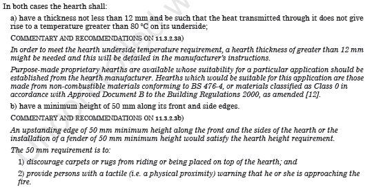

So just to confirm;
The constructional hearth that’s there already is as least 12mm thick so I can lay tiles on to it that will finish flush with the floorboards(or slightly proud). I can then use a fender to achieve the 50mm height to front and sides?
Is that correct?
So just to confirm;
Is that correct?
Yes. Exactly. But remember to maintain the depth (backpanel to perimeter) distance.

The height of the hearth (50mm) is only to "discourage the placing of floorcoverings near the fire", or some words like that. I always thought it strange that Solid Fuel fires have no such requirement
They do - the hearth must extend 225mm in front of the stove
And of top of that, the stove manufacturers often then recommend a minimum distance from the edge of the door when opened which explains why homes with stoves often have huge hearths stretching out 4 ft or so into the room.
