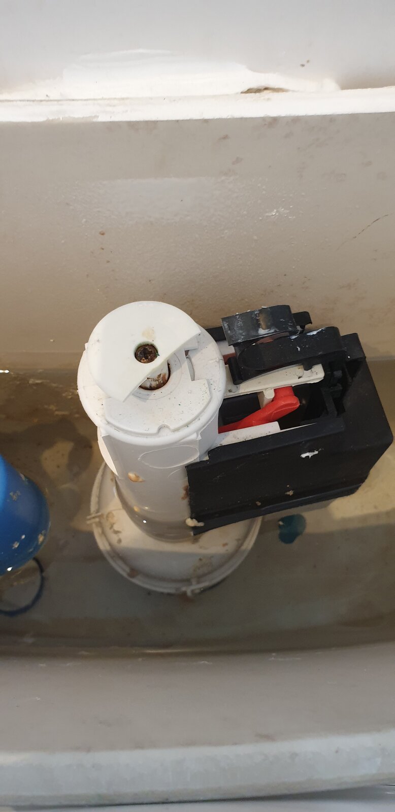

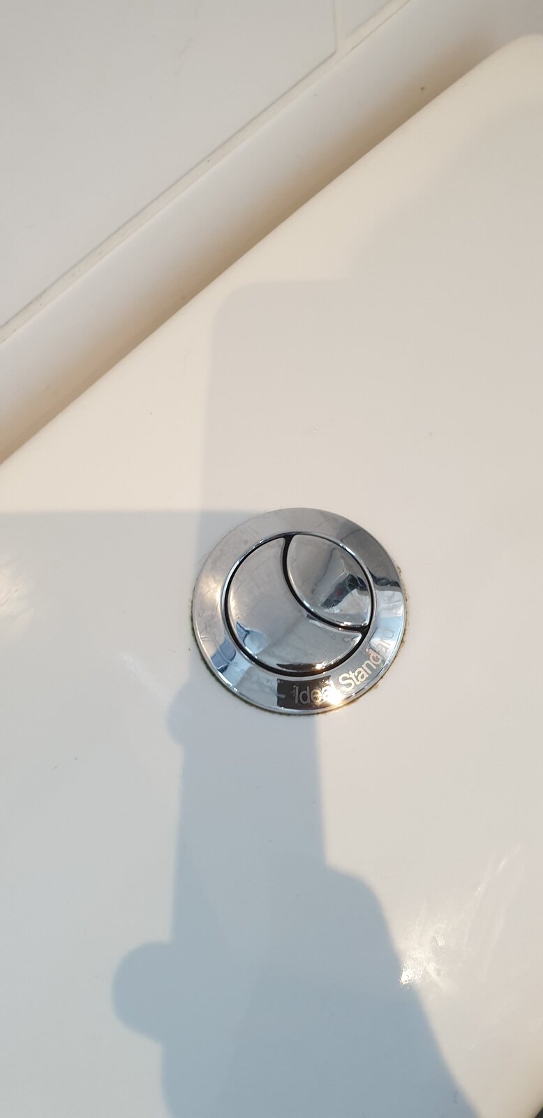

Hi,
My Flush valve button has broken so I can only use the number 2 button when I want to use the flush. Can I get a replacement part for that or do I need to buy the whole flush valve?
Any links for the replacement part please?
I believe it's an Ideal Standard flush valve.

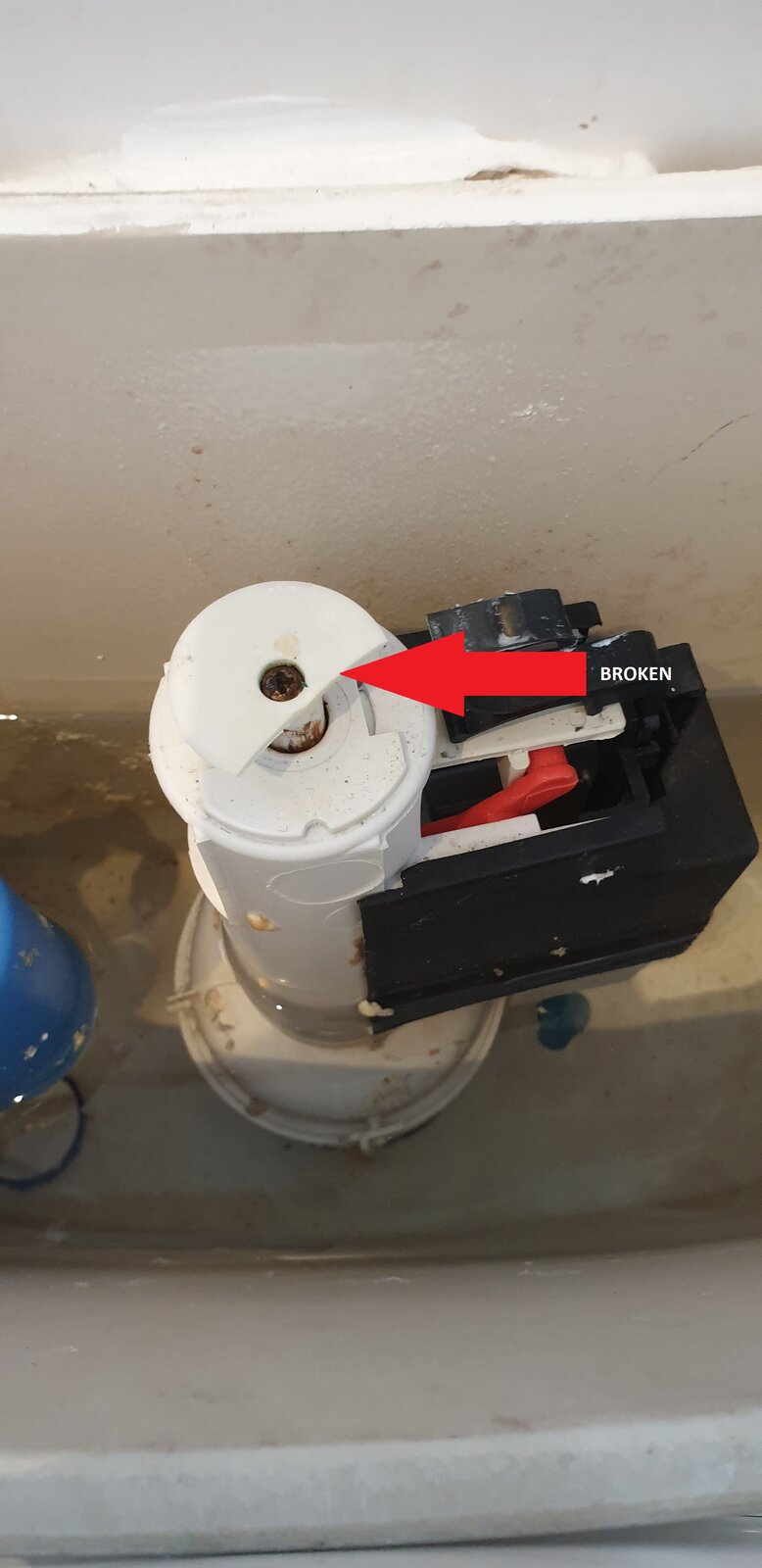

Only the flush button part of the valve/cistern is broken, so I can't use the low flush button (button 2 works fine), other than that everything is working fine.

Ideal sparesToilet spares - might have to be a new valve, but usually undo as bayonet type. Try Ideal spares, or perhaps you could get a stainless steel washer to screw on top of that plastic plate?
Should be able to just replace the button
Wide range of spares available with pictures to help identify what you need.
