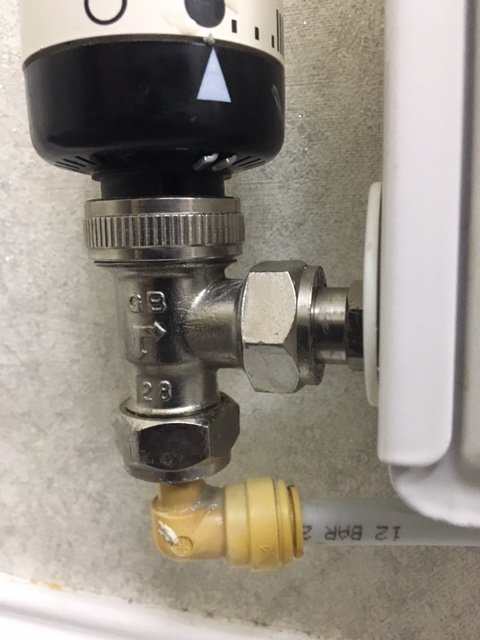

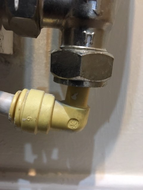

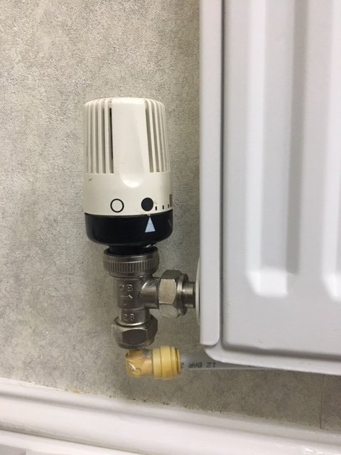

hi Chaps,
update. so thanks for the advice. following your the advice above , i found out the TRV side has a very slow flow unlike the lock shield side. seems to be blocked in the TVR connection/shield. the TVR connection is the flow side and gets very hot but the water comes out very very slow/trickle into the radiator. Looking at the flow from the TRV side, am sure the connector there has to be replaced. the micro plastic pipe is also very hot all the way from wall to the TRV.
please see pictures.
Now the question is how do i replace that whole unit/connector on TRV side . Am not sure how to connect the plastic pipe to the TRV unit. is this something i can do with some advice please? am very confident disconnecting and reconnecting the unit to the radiator itself. just have no idea how to connect the plastic pipe to underneath the TRV. any info/ help will be much appreciated.

Good evening Kofi,
So what you need to do is isolate the cold feed outlet of your feed and expansion tank (usually a bung) and bung the vent pipe, then drain the leg of water in the trv side, and use a blanking plug on the radiator, once the water ceases to flow, then change the 15mm trv, reconnect to rad, unbung the tank, fill and vent, then test.

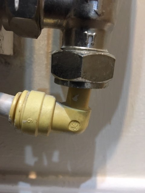

thank you 'The Novice'. i will try this.really appreciate your help. one further question if i may please. how does the 15mm push fit stem(the yellow elbow in picture) actually connect to underneath the nut/valve please? is there a ring in the nut. clearly am a complete beginner:D .

Because it's a stem elbow, it's rigid, and an olive (ring as you're calling it) inside will crimp onto the stem part, so you can just undo the nut ans re-use. It's a bit like a piece of pipe. however the one in that photo looks like it's not full socket.
ah that will be much easier if i can just reuse same nut already sitting on the stem elbow. i will give it a try sometime this week. i will go up to the loft and find and close expansion tank outlet and vent pipe. hopefully not too difficult to do.that will be fun lol. am sure i would have learnt a few things after this. thank you so much. will update.
