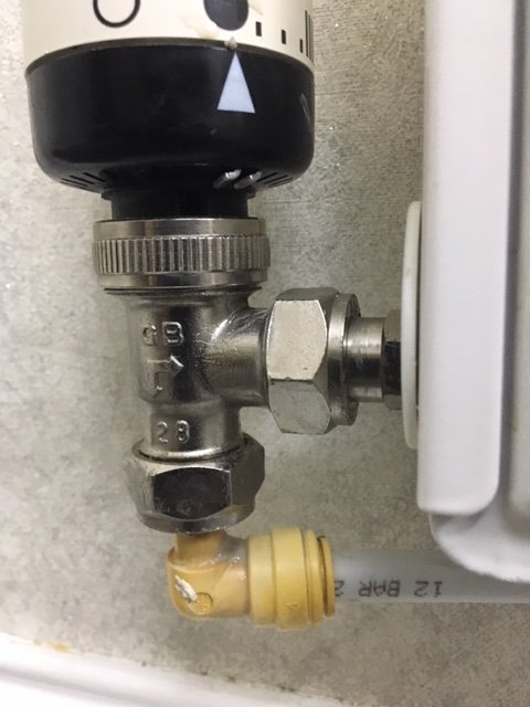

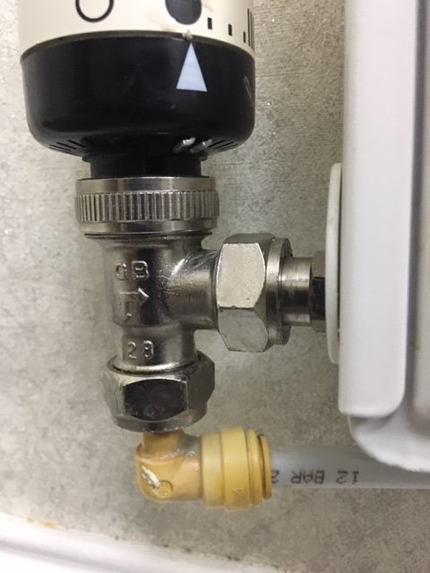

update. so thanks for the advice. following your the advice above , i found out the TRV side has a very slow flow unlike the lock shield side. seems to be blocked in the TVR connection/shield. the TVR connection is the flow side and gets very hot but the water comes out very very slow/trickle into the radiator. Looking at the flow from the TRV side, am sure the connector there has to be replaced. the micro plastic pipe is also very hot all the way from wall to the TRV.
please see pictures.
Now the question is how do i replace that whole unit/connector on TRV side . Am not sure how to connect the plastic pipe to the TRV unit. is this something i can do with some advice please? am very confident disconnecting and reconnecting the unit to the radiator itself. just have no idea how to connect the plastic pipe to underneath the TRV. any info/ help will be much appreciated.
the Pin is not stuck. that has been checked and it moved freely up and down. however radiator is just warm.
It could be the pipework or the TRV. My system with the same symptoms (including the hot microbore pipe up to the TRV) was the pipework. The next step would be to remove the pipe from the TRV and see if water flows well through just the pipe.
Turn the system off. Shut off the TRV valve (this prevents any water from the radiator flowing out after the pipe is disconnected).
Put a cloth down (dirty heating water stains stuff easily), then place a receptacle (ideally a big flat tray) underneath to catch escaping water.
Undo the big silver nut and remove the stem elbow from the TRV. Some water will escape, but only under gravity pressure so it's easily stopped by a finger over the end of the pipe. Perhaps have an assistant handy in case you need to hold like that while they empty your tray.
If there's now a good flow from the stem elbow side then your problem is the TRV. If not then I'm afraid it looks like it's you pipework that's blocked.
(If by this time you're quite confident with how little water is escaping you can turn the heating on and see if the flow gets any better.)

the nut sitting on the stem elbow will unscrew anti clockwise, right? thank you all

Correct. I did consider mentioning the removal of the trv, but thought it was ok as pipe was hot - #latt (learn all the time) :D
I'm latt too mate :) The fact my pipe was hot made no sense to me at the time either, but hey-ho lol. I'm just trying to save the OP some cash swapping out TRVs if they're ok and it's the pipework that's the problem.
Chaps,update- i tested the flow from the pipe as advised and its good. unscrewed it and flow is good. so i thought i will go ahead with although a bit nervous. was going up the loft to close the expansion tank outlet to drain the pipe when i thought to myself, well the flow was good but as advised above, it wasnt too much and i can possibly stop with my finger. hmmm am looking for a shot-cut. i may be able to swap the TRV without draining the pipe. well thats what i did. scary initially with all the water coming out and me trying to screw the TRV back on but i kept saying to myself' dont panic, you idiot':LOL:. and i managed to screw it back on and tighten it. i opened the bleed valve to refill rad and and turned system on. Bingo! its working and very hot.(y) honestly am so proud of myself and happy but all thanks to you guys.

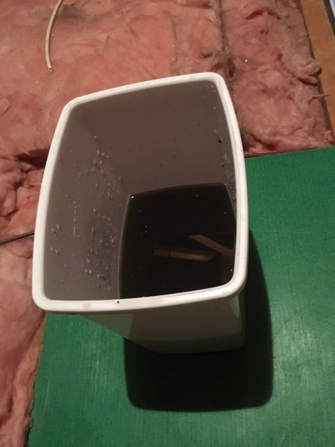

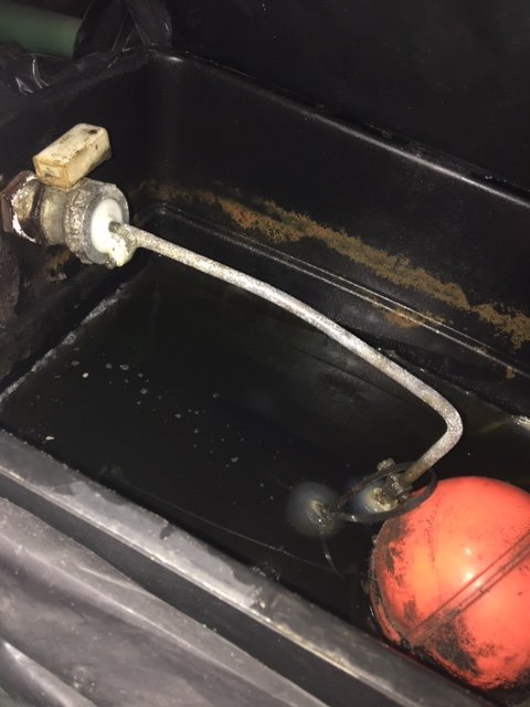

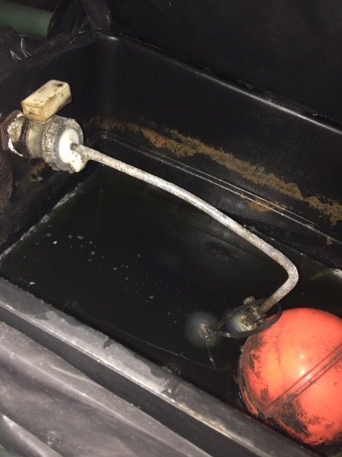

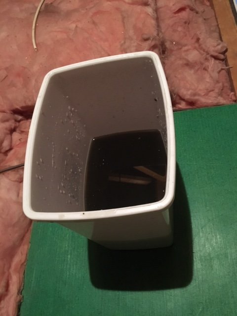

Take a clear glass up to the loft with you, fill it with some water from the tank and look at it. Ideally you want it fairly clear. The tank can build up with sludge, if yours has then it's best to empty it, clean it and refill it. This stops the mucky stuff getting into your system. Just tie up the float valve, bail the tank out into buckets, clean any sediment or sludge out, wipe the tank with bleach, and untie the float valve and let it fill back up.
hi Alan333, thanks for this tip. i went up and cleaned it out. very dirty water i found in there , please see pic. i have emptied, wiped and refilled. i guess the rads will all be filled with this stuff, although all radiators are getting hot as they are supposed to.
when i changed the TRV, i noticed water coming out was a bit dirty though not as dirty as what i found in the tank. thanks so much

Yes it looks quite dirty. Perhaps wait for those with more knowledge than me but I'd say your system would benefit from a flush.
I may probably need to drain the whole system and refill. Lol I will look for some videos on YouTube about draining whole system. Is draining the system and refilling same as flushing the system. I suspect one needs special equipment to flush the system thank you
