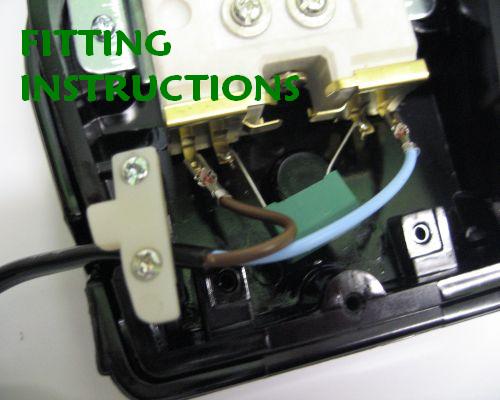

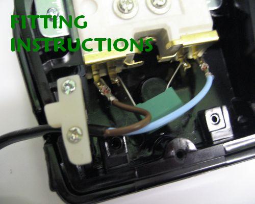

I know this pedal can be used for controlling a Dremmel but I'm stumped how to wire it up.There is no marked input/output just two terminal with positive and neutral, as can be seen in pic.Can anybody help?

It's probably wired like a normal switch. Don't know Dremmel, is this a battery or a mains thing? There is no positive in AC (mains) electricity!
Are you replacing an existing switch, or adding a switch?
My dremmel is wired there is no existing switch.A reviewer said he bought it for a rotary drill but I can't figure it out.
OK
SO it is a mains tool?
The switch has to interrupt the live connection so the brown wire is the live input from the mains plug, and the blue wire will be the switched live that goes off to the tool's live connection.

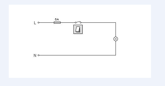

You wire it up like this drawing for a simple light switch. The circle with a cross in it will be your Dremmel.
NOTE that the neutral is NOT switched and is not connected to the switch in any way!

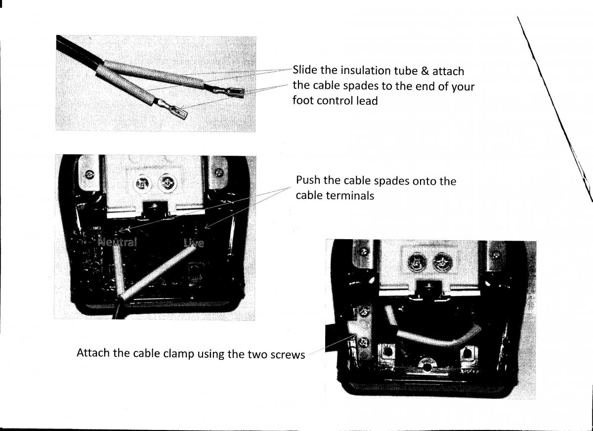

I thought that's how it would be it was just the wiring diagram they supplied showed neutral and live going to the terminals,which threw me a bit.

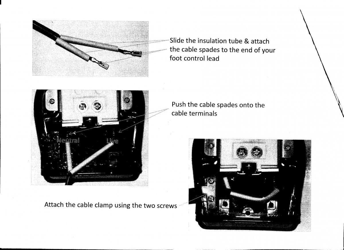

Pic of actual wiring diagram received with pedal , stating neutral and live.
It is wrong. Obviously written by some one with no electrical knowledge.
It is, in any case, the opposite way round to your other picture - not that it matters as they are both Line conductors..
Neutral is the name given to the conductor that completes the circuit from the load back to the supply.
It is not a name for Blue or Black wires.
Wires can be anything we want them to be; they do not know what colour they are.
