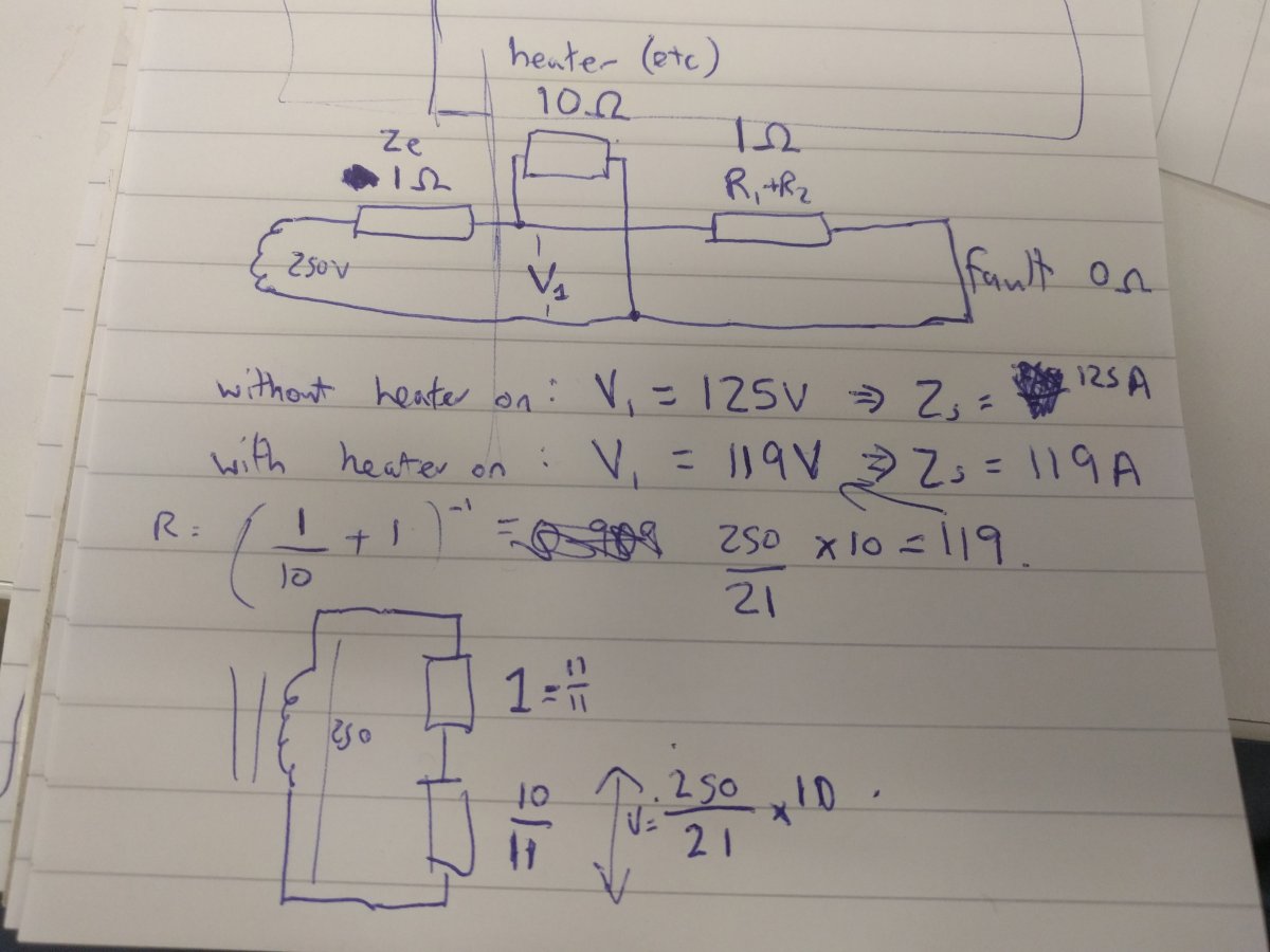

These are all red herrings. ... You are saying allowing for 218.5V is unnecessary because the transformer is always 240V (or whatever) but you may have the shower and oven on when a fault occurs.
I don't think that makes any difference. However, I clearly need to do some thinking, in the hope that I can convince myself that I'm right (or not, as the case may be!). Give me a bit of time and I'll try to look at some numerical examples. Watch this space.
I think you hit the nail on the head, the fault current is reduced when it's split amongst other consumers on the same lv circuit from the substation, including yourself. That split is evident in the volt drop you see at your origin. So if the whole street is having a shower and a roast dinner, your ze will be the same but your pfc will be lower (assume tn/c/s to avoid confusing the matter)
You just can't get the same current through the same zs if the voltage is lower.
My mistake was I thought the pfc was the reciprocal of the ze, but actually there's the voltage in there also.

As I see it one would need to use Norton's theorem to work out the current at the MCB. When the fault happens there will be a greater volt at that consumers premises and less at other peoples premises, so one would have to know the load at every house to work out the fault voltage.
So since we don't have that information it is near impossible to work out.

Assume tn-c for extreme simplicity
This means If you measure your zs with the oven/kettle on and off you'll get different answers. Anyone got a loop impedence tester handy to check?
Assume tn-c for extreme simplicity .... This means If you measure your zs with the oven/kettle on and off you'll get different answers. Anyone got a loop impedence tester handy to check?
OK - watch this space. However, if the answers are different (which I'm inclined to agree they might well be), then what is being measured is surely not "Zs" in the normal sense - an impedance ('loop impedance' or any other) is an impedance, regardless of what currents are flowing.
In other words, true loop impedance (Zs) in your diagram is R1+R2+Ze, which is clearly not dependent on anything else.
Kind Regards, John
Sorry sorry I'm confusing zs and pfc again!o_O
If you measure PFC in both cases it will be differenct. Zs by definition must be corrected for voltage, so should be the same in all cases. But the point is it's your fault current that trips the MCB so the zs isn't quite enough to know it'll trip.
Sorry sorry I'm confusing zs and pfc again!o_O If you measure PFC in both cases it will be differenct. Zs by definition must be corrected for voltage, so should be the same in all cases. But the point is it's your fault current that trips the MCB so the zs isn't quite enough to know it'll trip.
Yes, my tests indicate that my meter is measuring true (unchanging) Zs:
No load. V=248.6V. Zs = 0.68Ω. Calculated PFC = 365.6A.
2kw fan heater. V=247.4V. Zs = 0.68Ω. Calculated PFC = 363.8A
2 x 2kw fan heaters. V = 246.2V. Zs = 0.68Ω. Calculated PFC = 362.1A
[all of the following again assuming TN-C-S for simplicity]As I've said before, one problem which arises is that, during the duration of a negligible impedance fault, my 'supply voltage' will fall to a very low level. My current Ze is about 0.32Ω. With the Zs of 0.68Ω, that means that R1+R2 is about 0.36Ω. That means that with a negligle impedance fault, and assuming a no-load voltage of 248.6V, the 'supply voltage' (across R1+R2, and the fault) should fall to about 131.6V, giving a calculated PFC of 193.5A - albeit still enough to magnetically trip a B32. However, if the Ze was just a bit higher, it would not be enough toguarantee magnetic tripping the B32, even though the Zs was well below the specified maximum for a B32. For example, if the Ze were, say, 0.5Ω, making Zs 0.86Ω (still well 'within limits'), the during-fault voltage ought to be about 104V, leading to a calculated PFC of about 121A - far too low to guarantee a magnetic trip of a B32.
Given the answers that the meter gives, I can but presume that it uses the 'before fault' (not 'during fault') voltage to calculate PFC. However, as above, as far as I can make out, the actual current during a fault would be much lower than that figure (quite possibly too low for a guaranteed magnetic trip), since the voltage would be so much lower. Yet again, I suspect I'm missing something, or making some silly error!
Kind Regards, John
yes it would be the voltage before the fault to give the PFC in that situation, as you're trying to ignore the effect of the meter on the circuit.
However this whole debate is admittedly about what voltage we should use in the equation - and it's been decreed to use 0.95 of nominal effectively, for the purposes of checking breakers will open.

... one 'silly error' detected, I think. In fact, I wasn't paying attention to what I wrote at the start of this thread!
As I wrote back then, the current through the fault (and through R1+R2 and MCB) can be determined by dividing the ('during fault') 'supply voltage' by the R1+R2 (not Zs, which is what I used above). Hence, in the above example, a during-fault supply voltage of 104V across an R1+R2 of 0.36Ω would result in a current (through the fault circuit, including the MCB) of 288A, plenty to trip the MCB - but, of course, in practice one does not know (without measuring R1+R2 separately) what that 'during fault supply voltage' will be.
Going back to where this discussion started, if one makes a wild guess that the transformer output voltage is about 250V, then (as I anticipated) one gets almost the same PFC as above (actually 290.7A) if one divides the voltage at the transformer by the total Zs. Hence, at least for this example:
PFC = transformer voltage / Zs = supply voltage (during fault) / (R1+R2)
