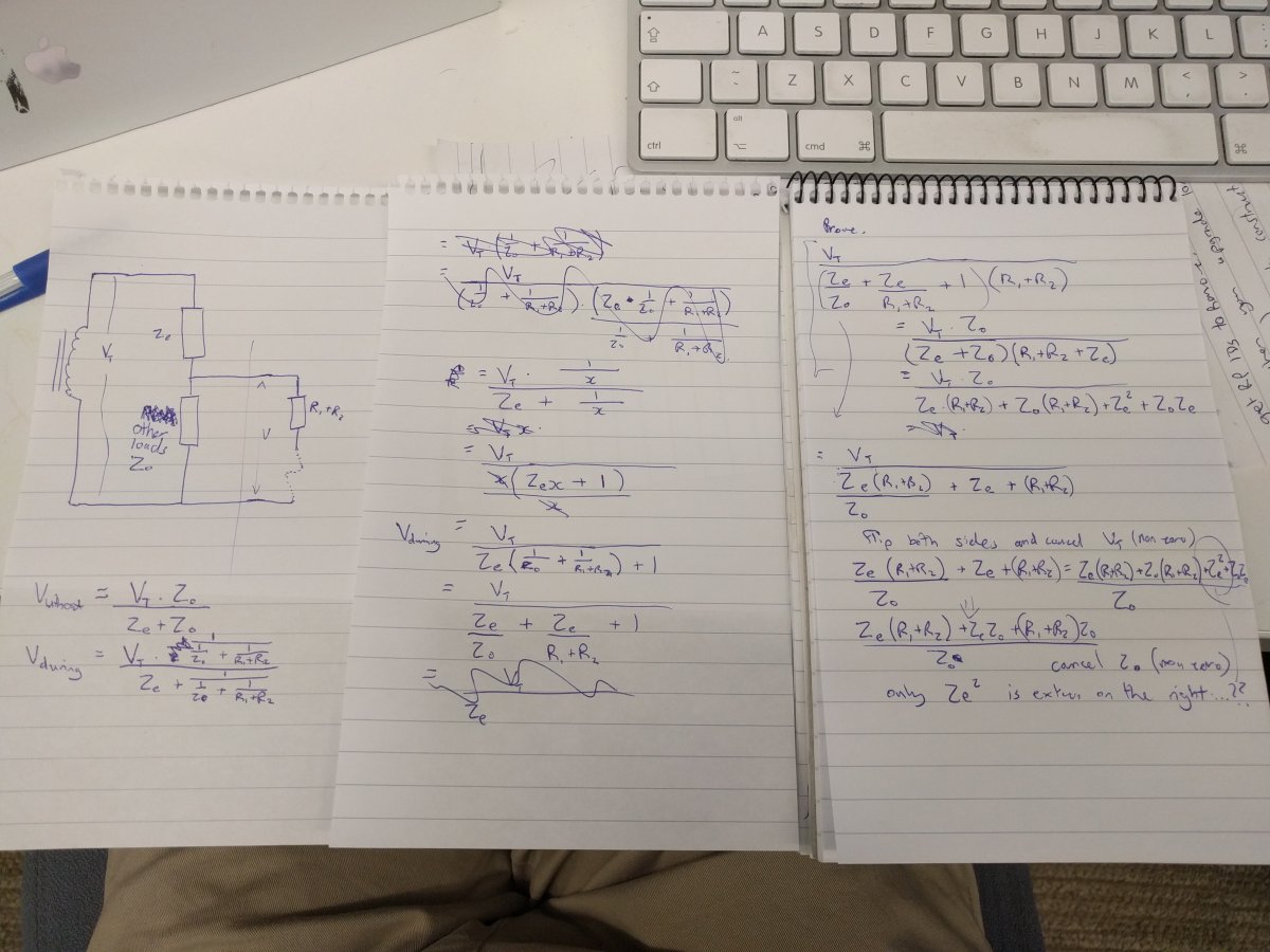

There is no doubt (unless I'm going mad!) that if one just looks at the installation in question in isolation, then:
Current through fault = supply voltage (at origin of the installation, during fault) / (R1+R2) [to the point to the fault]
(that is just Ohm's Law). However, we, the regs and probably the way in which meters measure Zs have always presumed that that:
Current through fault = supply voltage (at origin of the installation without fault) / Zs [i.e. (R1+R2)+Ze, to the point to the fault]
If both of those equations are correct, the right-hand sides of both must be equal. In other words, supply voltage during fault divided by (R1+R2) must be equal to supply voltage without fault divided by (R1+R2+Ze). I will attempt to prove that mathematically and, if I can, then try to work out what it means in terms of the physics.
Kind Regards, John
You're right they should be the same. I had a go and ended up with an extra factor of ze², but I am sure it's my mistake as I haven't done algebra in ages. I was trying to be wary of dividing both sides by zero and proving 1=2 but I think there another error.
Join the club! The algebra I'm trying to do (a bit more complex than yours, since I'm considering a more general situation) is proving very tedious and complex. I can but ask you to continue 'watching this space' whilst I do battle with it!
Kind Regards, John
Actually I now think the reason I couldn't prove it is because it doesn't hold. In short the situation is "better" safer than the meter makes out.
This is because when the fault happens, (margianlly) less current flows through the "other loads" (Zo) due to the voltage drop they see due to our fault. Therefore we get more current through our fault.
Since Ze would be small and Zo would be relatively large (i.e. the voltage without fault is 0.9 or whatever of the transformer), we would only have a small effect, but positive nonetheless. So maybe that covers the difference between the minimum 0.94 and the specified 0.95 factor! ;)

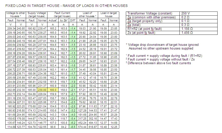

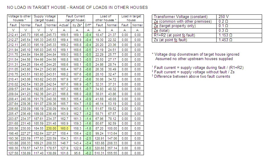

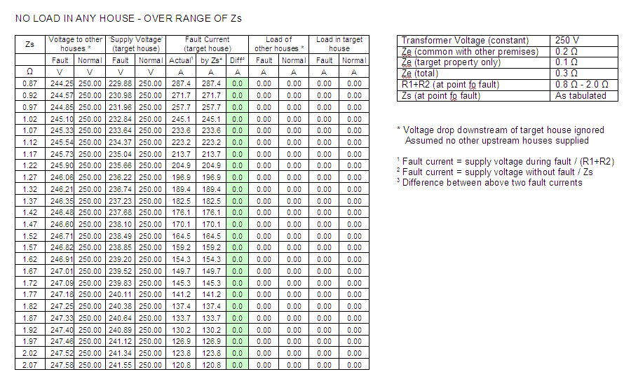

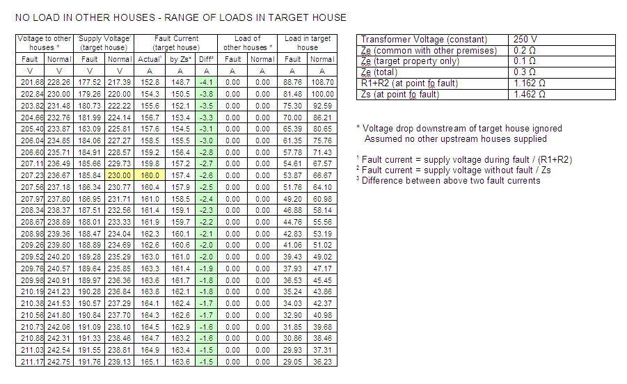

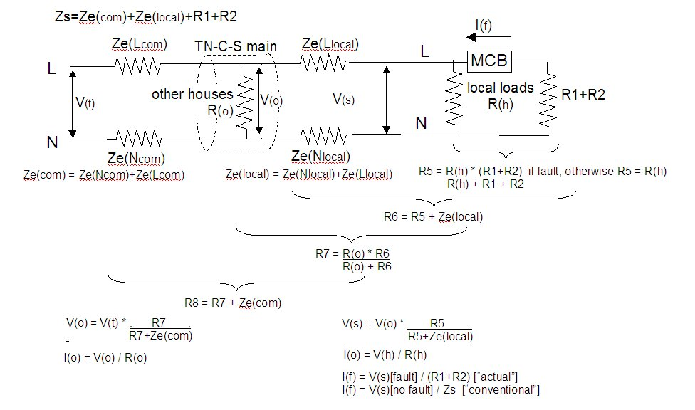

OK, to hell with the algebra for the time being - for now, I’ll present some of my simulations!
In fact, if my simulations are correct (which I think they are - but will check again), then I think there must be some (very small) relevant factor missing from my attempts at algebraic modelling, since it appears from the simulations that there is a (very small) difference between PFC calculated in the two ways we have discussed. It is therefore probably the case that, unless I can refine my model, my algebra is never going to be able to prove that the two methods are exactly equivalent.
I hope the attached tabulations are readable, and also hope that they are essentially self-explanatory. Each table explores a different aspect (as described in the title) and seeks to compare the “actual” PFC (supply voltage during fault divided by R1+R2) with the PFC as normally calculated (Supply voltage without fault divided by Zs).
As you can see, no matter what scenario I consider, the convention calculation of PFC (using Zs) very slightly under-estimates the PFC (i.e. is very slightly ‘on the safe side’), the mall 'error' increasing with increasing load on the network. However, the differences are very small (generally not over 1%, except at very high load currents) and are well within the likely range of measurement error when measuring Zs.
Any thoughts?
Edit: I've just noticed that the fifth (last) of those tabulations is actually a copy of the fourth one. I have posted the proper fifth table below.

The simulations I've just posted seem consistent with that.

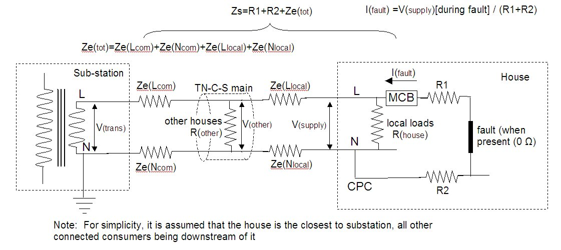

So that you can see the basis of what I've simulated (as per tabulations posted above) and have attempted to model, the following couple of diagrams may be of assistance. Please do indicate if you can see anything wrong with it!!
Kind Regards, John
