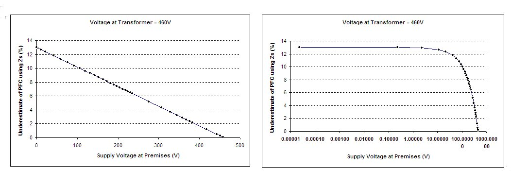

This is very interesting - there is seemingly a limiting value to the error. No matter how heavily one loads the LV network, the 'error' (underestimation of true PFC by 'conventional' Zs-based calculation) never seems to exceed 13%. In the below, with a transformer voltage of 460V, the error is still under 13% (actually 12.99%) even if I load the network so heavily that the supply voltage at the premises (without fault) falls to about 20 μV! Since there clearly is a limiting value, it must be possible to determine that value algebraically - so I haven't given up that exercise, not the least because it might help me to understand the reason for that 'limit'!

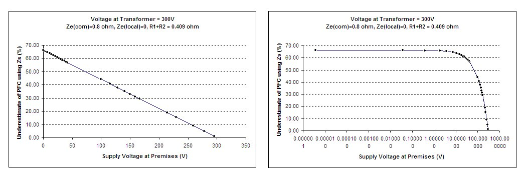

Try a higher shared ze 0.8ohm and a lower r1+r2 say 0.2ohm for a b45 cooker circuit, and no local ze.
Hmmmm - my guess was certainly wrong, and now I'm getting more confused/uncertain. I changed to a shared Ze of 0.8Ω (and a zero 'local Ze'). However, I had to reduce the transformer voltage to 300V and use an (R1+R2) of 0.409Ω to get it to be 'right' for a B45 at 230V (225A PFC). As you can see below, there was again a limiting value to the error, but this time the 'limit' was a bit over 66%, very different from the 13% I had before. Indeed, all the errors (underestimates of PFC) were 'high' - at a 230V supply current the error is nearly 35A (about 15%). It therefore looks as if, if I can ever get my head around the algebra, the error (or, at least, it's limiting value) may well to prove to be a function of the ratio of Ze to (R1+R2), or something like that. However, we are now seeing errors in the conventional method of estimating PFC which are somewhat more 'serious', hence perhaps with more practical implications.

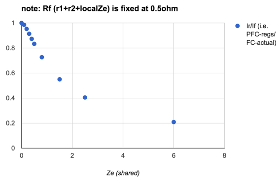

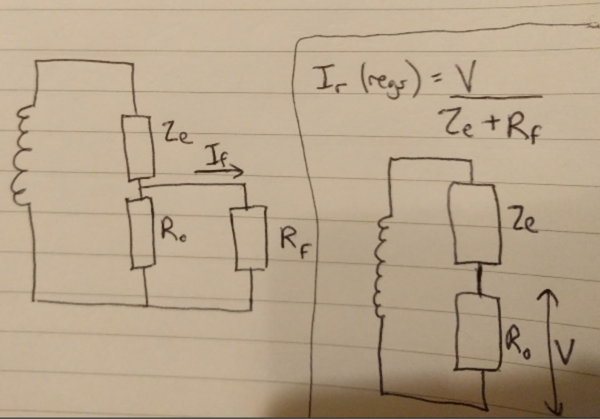

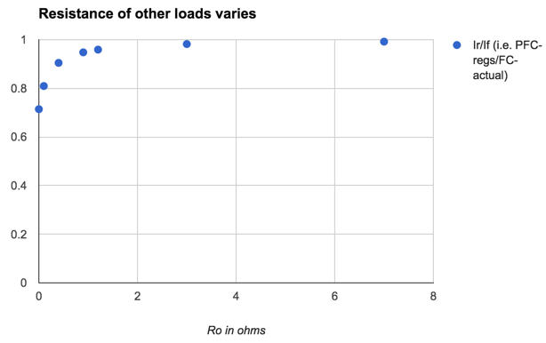

OK I've successfully worked out a formula for
Ir/If (REGS_PFC/ACTUAL_FC) in terms of
  1. the effective shared Ze
  2. the effective resistance of the other load Ro, and
  3. the non shared Ze+R1+R2 (Rf)
So we would get 1 if they are the same, but if the regs calculated value is (say) 13% lower, we would get 0.87.
I graphed the ratio with each of the three terms varying and I found the resistance of the other loads on the network always causes the same percentage error.
Here shows the bigger the Ze the bigger the error (obviously, since with no Ze we'd be measuring true FC)

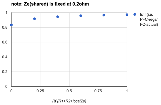

Here shows the bigger the R1+r2, the more accurate things are
And here shows the resistance/current of the other loads has a small effect
EDITED the graphs due to a spreadsheet error
And here shows the resistance/current of the other loads has no effect on the *percentage* error of the PFC
Thanks. As you say, your first two graphs are 'as expected'. However, this third one is clearly at variance with my simulations - which showed a marked effect of the 'other loads' (as reflected by the supply voltage on my x-axis) on the percentage error in fault current (which is what I plotted). What were the other 'conditions' (in terms of Ze, R1+R2 etc.) for this third plot?
Kind Regards, John
Here is the formula I used - the definitons here:
The actual forumla here:
Sorry, somehow all my "B" in the spreadsheet got turned to "C", I'll edit the original post to have the correct graphs
Edit: I have edited my above post. See below for an intutiton.
ok I've got it, for a low error given a certain Ze, you need either the other load or the fault loop to have a relatively high resistance.
The intuition works because if there's almost no other load, there's almost no error on any huge fault current. Also if there is almost no fault current (high R1+R2) then there's going to be almost no error regardless how loaded the network is. However if you make Ze tiny, doesn't matter if there's a heavy load or a huge fault current, there won't be an error.
So the key to low error is making the *shared* Ze low compared with the resistance of the other loads. IE not too many people on the same cable unless you make it thick!
If Ze, Ro and Rf are equal, there's always a 25% error.

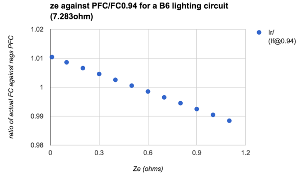

Anyway, for my final flourish, I've proved that our lighting circuit is the most dangerous in the house - you were right that 0.95 doesn't make sense and it should be 0.94 for the voltage to use:
As you can see, when Ze is below 0.5 ohms, our lighting circuit that (just) passed the Zs test will not be guaranteed to trip the MCB in time!
That assumes Vtrans=253, our origin voltage is 0.94x, and the MCB needs 5x to trip quickly.
Hmmm. Are you sure that your model is correct, since that's something which I have not yet ever seen with any of my simulations. I've looked at a fairly wide range of situations and the ('per regs') Zs-based method has always under-estimated actual PFC, never overestimated it - which is why I thought I had at least reassured myself that errors in the estimates were always going to be in the 'safe' direction. When I have a little time, I'll see if I can reproduce your equation.
