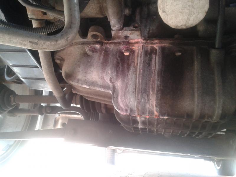

Hi, I have a problem with my 06 fiesta (had it 8 month), yesterday I noticed a tiny puddle under the car. I noticed it was pink so I thought it must be coolant. However, when I look under the car it appeared thick like sealant and running down the sump. I know sealant is used around the sump but why would it leak?
Any help would be great
Thanks lucy
Thats coolant, Lucy - leaking from somewhere above the sump, and running down the back of the engine.
Do check the coolant level in the white bottle, under the bonnet.

The coolant is low. This feels really thick almost like putty. Where would I be looking if it was from higher up because I cannt see it any where. Just around this bit.
you need a bright light and a mirror, Lucy - to see down the back of the engine especially behind the water pump area.
John :)
Obviously it depends where the leak is....if its one of the rubber hoses then the fix is quick and cheap - if its the water pump then its more involved and expensive, depending on which engine is fitted.
Either way, please top the coolant up to the full level.....if you haven't the genuine stuff then tap water is fine in the short term.

Just wanted to say thanks very much. Took the car to the garage today and it was the thermostat and seal (apparently a common fault). Cost £85 but think it could of cost alot more if the car had over heated!
Once again thank you to burnerman and mursal.
