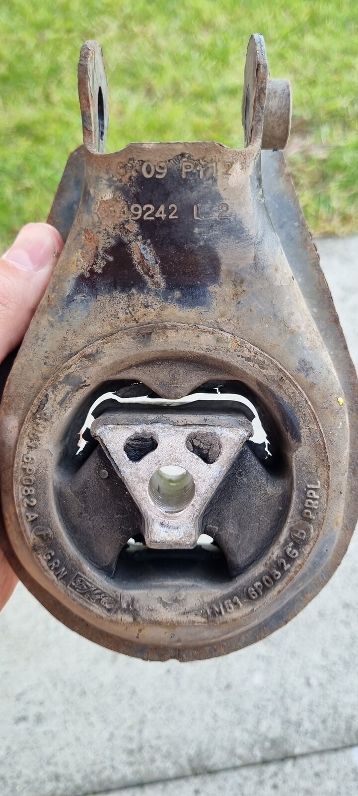

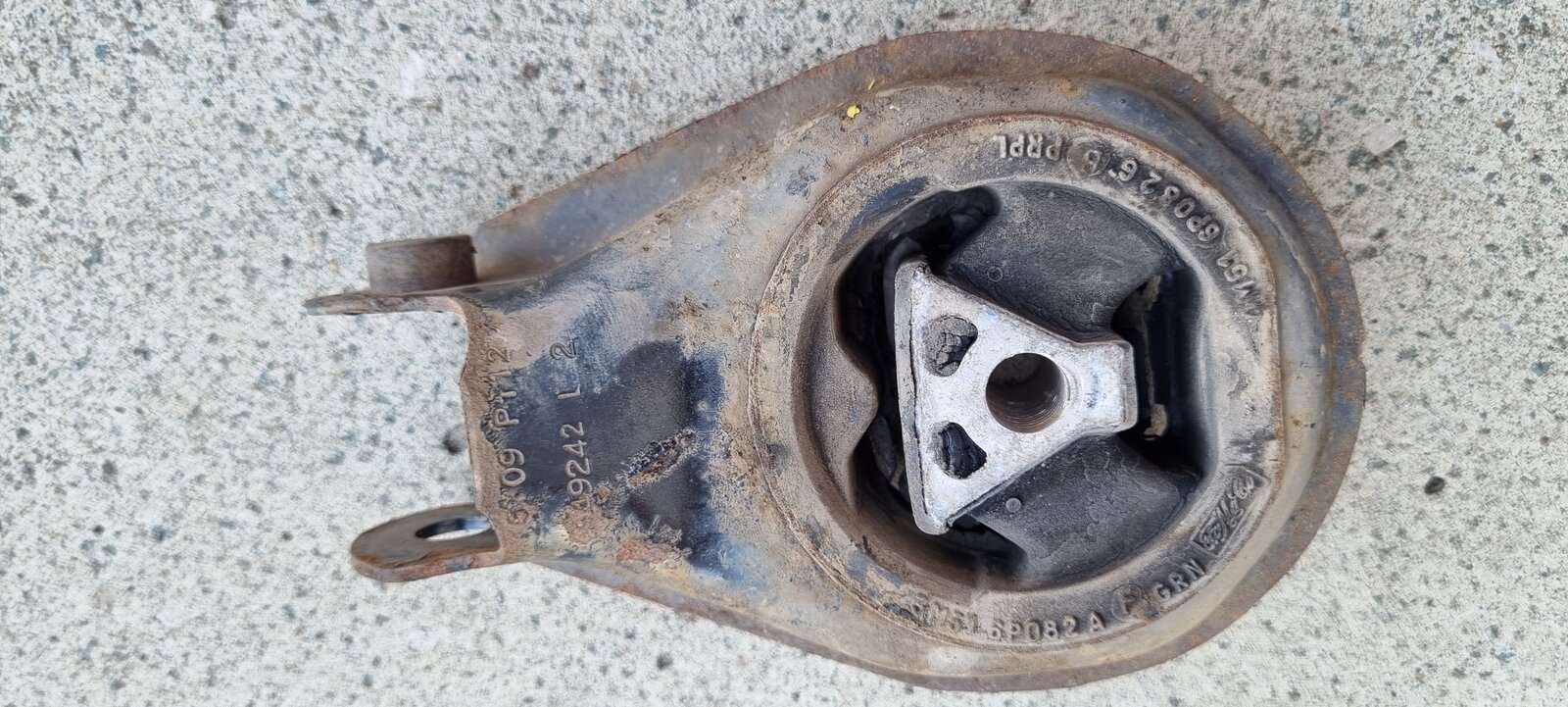

Finally got it off when changing the oil. The noise only ever happens when changing from 1st to 2nd. Do you think this needs replacing?
It looks OK in the photos, but to be sure - clamp the body in a vice and insert a large lever/screwdriver through the hole in the centre of the bush. Try levering it in various directions, to see if any splits open up in the rubber. Any splits then fit a new one.
