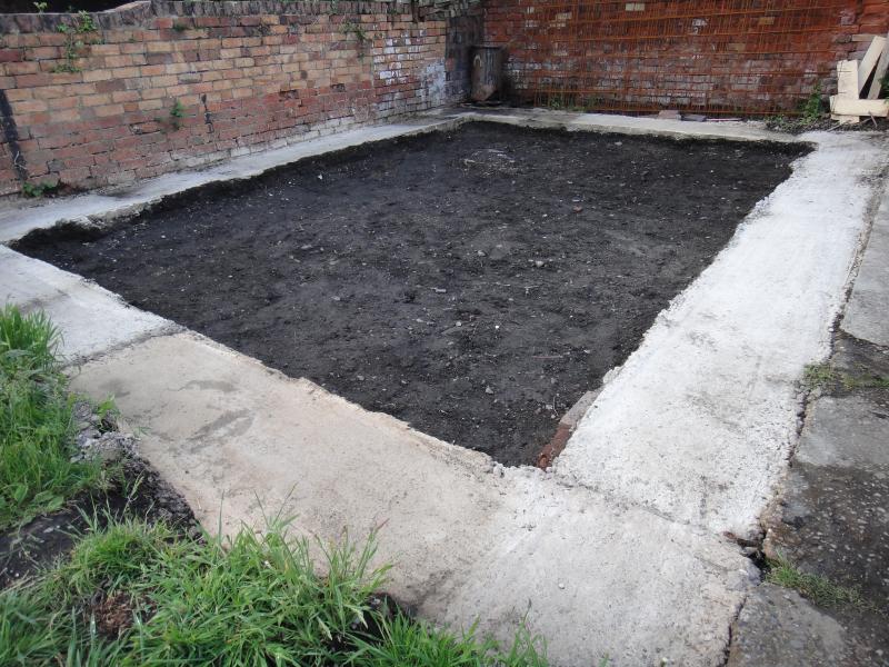

Just digging out the center ready for the hardcore to go in. I'll have some heavy weight in the shed like my weight bench and a couple of arcade machines. I have two questions if someone could answer them for me.
1, Am I right in thinking I need 150mm of Type 1 hardcore as the base
2, do I have to dig down to the clay, which would be deeper than 150mm, or do I just dig to around 150mm as long as the soil is firm?
Thank you :-)
For a shed I wouldn't be to particular, just make sure there's no organic matter in what's left and you'll be fine. I50mm hardcore with 50mm sand blinding on top is general...pinenot :)

I've dug the center out now ready but we seem to be getting spurts of rain which is making the ground damp. Even though it made it easier to dig up the remaining corner today, is it best if I cover the ground up until I can get the compacted hardcore in there or does it not matter?
Also, the sand blinding, is it sharp sand or builders sand used for that? I have a tonne of sharp left from the footings andd wondered if I could use that up?
