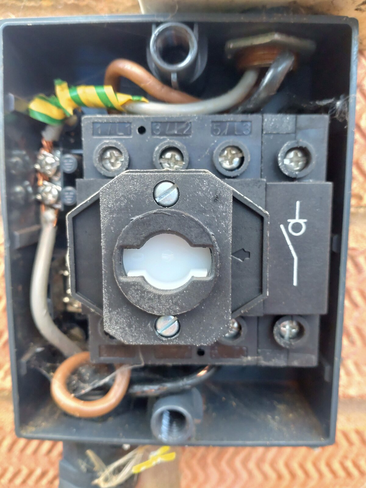

The solid N link on the Ops one is to the left side of the poles it's just a flat bit of metal same as the earth.
I'm again confused. All I can see 'on the left' appears to be the earth (with a bit of G/Y tape). What am I missing?
As for the 415 I mention, we do fryers with 3 x 240 v elements and 240v electronic controls,, when all 4 poles try to switch together, I feel if the 4th pole in the isolater shown was a bit slow and used as N, loss of neutral can cause two phases to oppose each other via the elements causing up to maybe 415 volt between phase and N
As I've just written to Risteard, I've yet to get my head around that suggestion.
Furthermore, if I understand correctly, you and he seem to be saying opposite things. You are saying that can be a problem if the neutral 'breaks late' ("a bit slow"),whereas he seems to be say that (the same) problem arises if the neutral does not break late'!
There is another silver uninsulated block below the earth block. It's marked N.
There is certainly something below the earth block, but I have to leave it to your superior eyesight to identify what it is ;)
If that's intended for the neutral, ehat is the purpose of the fourth pole of the switch/isolator/whatever?

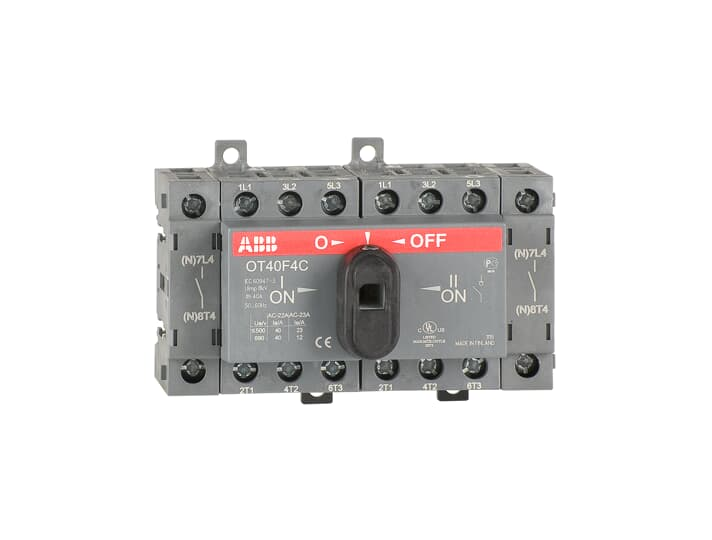

The thing about these sorts of units is they are made of parts: Enclosure with earth and neutral terminals, switch may be available in 2 or 3 pole (and possibly 4), add on switch modules.
If you look at the pic you'll see the terminals are numbered 1/L1, 3/L2, 5/L3 across the top, the bottom is 2/T1, 4/T2, 6/T3 but the 4th pole has no markings
The additional pole can be added to anything in the range and possibly several stacked to make 5, 6 poles etc.
When purchased as a 4 pole the 4th may be marked, typically with L4 & T4 or N. This one is clearer and shows both markings:
On larger units they often come as a kit of an actuator and any number of modules which may or may not be marked
Some of the companies I've worked for keep stocks of the parts and assemble as required.

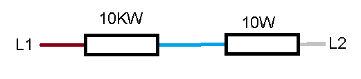

Imagine the scenario of a 10KW load on ph1, 10W halogen bulb on ph2 and nothing on ph3 and the star point loses the neutral:
I won't bother doing the Ohms law calculations but I'm sure it becomes apparent quite quickly the pd across the bulb will be almost the ph to ph voltage, I'll go so far as predicting within 99.9%
Any 'internal 240V equipment' would have to be connected between neutral and one of the phases. If the neutral 'breaks early' then any such internal equipment would be 'disconnected from the supply',
The neutrals of the loads may be disconnected from the supply, but they are still connected to each other!
