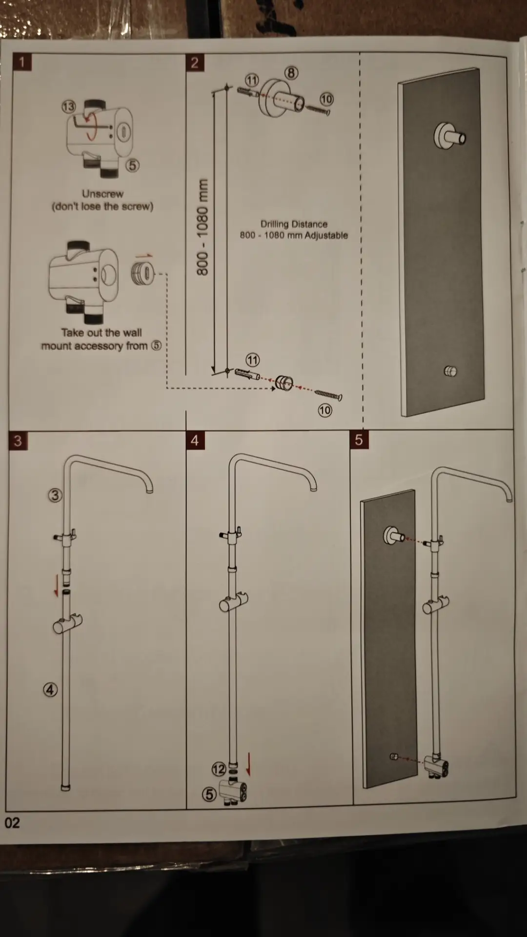

What I want to install:

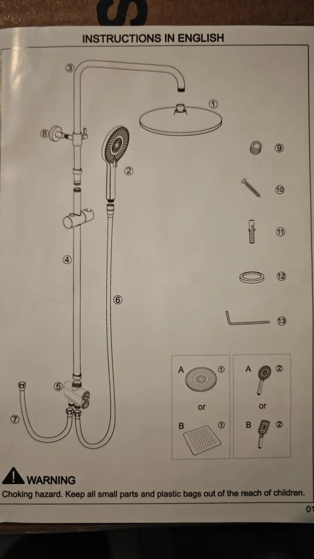

I got this, and it's perfect, but now I'm afraid it feels heavy. Is that a thing, a shower assembly being too heavy for a wall?
The whole thing when assembled is 2.4kg. The overhead shower head, which is the one if you look at the images below that protrudes out, is 1.45kg alone. So that's what I'm dealing with, but I know the integrity of the wall and the type of force is more important than the weight capacity of the anchors. On wet sponge, anchor tolerance is pointless.

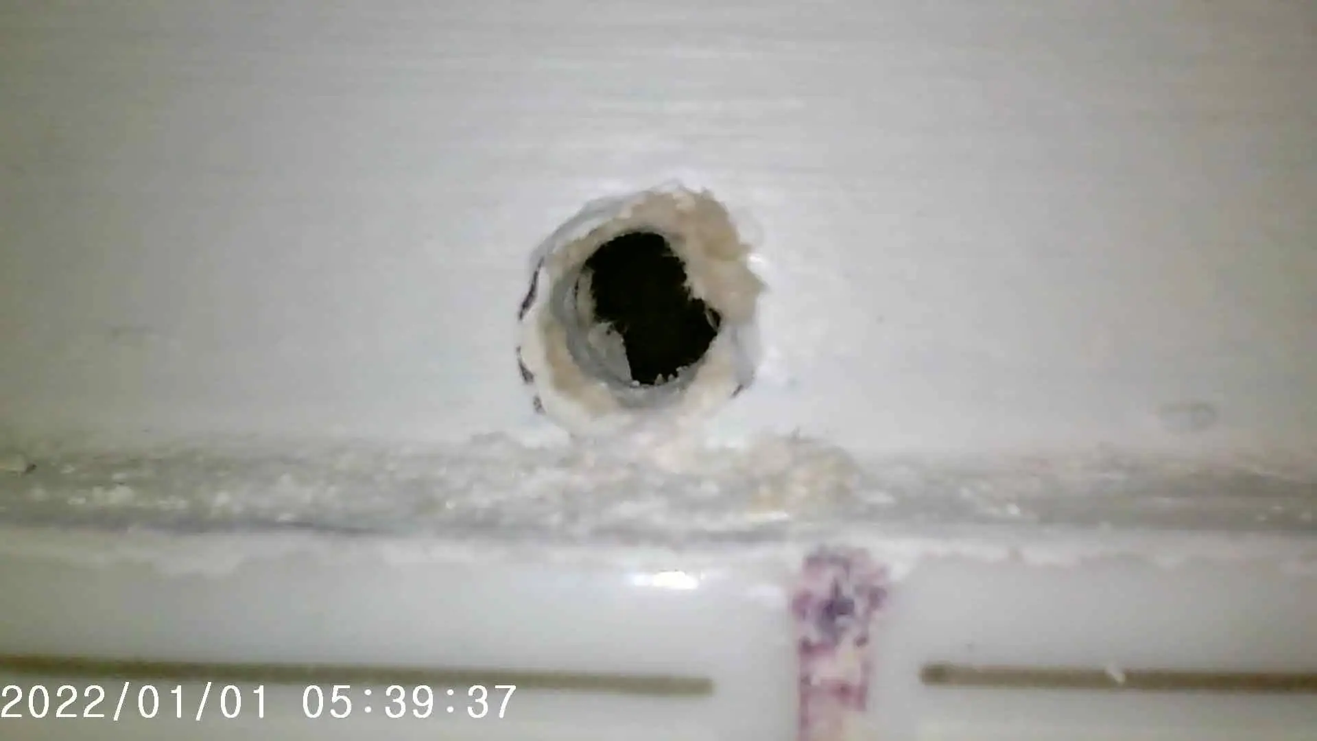

Just did a wall measurement in an empty part of the wall and the wall is 1.75cm / .75" thick, the gap between the shower wall and the next one is 4.5cm / 1.8". And the tiling is about .6-.7cm thick. But the plastic toggle bolts I have need about a half inch hole and I don't wanna do that in a shower.

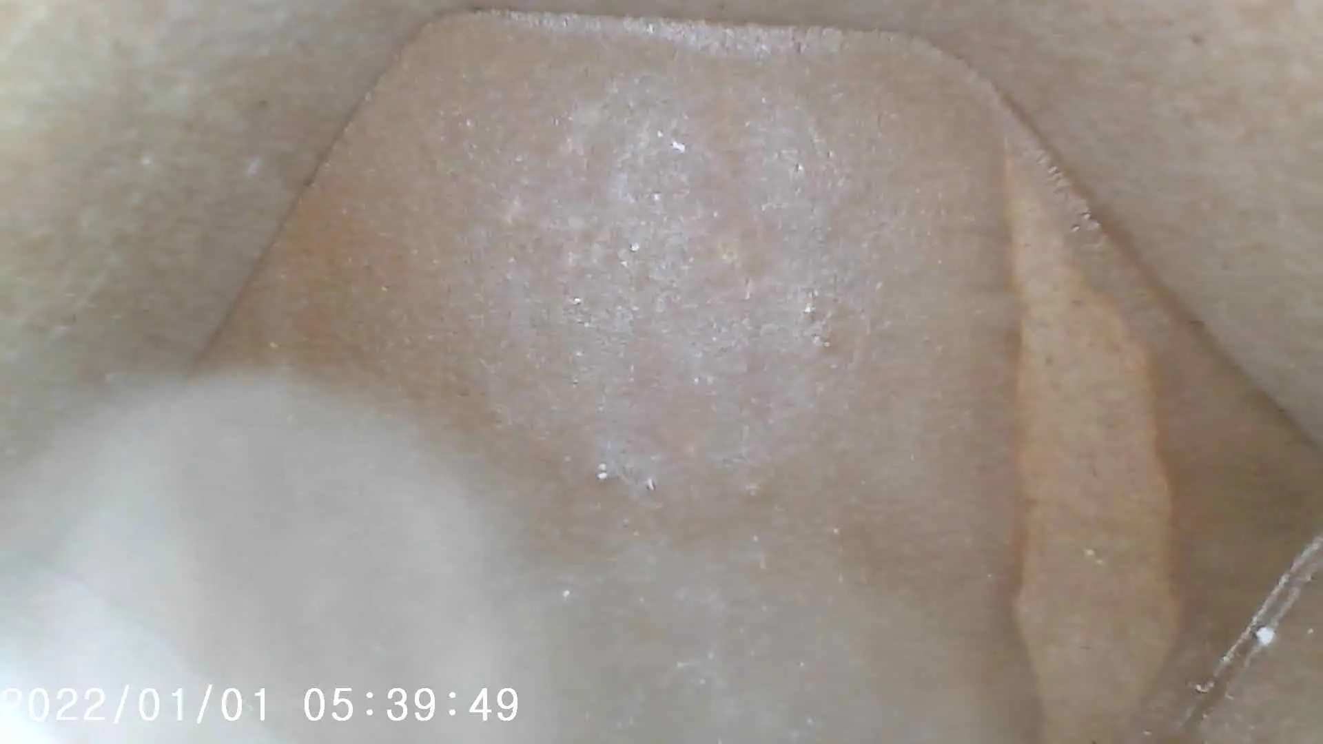

I genuinely have no idea. But.. I've taken a couple of photos with my endoscopic camera and a video. No clue what I'm looking at. Did I just happen by chance to find myself in this hexagonal air pocket in the wall?! And what is that material? Some kind of internal foam? All I see when I turn/rotate the camera in there is the same white material. I was hoping to see a stud in an empty wall that I could aim for from the outside.
Here are the photos and a video.
Looks like hardboard with egg carton internal. Not really suitable for a bathroom, I'd recommend ripping out and refitting cement board or at a minimum moisture resistant placoplâtre before hanging your shower on it
