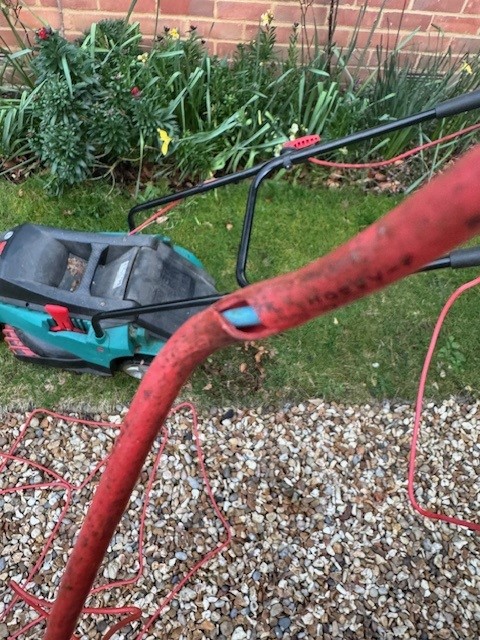

Hi all
Have tried googling this but all I can find are repairs to cables that have been completely damaged.
After pulling out the mower for the first cut of the year, I think repeatedly tying up the cord in the same way after each use has taken its toll and resulted in several sections of frayed outer rubber insulation/protection sleeve. See picture below.
Are there any fixes for this?
Thanks in advance.

Electrical tape would do the job as you have only cut through the outer sheath of the cable. Inner sheath still remains intact based on the picture.
Probably better to replace the cable as if it has cracked in one place then it has probably cracked in others as well.

The outer sheath has cracked because as mentioned the plasticiser has gone, This can create comparatively sharp edges ( the white area ) which as the cable flexes can cut into the insulation of the Live and/or Neutral wires. Wrapping tape around the damaged area will not prevent this.
When the insulation on the Live is damaged dampness / moisture can create the hazard of electric shock
I would agree with others, if a cable is failing in one place then a repair may be sensible, if a cable is failing in many locations then it's likely reached the end of it's life.
If possible I would replace the whole cable, if that is not an option then I would cut the cable and insert a joint (probablly one of the 2 pin plug and socket types) close to the appliance.
Thanks everyone. Yes the cable has failed like this in several places. Think I'll go ahead and replace the whole thing.
Thanks!
Note to OP - What ever repair you decide upon, first check whether two core (double insulated appliance), or three core cable is used, and replace with the same. If you decide to use those inline plug and sockets, likewise match them - two pins for 2core, three for three core.
Absolutely, will cut through and see what the set up is first. Thanks.
