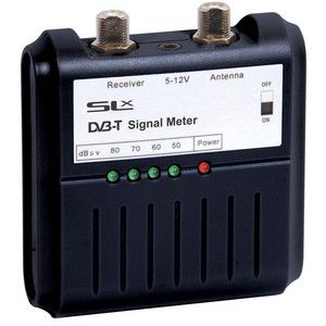

I'm wanting to get a signal tester but there seem to be loads around for fairly cheap.
Can anyone recommend one "cheap and cheerful" meter that will allow me to test the signal strength of the ariel please??
I've been looking at a few for less than a tenner?!?? Any good??!???..??
If you own a Freeview enabled TV then you already have something far better and more accurate than any "cheap and cheerful" signal tester. You should replace "cheap and cheerful" with "cheap and dreadful" lol Seriously though, testers such as this...
... have very poor sensitivity for start. Second, it measures the power rather than the quality. IOW you could have a crap signal, put it through a powerful aerial amp which would make the 50 and 60 LEDs illuminate but still give a broken picture on TV. The 70 and 80dB lights are completely redundant. If your TV gets a signal strong enough to make those light up then chances are it will overload the TV's tuner. Final part of of this damning review is that the steps between the signal levels are far too large. Every 3dB difference is equal to doubling or halving the signal strength. To make a 10dB difference you'd have to point the aerial in completely the opposite direction to the transmitter. That hardly makes the meter a good fine tuning tool.
Save your money. Use the Signal Strength and Signal Quality bars on your TV's tuning menu. The most important display is Quality (Q). Get that to 80%+ if possibe. Strength is hardly that important at all. Your TV will be quite happy with 50-70%. Too much signal strength is just as bad as too little.
