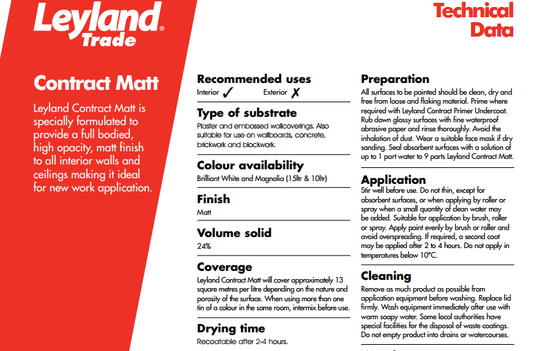

Just had a room boarded and skimmed, do I need to do a mist coat?
If so can I buy some cheap white emulsion and mix with water to do it with as I am using expensive paint (thats grey)
OR
Can I just go for it? Im using Dulux endurance
Cheers boys!

Ok, Have a gander on the back of the tin, and it'll tell you how to use 'water' down a part of the same paint, and make a mist coat.

Using diluted contract matt for mist coats is the method that the pros use and it has proven results and longevity. Your methods of recommending vinyl emulsions for mist coats (although perfectly acceptable when done correctly) and even the use of PVA combined with emulsions is the way that DIYer's do things after reading poor advice. They then come to this forum for advice when they have issues when such methods have been used.
If you are suggesting that contract matt cannot be diluted and/or is not suitable for use on new bare plaster, then I suggest you read the back of the tins and follow the manufacturer's advice.
Honestly, you just make yourself look sillier and sillier every time you criticise correct methods and try to justify your problem-causing ones.
And, before you try to justify your arguments, you can paint over contract matt with vinyl emulsions without any issues, and it does satisfy the porosity of the plaster to allow you to do so.
You can certainly hinder. If you look at the label of a tin of vinyl matt paint it will say to mist coat porous surfaces. Contract matt is a porous surface - hence it needs mist coating. Don't tell me I'm wrong - tell the manufacturers because they've ALL got it wrong according to you.
Vinyl matt will indeed say that it can be diluted to mist with - it just isn't the best product for the job. Show me where I've said it can't be used! (To quote your infamous line, 'He won't.' :LOL:)
Contract matt does satisfy the porosity of new plaster. If it didn't then the next coat of paint would be just as difficult to apply as the mist coat, but it isn't. Therefore the porosity of the wall has been satisfied with the contract matt and you can then use whatever type of paint you wish on top of it.

Buy some cheap white paint, water it down, paint cielings and walls white. this is your undercoat.. no need for expensive name brand under plaster primer b0llix. Another 2 generouse coats on top should do the trick nicely

This seems to be the main point that makes you believe you are right. The paint does indeed remain breathable but the solids within the paint have formed a layer that stops excessive amounts of water from subsequent coats being absorbed by the plaster, meaning that the next coat(s) will spread out much more evenly and easily. Give it a go - you'll be surprised!
