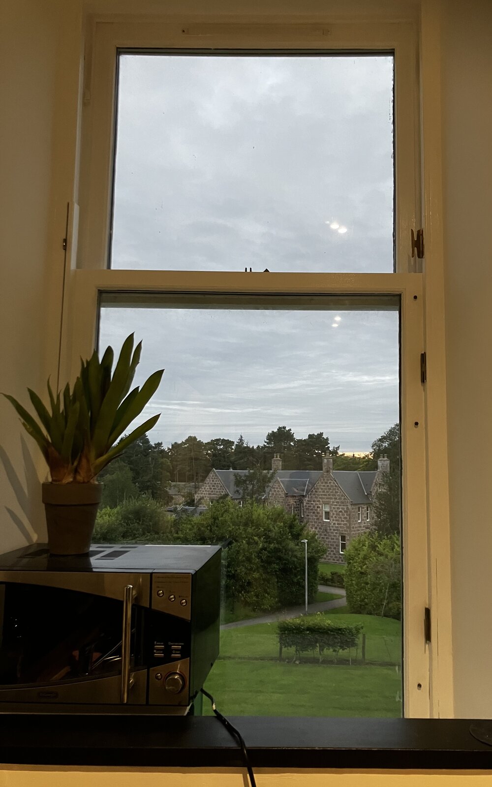

Hello I had my outside wooden windows painted by someone a few weeks ago and the window has stuck open. I live in a flat and it’s too high for me to get up with a ladder so I have tried opening it from the inside by pushing from the top, tried to bang on the top, I’ve tried using a scraper at the sides to try pop it open but nothing seems to work. I have worked out it’s stuck from the top of the window because the bottom will rattle if I bang on it. Is there anything else I can do from the inside or will I need to arrange for someone come round to do it from the outside?

First photo is the window that’s stuck but I can’t get a picture of it fully because there’s a wall.

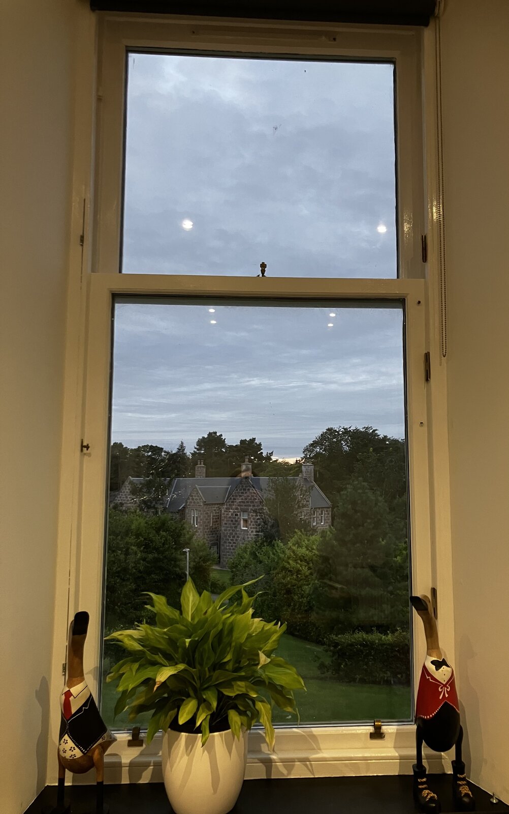

Second photo shows how much it’s open.

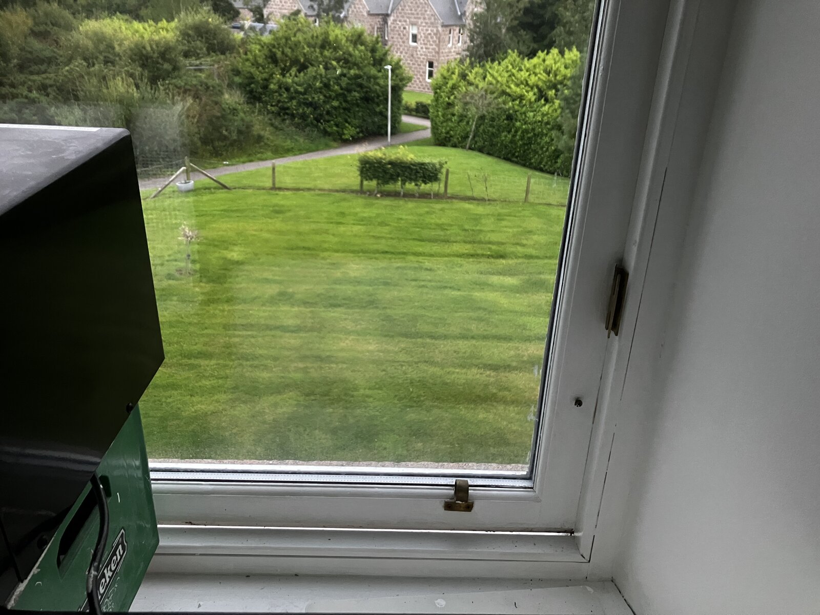

Third photo is my lounge window but I’ve only added it so you can see the style.

I would try to pry up the left and right corner using a japanese cats paw bar
If you don't have anything similar , hammer the left and right top of the meeting rail on the bottom sash. Use scrap of timber to prevent damaging the sash when hammering.
Can you see if there is anything under the bottom of the window that is preventing it from closing? i.e. a small screw, piece of wood, pebble etc?
Similarly, have a close look at the top edge to see if anything has fallen down the side that you may be able to 'fish' out.
Can you slide your scraper the full width of the window between the top and bottom sashes?
Hit it with a hammer and block of wood alternating above and below the top rail bit by not. Then spray with wd40 to ease friction. Wood expands in the cold so it might get worse in winter
