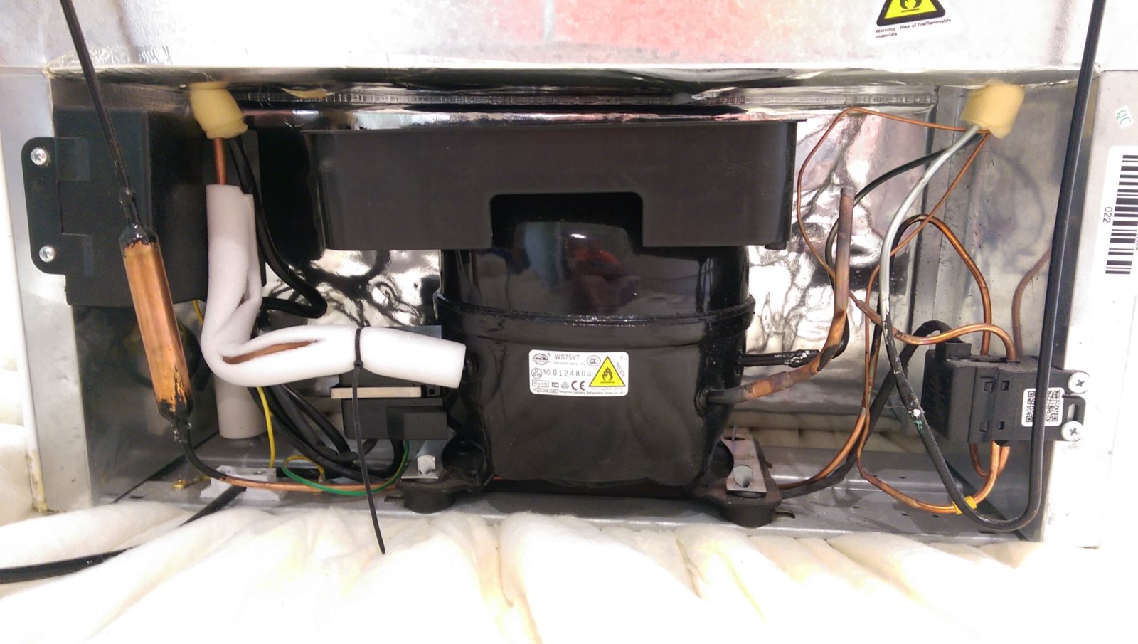

ok i'm back again, i know, i know, i'm a pain.
So after 48 hours I turned the fridge/freezer on today and neither the fridge or the freezer is getting cold (left it on for 3 hours).
I could hear the refrigerant circulating and gurgling, but nothing getting remotely cold.
I removed the fridge/freezer and put it in my garage.
I took a photo of the bottom rear of it and wonder if anyone could identify the various parts and how I could test them.
There seems very few parts and I can't even find a fan that I see mentioned everywhere.
It's almost like a throw away item. That can't be right can it?
Thanks in advance
Andy
