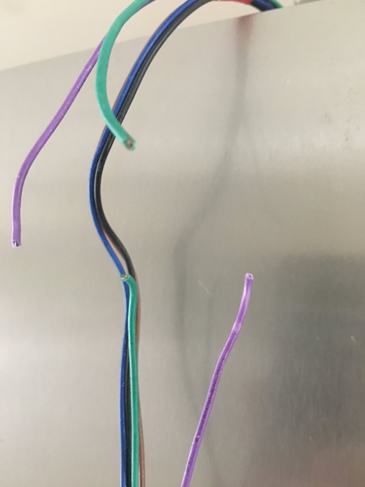

Kenwood fridge, problem with warning buzzer

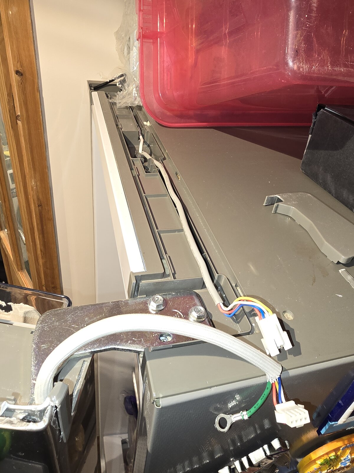

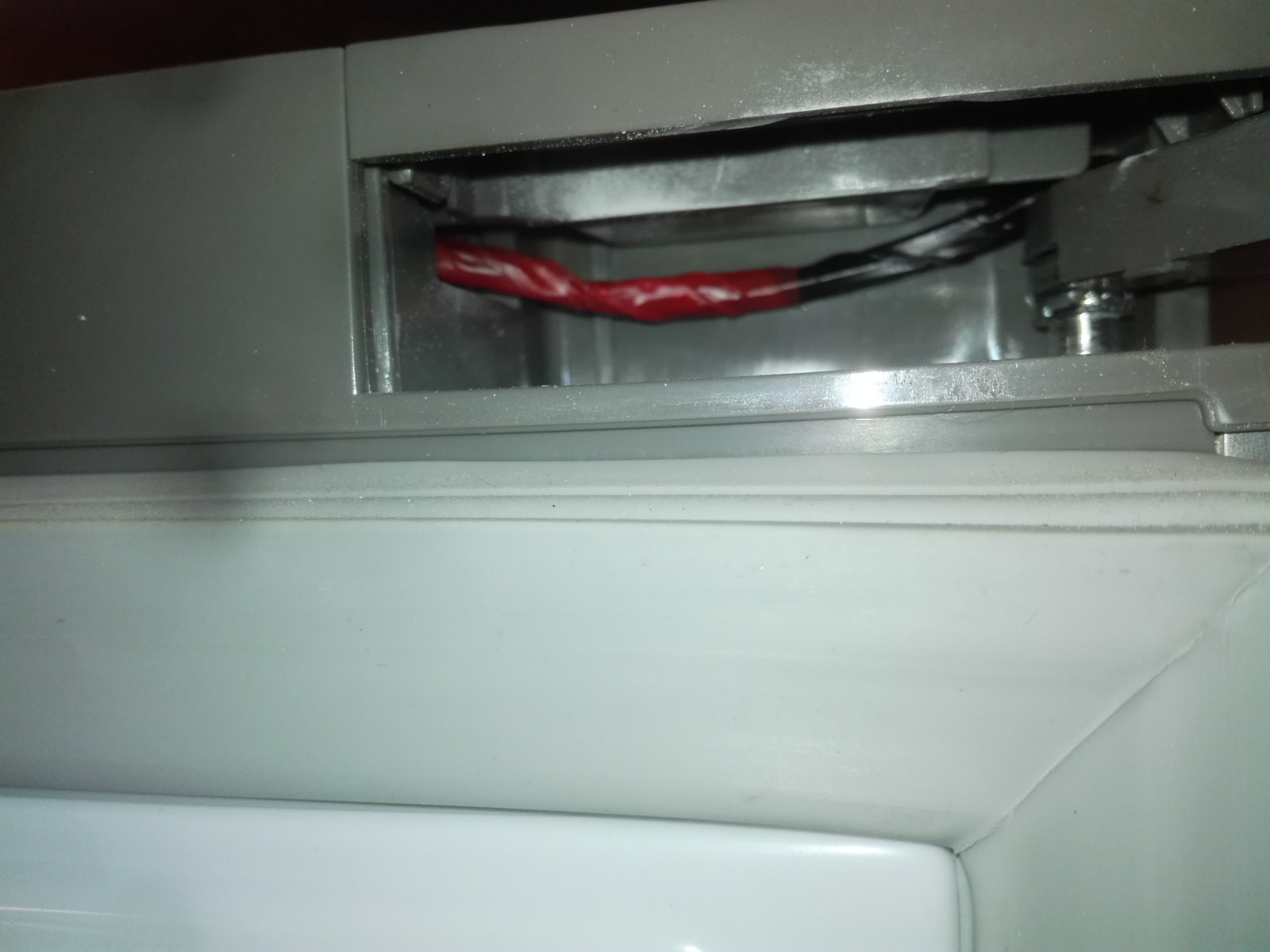

It was a while ago and I can't climb ladders to look at it, but I think the grey plastic panel on the top of the fridge door was prised out. Same on the fridge, I think.

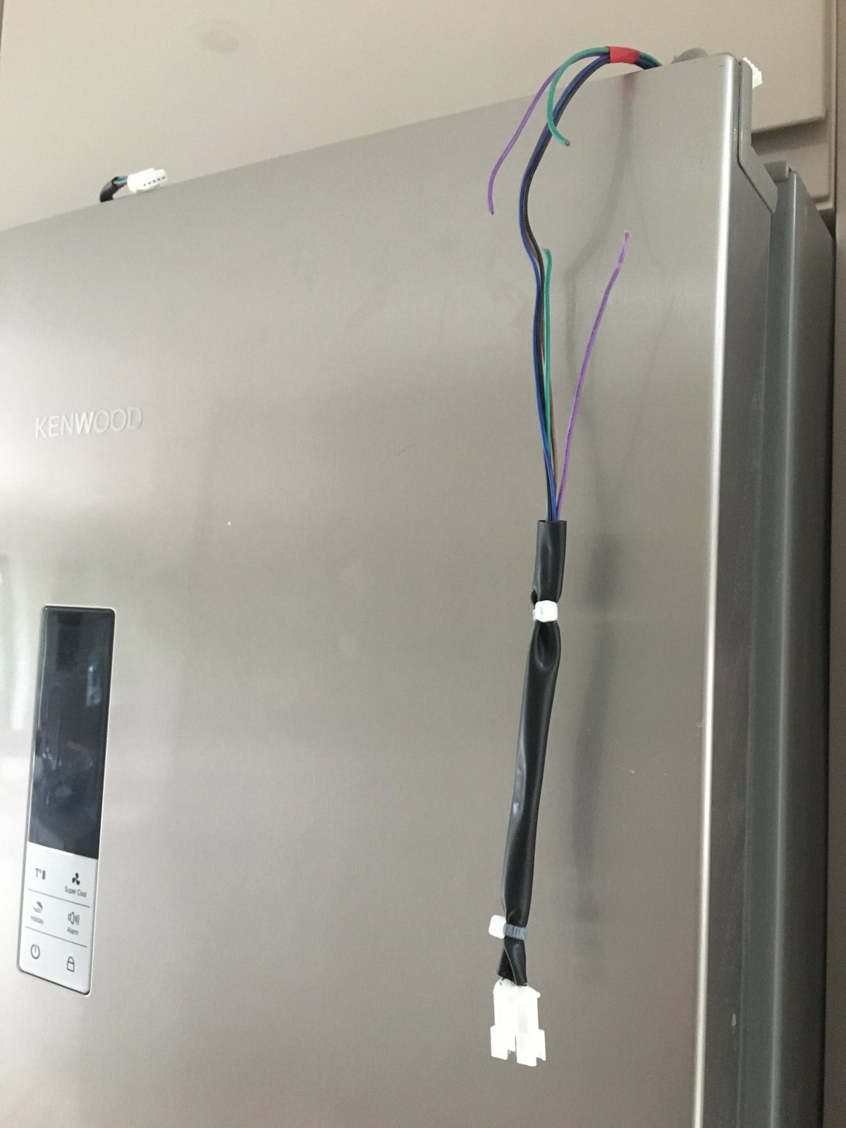

Sorted , was much easier than expected. Two broken wires at hinge , strange thing was the cable which sits in a tray had heavy protection while at the hinge, nothing .

In the case of this fridge, it has been established that the breakdown is due to poor design: they are on the third design of wiring loom. So you cannot lose!
Thought I'd post this - same issue with my KFC60SS15 70/30 Fridge Freezer 5 months in.
Currys sent WeRepair round, the chap already came with the replacement part as he said it's very common. He mentioned it's common and that the replacement part wears down too.
I saw how the repair chap opened the top to get access so since wearing is the issue I wrapped some extra electrical tape over the area that wears and covered that with gorilla tape. That should really help with the wear. I'll check it in 3 months to see how warn it is and what's actually causing the wear to see if any lubricant or extra tape will help. Hopefully that'll hold it on for a while longer when it's well out of warranty. But it will need like an annual check by me to see the wear, which isn't ideal.
The other solution is to just remove the front panel before the wear happens. I removed the display power source from the fridge's motherboard in the back unit. Was forced to when it was just stuck beeping as the fridge is in my livingroom/kitchen. Was driving me mad! Even tried noise cancelling headphones to keep my sanity to no avail.
It's exactly the same type of connectors computer fans use on motherboard cases. That way the beeping stopped when it was frayed and the fridge still maintained the correct temperature that had already been set. I confirmed this with a fridge thermometer.
The repair chap mentioned on some units it interferes with the cooling - I believe that could be dependent on the bundle of 4 internal cables that wears first. But as long as you set the temp and disconnect the front display from the motherboard then it'll maintain whatever temp you had it on.
Again not ideal - you can't then vary the temp, use holiday mode or have an alarm. But better than a broken fridge.

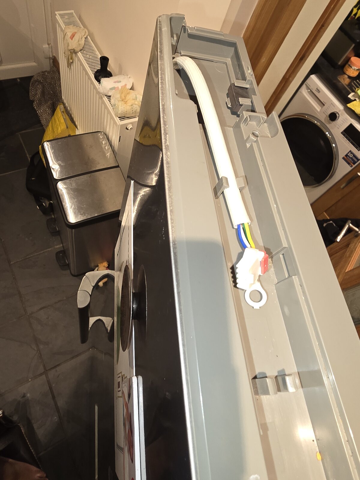

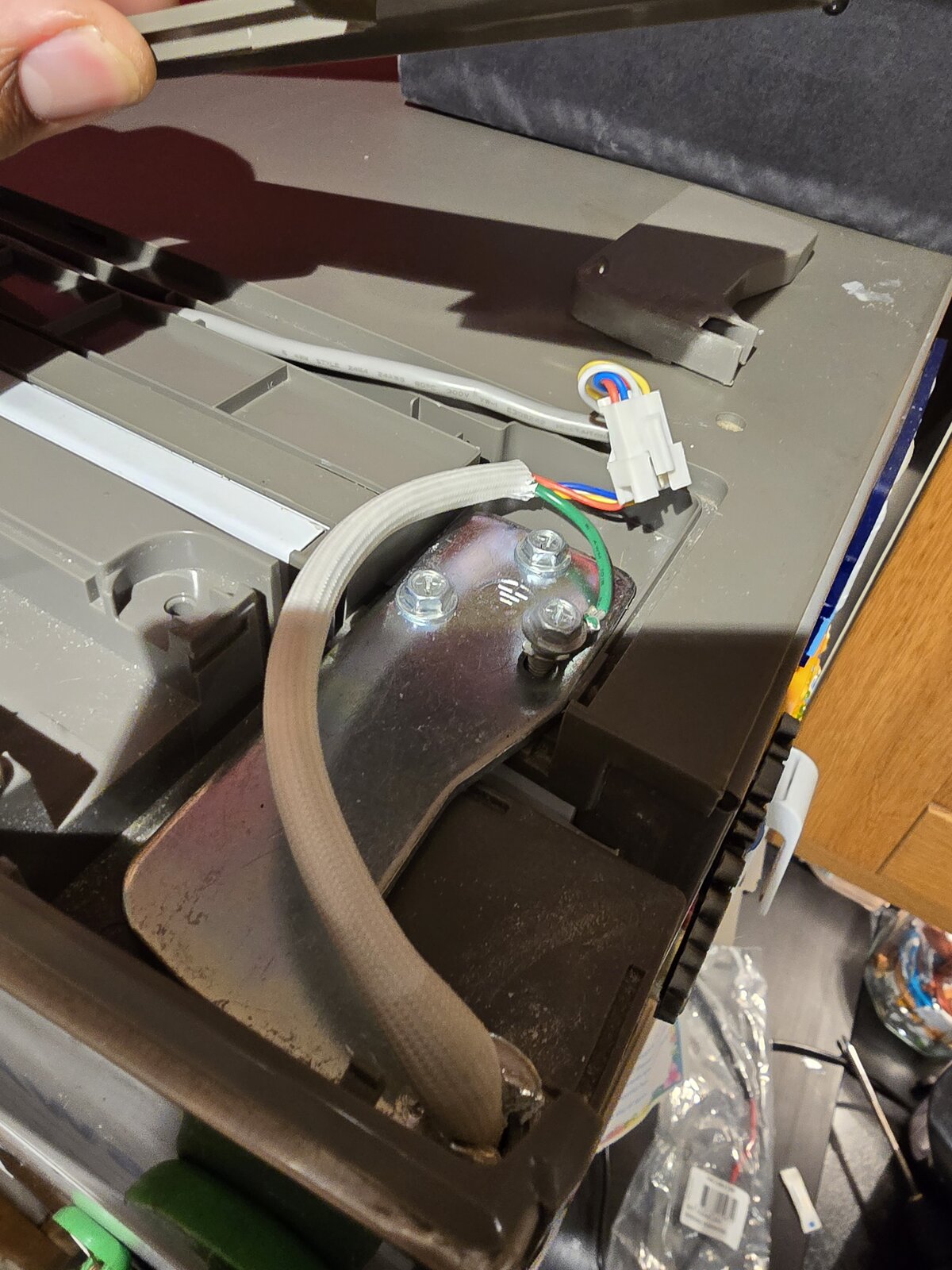

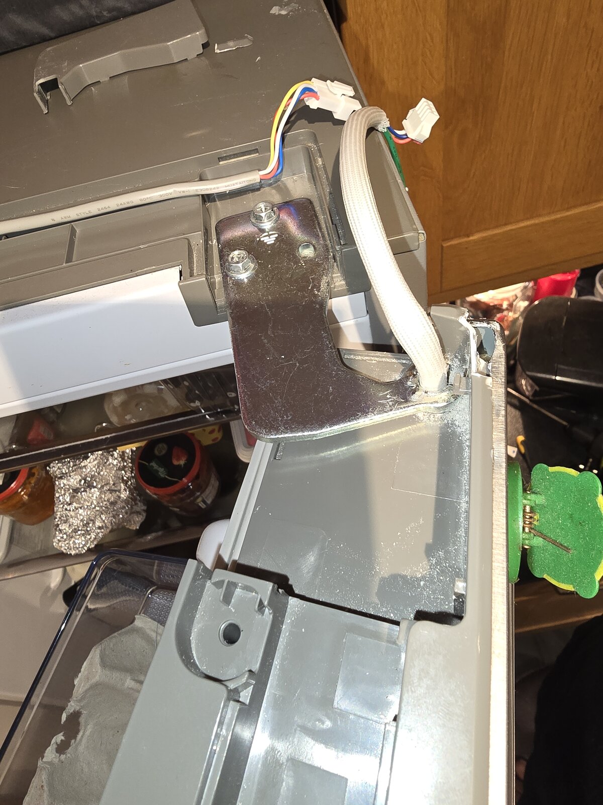

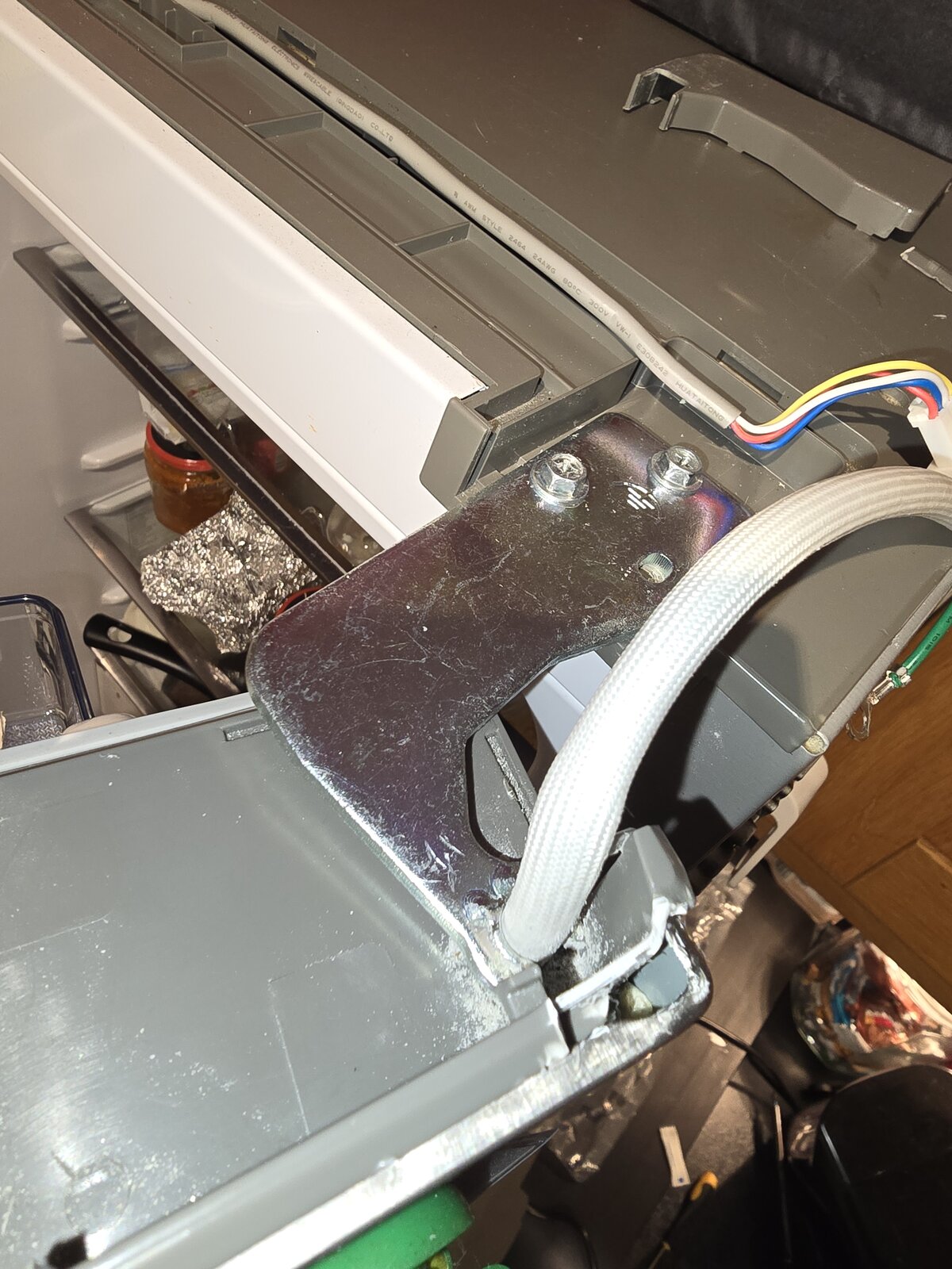

Hi all. I've got the same fridge. Kenwood ktld 60x15. I've recently started having issues where sometimes the light doesn't come on. Panel still works. Then when I press the power button the fridge starts again.
I have ordered and received the replacement loom.
Tried earlier and got the top panel off. However my wire seems to go inside the door itself. So how do I gain access to be able to unplug and run the new wire? Images attached.
