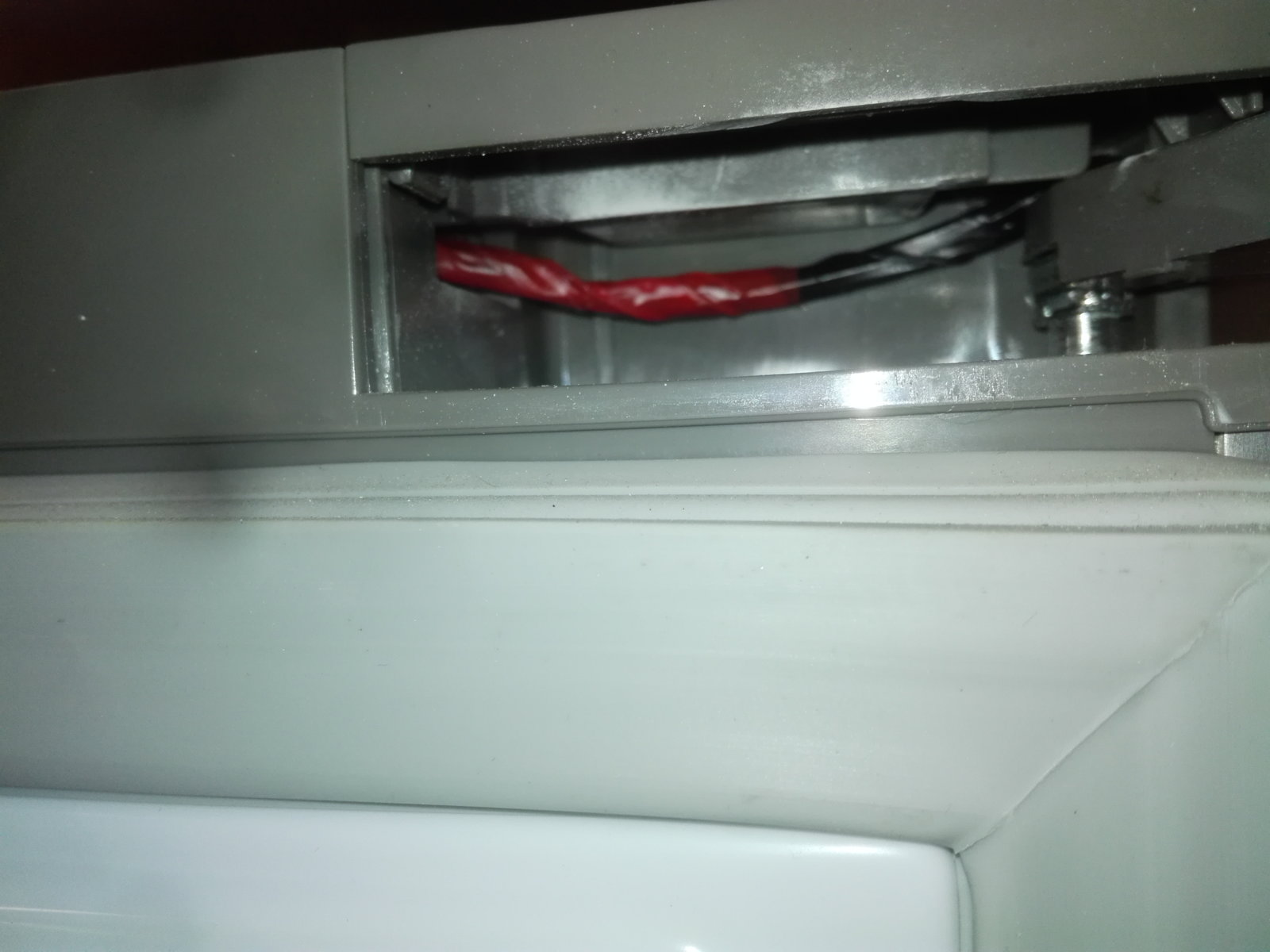

Door warning buzzer on my fridge should operate after 20 secs or so if door is left open, but recently starts to buzz as soon as door reaches 90 degrees, strangley the buzz changes pitch and becomes muffled as the door it closed slightly and turns off .
Any ideas on fix.?
KENWOOD KTLD60X15 Tall Fridge
Have you resistance checked the door switch & does the light go out when it is actuated?
I have exactly the same fridge. We got strange buzzing noises and weird stuff on the display, then it all went out.
Is it under warranty?
Luckily, mine was, and the service guy said there was a design fault with the wiring loom between the door and body of the fridge that meant opening and closing the door repeatedly (exactly what you do with a fridge - Doh!!) will sever one or more of the conductors in the loom. He replaced it with a "modified" loom, which TBH just looked like the old one with some tape wrapped round it!!

Is this the harness you are referring to? https://www.partmaster.co.uk/kenwoo...1&path=67607,867674:867680&model_ref=11275211
Don't think so, the one I had fitted had an earth ring on it. I'll try and take a picture of it in situ.
It's a bit awkward because it is fitted and impossible to see the whole thing, but I don't think that spare part you listed is it.
It is in the same place as your pic. on the exploded view of the parts list, just looks like it's been made differently. But I suppose that could be the old design.
