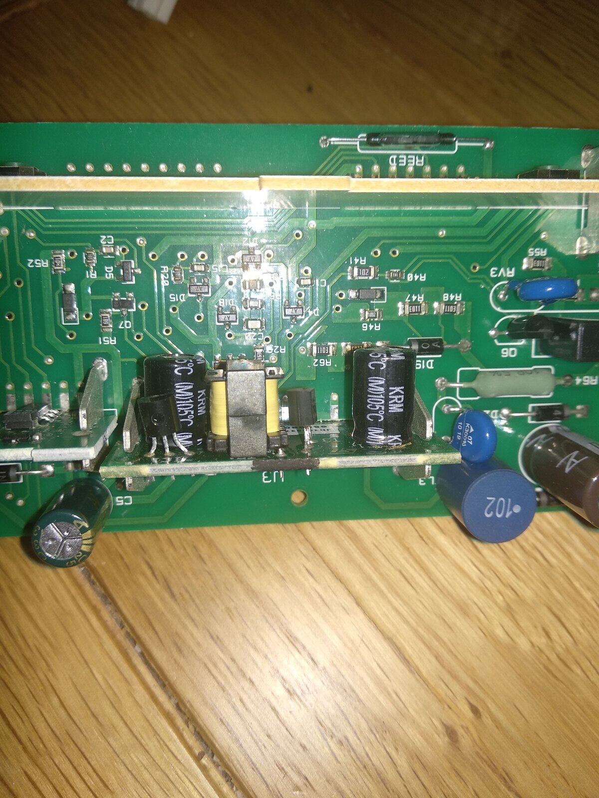

I decided to delve further.
I used a mains voltage tester to test the power going to the motor of the electronic damper unit. It isn't the most accurate thing ever but reported 6v to start with. I later tested it and it showed 24v. I was expecting around 100v.
I checked the continuity of the cables by removing the control board in the to of the fridge. All cables had good continuity to the damper unit.

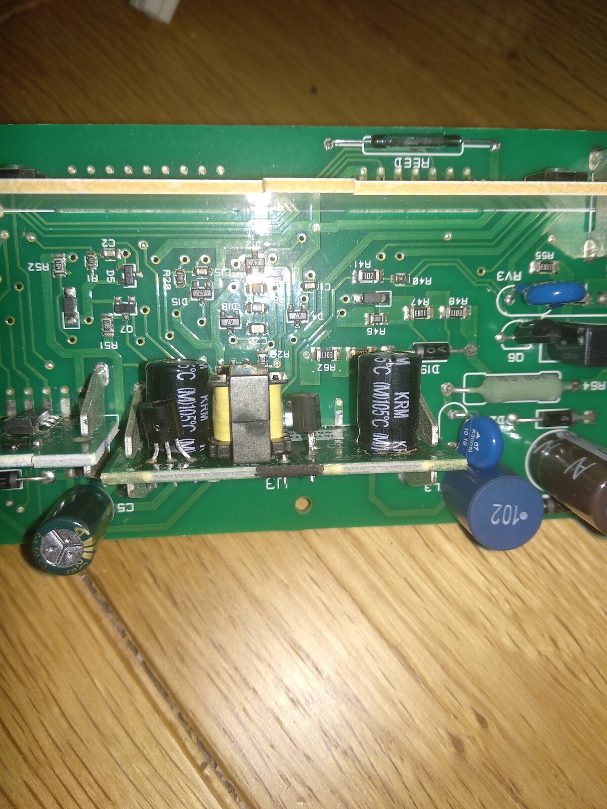

With the board out I examined it. One of the capacitors had a very slight bulge in the top and had a tiny bit of liquid at the base. So I'm going to replace that and see if it does anything. It is a 400v 4.7uF capacitor. I just need to wait for some to arrive. IMG_20200816_001041.jpg
It is the right hand black capacitor in this picture. (Not the one in the bottom right corner)
Well that didn't end well!
I bought an exact match of the capacitor. I carefully desoldered the old capacitor and confirmed that it acted differently with the multimeter compared to the new one. So it certainly looked faulty.
I carefully soldered the new one in place. I then double checked that there aren't any shorts that weren't supposed to be there (the original solder joined a few components, so I matched that)
I put it all back together and turned it on, there was no power light on :( after about 20 seconds or so something went pop, then repeated to pop a few more times, so I unplugged it. I've taken the board out and can't see what went pop. Putting it back in now, nothing happens when I turn it on. No popping etc. So seems completely dead. I checked the 13amp fuse but that was still good.
I think it is time for a new one
