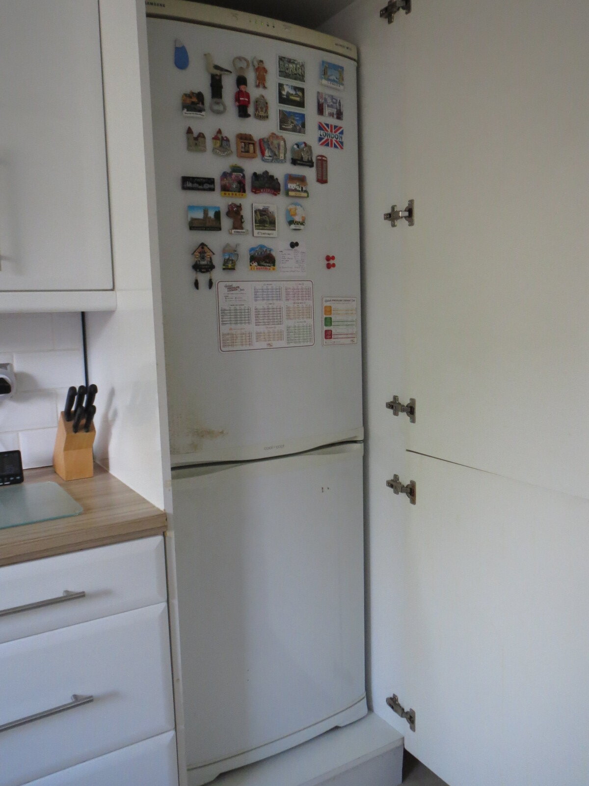

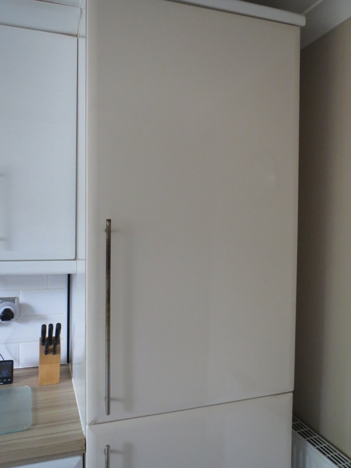

With the fridge being in its own cabinet (see pictures), its likely adding to the sound box effect.

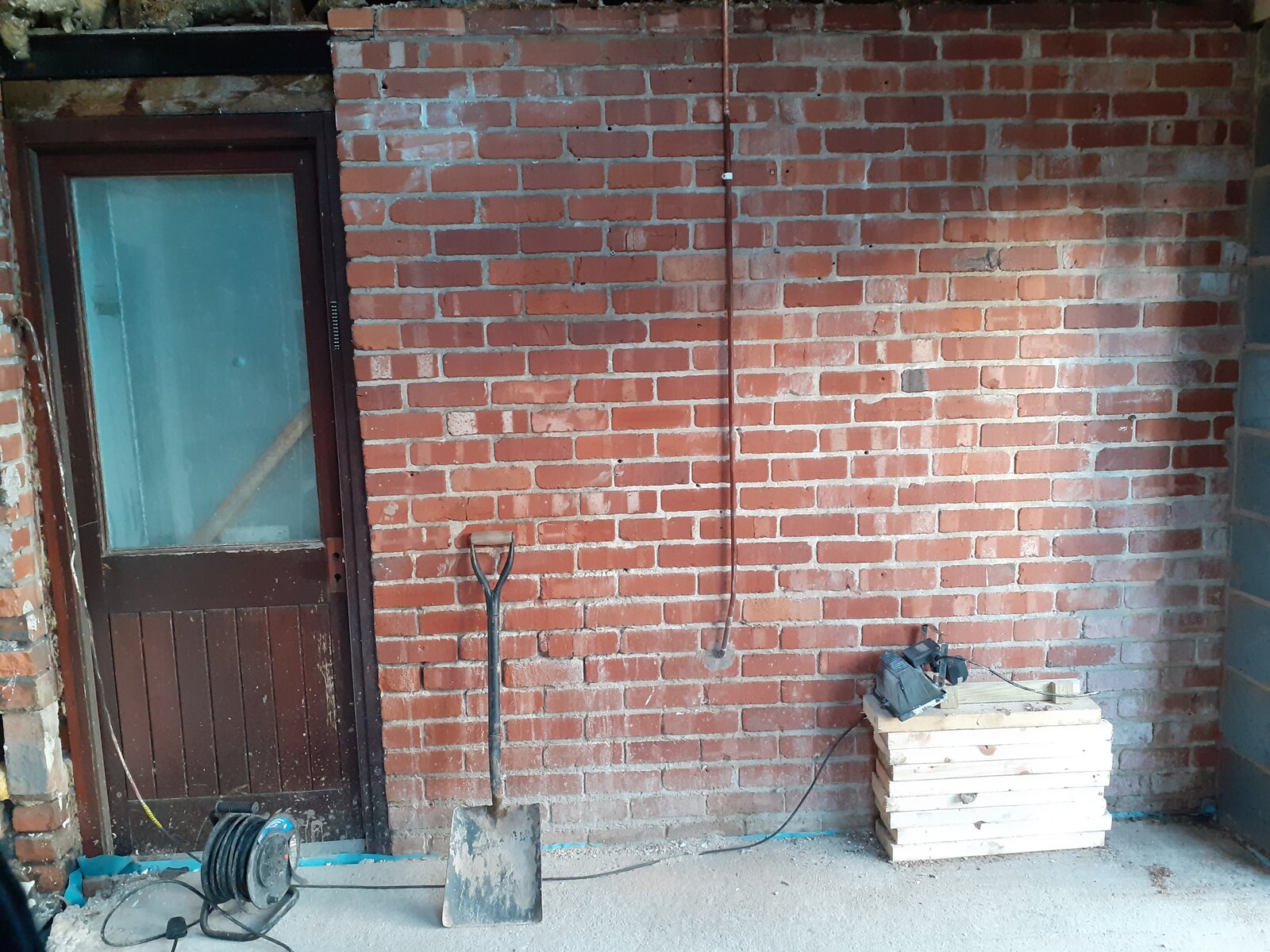

I have attached more pictures: one showing the new extension under construction with the external door - now covered with plasterboard. The others showing the fridge in its cabinet.
Looks like there's a piece of wood jammed between the back of the fridge and the door. That might be causing excess vibration and noise, if it connects with the plasterboard.
I could try pulling the fridge out a bit to see if that causes it to not connect with the plasterboard. Its difficult moving it by myself and with the fridge full of food.

Removing all the freezer drawers is easy, the fridge contents shouldn't take much longer, remove the drawers too, they're glass so heavy, should make it easier to move, though kinda made a rod for your own back installing it like that, gonna always need a makeshift shelf to slide it out onto.

Sorry for the late reply. I moved the fridge forward by about a centimetre and it solved the problem. I can still hear the fridge a little, but its nowhere near as bad as before and the annoying bass, vibrating sound has gone.

If the fridge, in the second photo, is it's new location, then it's in a really terrible location, next to a hot radiator..
