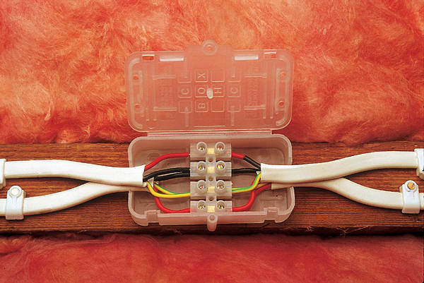

No - the junction box needs to be accessible - use a blanking plate. And if you use connector strip rather than the more preferable junction box or crimps, then you should enclose the strip in a box like this:
The only trouble is I'm not sure that 30A strip fits inside them....
Yes. Choc Boxes come in various sizes for 2, 5, 15 and 30A blocks.
hmm if there is an existing mounting box in the wall that is a perfectly suitable enclosure for terminal block when used with a blanking plate
no need for a chockbox there
