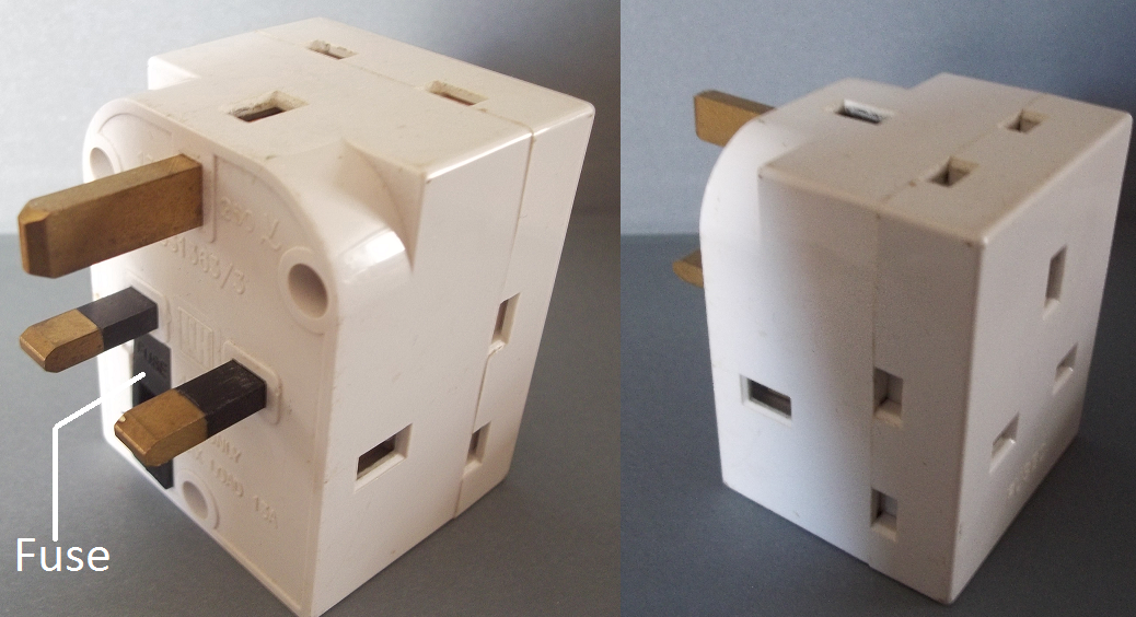

Where does it say that, if you don't mind me being lazy and not looking it up?
There were some early 3 way adapters without fuses. I have one somewhere. It is brown, over 50 years old, and probably came from Woolworths.
I found a couple of those when I was hunting last night - brown, arranged as a 'flat T' and quite probably from Woolworths. I initially thought they were unfused, but when I undid a screw on the back, they came apart to reveal the fuses!
Kind Regards, John
Sure it's not some old chocolate?
Seriously, that's interesting that even 3 ways are not protected by a 13amp fuse. I wonder what make it is?
Next time I'm in the loft I'll did it out of my box of old tat and see if it has a manufacturer on it.
OK I have found it. Defiantly got no fuses, I've opened it up to check. The only manufacturers logo is an octagonal block with the letters IRL in it in descending size along with MADE IN ENGLAND.
