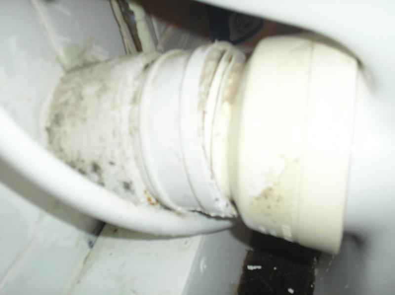

The Collar is just a bit of rubber. When you plunged it all you did was find the weakest joint and pushed the water out.
Without the pressure from plunging it shouldnt be leaking.
try toolstation.com for lists of parts.
I was thinking about getting something like
http://www.wickes.co.uk/Flexible-Pan-Connector/invt/431577?source=123_4
To connect between the cuff and the outside pipe
This should work right?
(thanks for all the advice you all, this has gone from being a disaster to something that we may be able to fix!!)

No probably not they are quite big and not that flexible..
it looks like the soil pipe is coming in at an angle to the pan.
http://www.toolstation.com/shop/Plu...WC+Connector+14+Angle+110mm/d20/sd2887/p91848
So something like this should help it line up better.
The connectors can tolerate mis alignment- but if you get everything lined up all the better.

http://www.wickes.co.uk/Soil-Pan-Connector/invt/431972
This seems to be similar to what you suggested.
It is my hope that all we need to do is
a) Connect the outside pipe that comes in, to the Soil Pan Connector
b) Connect the Soil Pan Connector to the Collar
c) Connect the Collar to the toilet pan
Does that sound right?
I would try screwfix,
yes looks right.
I am not sure about all your stages, all you do is push it all together, a bit washing up liquid to help it slip together is handy..

Something that I have thought of that again seems silly question
Is a toilet supposed to be connected in this fashion?
It has a pipe from outside, some kind of connector and then another connector (which I have been calling the collar or the cuff) connecting to the toilet.
What I am wondering is, Am i going to connect something like this http://www.toolstation.com/shop/Plu...WC+Connector+14+Angle+110mm/d20/sd2887/p91848 directly from the pan to the pipe (ignoring the cuff) or am I connecting it directly from the pipe to the cuff?
Sounds silly I know but from what you and others have explained and how my toilet is setup, I am thinking that I need 4 things, the pan, the collar, the pan connector and the pipe - slot them all together and I am done.... I am just checking that the pan connector and the collar are not the same thing perhaps
The slightly extendable pan connector should be able to make it from the pan to the external soil pipe without the need of an extension pipe.
A
A
So in my picture where there is something connected to the toilet and something connected to the external soil pipe, are both of these called "Pan Connectors?" (and for some reason the people who installed this toilet before us have decided to join 2 of them together very poorely?)
If that is the case then we can explore getting a connector that goes from the pan itself to the soil pipe and throw away the rubber collar then?
I just need to clarify if the rubber collar that sits on the toilet pans outlet pipe is needed or not?

If you look at the connectors the rubber colar is part of the pan connector.

Next task - Thawing the soil pipe.
I took the advise of what others were saying and started at the bottom.
(For those who have this problem, it is hard to figure out what a cast iron pipe with water/ice or empty sounds like - FYI: An empty/hollow pipe sounds plinky or tinny, whereas a full pipe (with ice) just sounds thuddy)
It took a while of hot water spraying for the bottom part of the soil pipe to start sounding hollow, so I went to the next section, and after a bit more time that was sounding hollow
(this takes about 5-10 minutes)
I then started focusing on the junction point and the soil pipe exit from the toilet, this seemed to stay FULL (a quick tap with a broom showed me it was NOT hollow)
I kept at this for 10-15 minutes before thinking it might be worth a plunge!
I went inside, got my mop+carrier bag plunger and did a couple of plunges, a donk sound came from outside and I was hopeful that the blockage had passed... I poured a little water down the pan and it disappeared (such a wonderful sight!) I followed this up with some hot water (even hot water with salt mixed in towards the end) and it was going down... JOY!!!
I am unsure if my plunge dislodged some already part melted ice (from my outside hosing) or if there was a thick blockage of ice in there and since there was emptiness on the other side of the blockage, newton kicks in and the pressure from the plunging kicked it into touch.
I of course need to replace the cuff so that we avoid any leaking from it in the near future, however I am now the proud owner of a working toilet.
