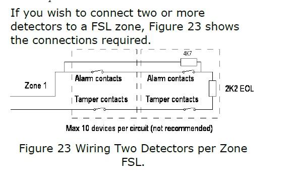

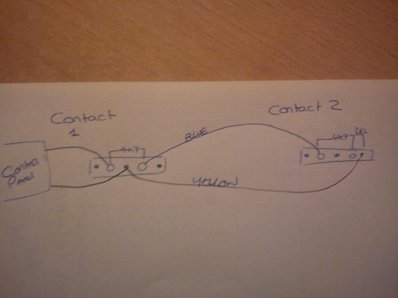

The hand drawn diagram is not the same as the schematic from Scanny.
To solve the problem of both doors being open and causing a fault, follow the schematic....or get a bigger panel.
So go with this:
