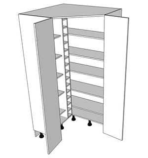

I am installing a kitchen with a full-height corner larder like this picture. The corner is wider than 90 degrees so I can't get everything tight. If I align the wall units against the wall, I get a gap where the larder butts the adjacent wall unit. If I align the units against the larder, they aren't flush to the wall.
What options do I have? Is covering the gap with trim the only one?
bsr
Align to unit and infill panel at wall.
Not familiar with the “term wider than 90 degrees.?
Thanks.
The corner is not 90 degrees. It's maybe 93 degrees.
If I fit the wall units tight to the corner unit, the other end of the wall unit ends up about 10mm of the wall. If I continue to butt the units for the whole run the last wall unit will 50mm from the wall--not doable!
Thanks.
Why ? You need a slight gap , doors need room to open especially if they have protruding handles.
