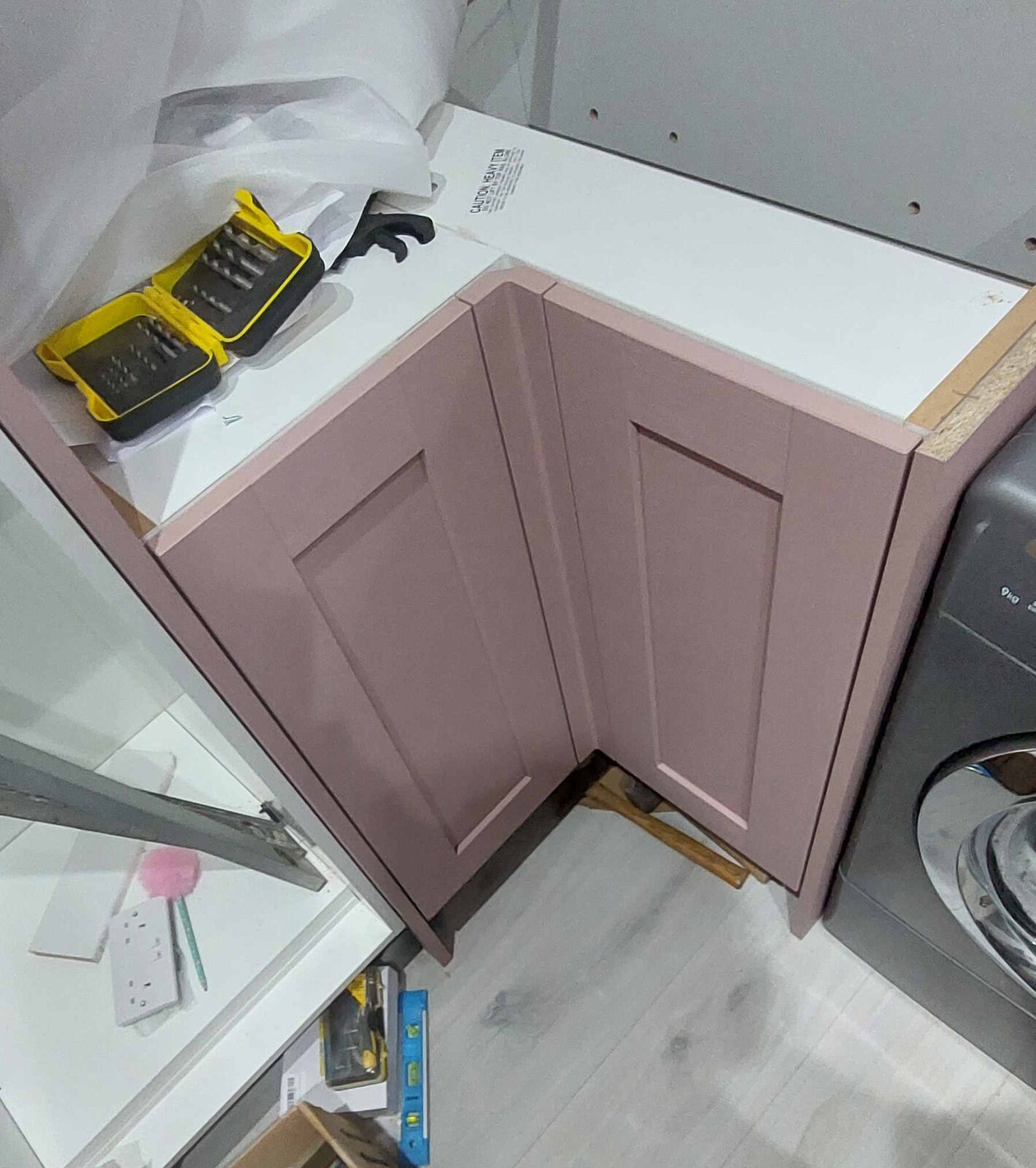

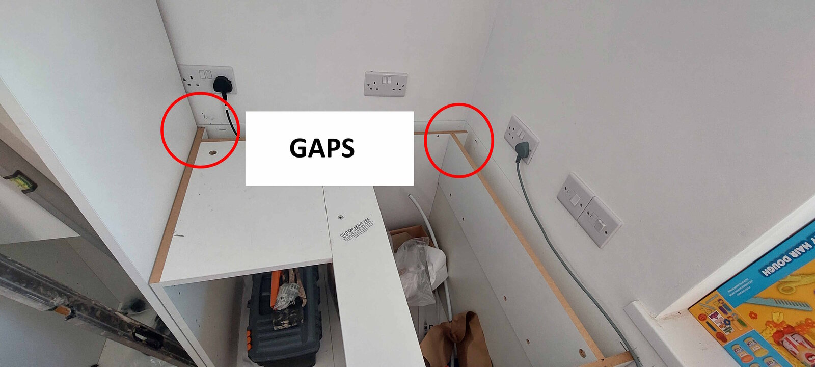

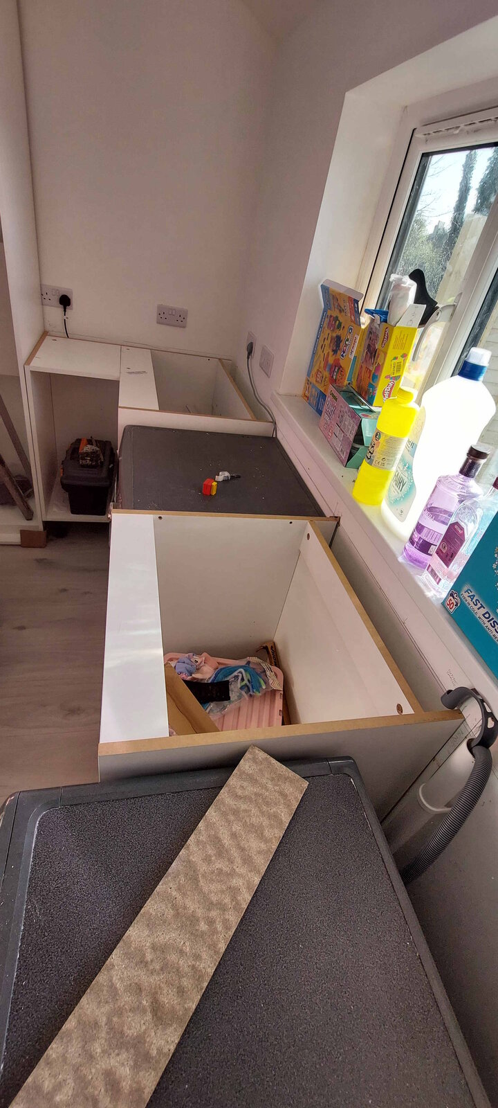

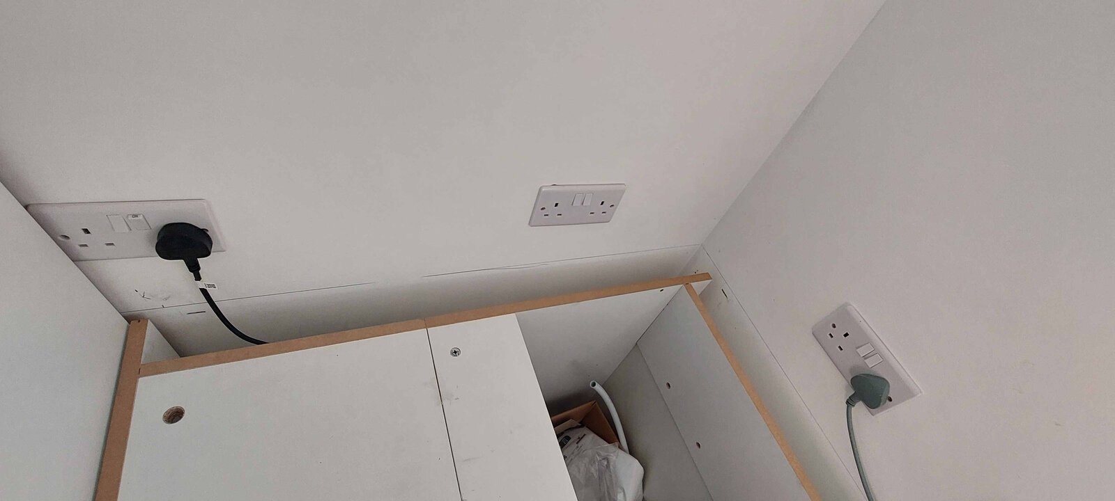

Hi guys,
First go at fitting some kitchen units so please be kind :)

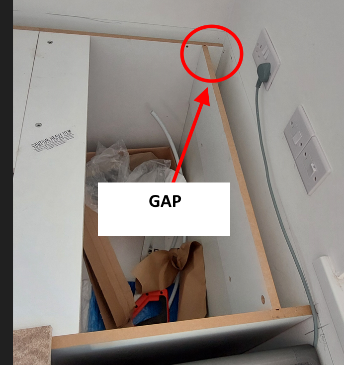

Ive started with a straight line across the back wall at 875mm from the floor and then levelled the units (there are only 2) to this line. From that Ive checked the front bottom and top of the corner unit to the other unit are in line but to achieve this as you can see from the pictures I need to pull the corner unit away from the wall to be straight with this units - is that ok as long as I fit a sturdy L bracket in place to hold? There is quite a gap for one of the 2 edges that "should" touch the wall but in order to make everything straight I dont really have many options do I?
The tall larder unit (I know I need to move those sockets over etc) will also need to come away from the wall so it sits in line with the corner unit again a sturdy bracket or do you have some clever ideas?
Thanks!

Always keep your work as square and level as possible, and ignore the walls.......you'll find away around these later. If you try to adjust things to suit the wall it will come back to haunt!
L brackets will be just fine, and once the units are joined together, maybe with a work top, they will be as solid as can be.
Enjoy your project!
John :)
Straight line is required to front of unit where your worktop will overhang, small gaps to rear can be hidden by upstand over the worktop or by using over size work top cut to fit flush with wall. (Worktops of 650mm widths are useful for this.)
You can cut back the rear of units for a closer fit but this reduces the worktop overhang to front.
One thing to watch out for is the tower end panel that goes between the corner base unit and tall larder. Often these panels are only 595mm wide so if you have a gap behind the tower unit the end panel accentuates the gap by being itself not wide enough.
The service gap is about 75mm which means you can scribe the gable sides to pull the units closer to the wall, I would scribe the run with the towers, not the sink.
Normally on a handled kitchen the worktop over hang from front of carcass to front of worktop is 40mm but on Benchmarx & Howdens with 600mm worktop this reduces to 35 or 30mm. My point is you need to check the size of your worktop to ensure the gap at the back corner doesn't end up being over 10mm and the overhang isn't less than 30mm.
The stand pipe isn't required. The waste pipe can go into a spigot trap on the sink then you push the appliance back to the wall.
With a corner cabinet you cannot always get all the gables touching the walls because walls are hardly ever square. The wall maybe out of plumb at the bottom which will stop the cabinet going against the wall at the top but you can scoop 20mm out the bottom of the gable out up till about 50mm from the top then you still keep the correct depth of the cabinets (if you cut the top of the gable down in depth and there is appliances on that run they will stick out or if they they are integrated there may not be enough depth to fit them) , which you can use to fit a L bracket. But also you can’t always follow the walls but once you have cabinets level and screwed together check the run of cabinets fronts with a straight edge to make sure the run is straight (you may have to pull a cabinet more off the wall to make it straight the rest) before screwing to the wall, by doing this is will help when fitting worktops. Also check the depth of your decor end panels because some kitchen suppliers don’t give anything to scribe off the panel and also check how deep your worktops are.
Hope this helps and I hope it all goes well
Regards
Anthony

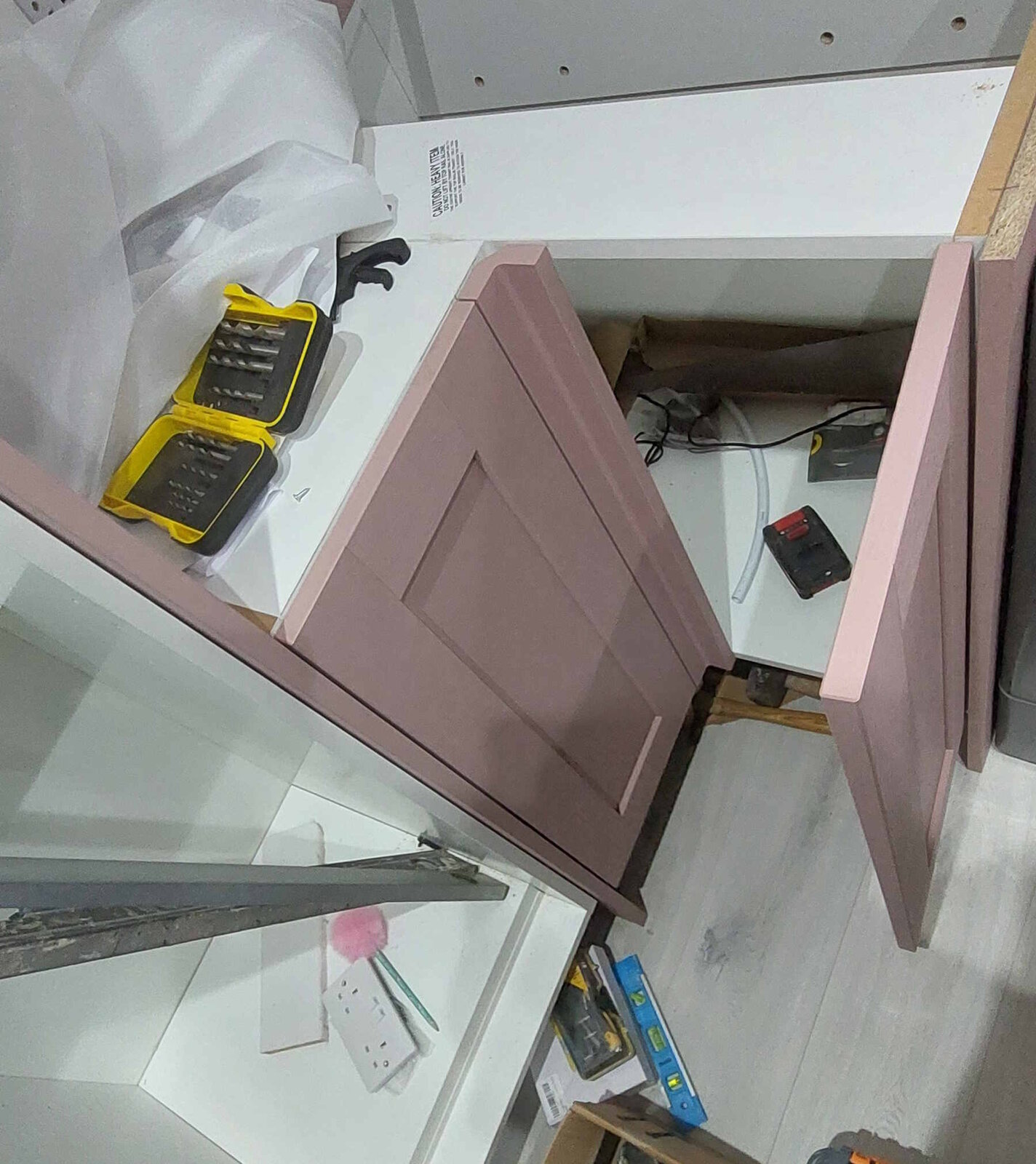

Thanks guys Im actually making progress would you believe!?

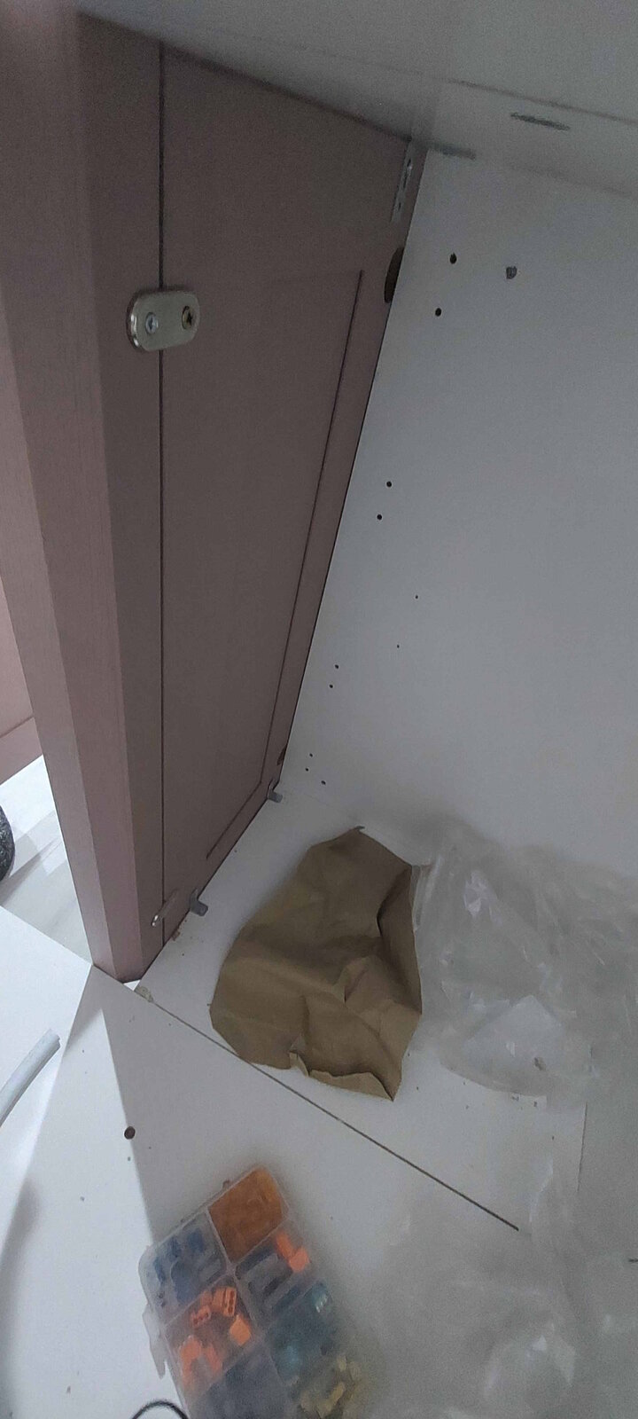

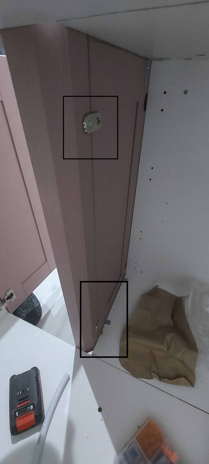

I do have one strange question though - its a howdens corner unit which I have fitted and put into place. From the drawings its a fixed door with a post and then the door which opens - great he says lets fit it.
I have and Im just a little confused\concerned if I have fitted the post correctly?? With the 2 brackets coming across from the fixed panel to the post I would prefer something a little more solid. I was contemplating some L brackets to the base but thought I would ask the professionals :D

At least I'm on the right tracks just got some L brackets to attach with.
Also If I glued I wouldn't have maintained the gap

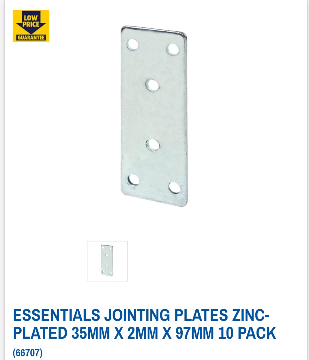

The way you have installed the corner post to the door is correct using the two jointing plates supplied.
I find them adequate for holding the corner post but you could add an additional one one the middle.
Alternatively you could swap for two of these jointing plates fitted vertically to the post.
