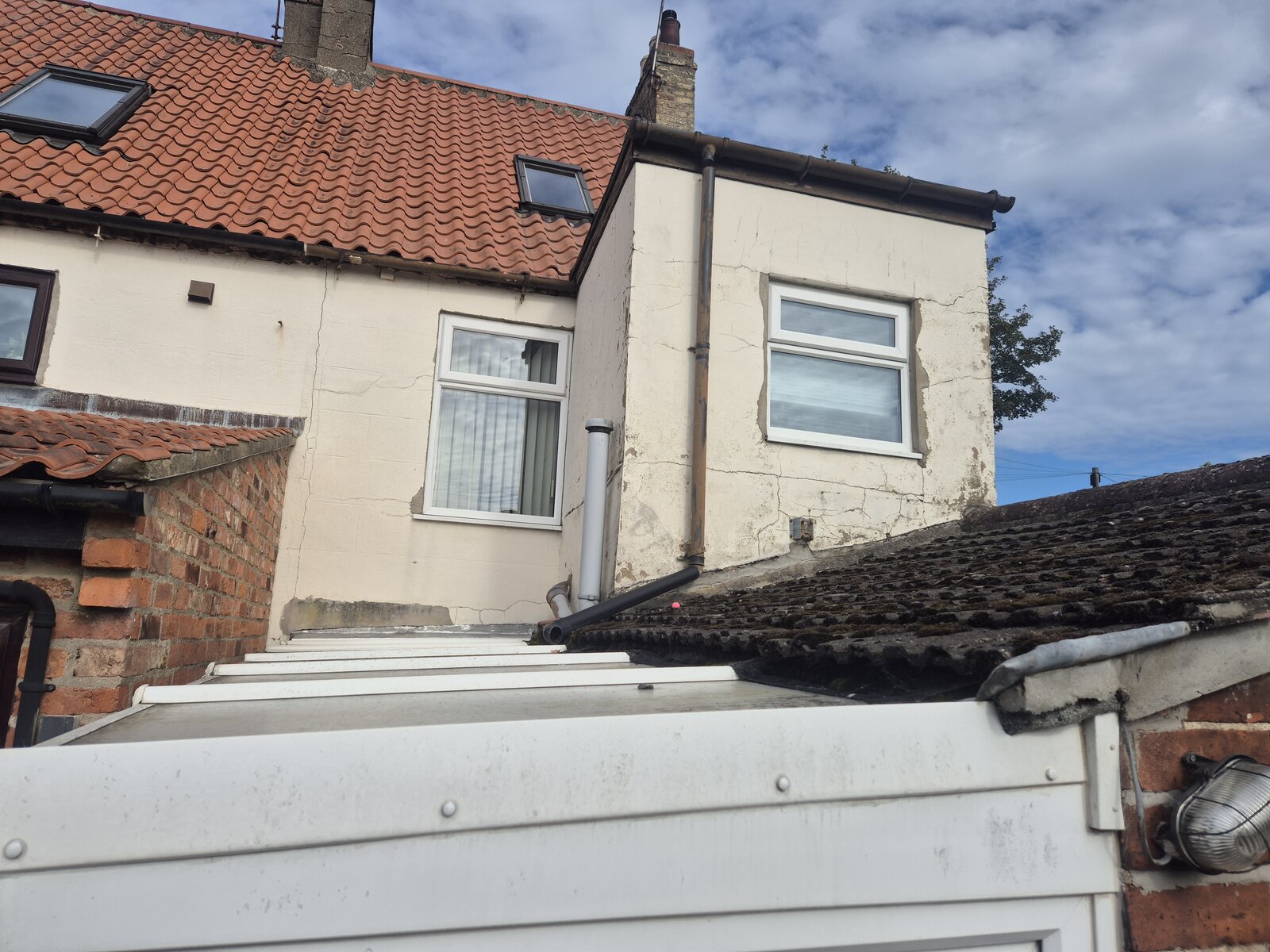

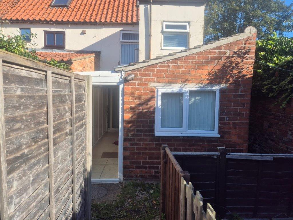

I am looking to get a property that requires full renovation, which will need to be completed through building control

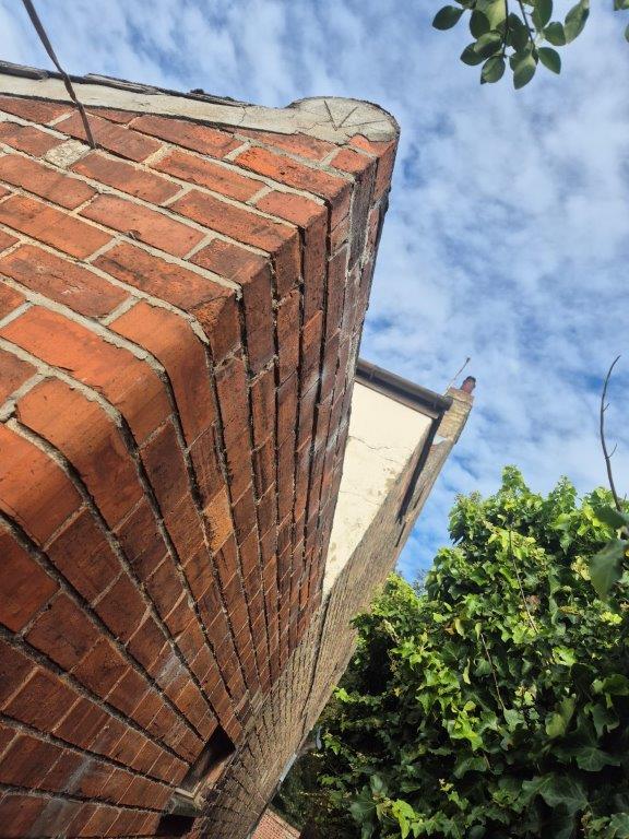

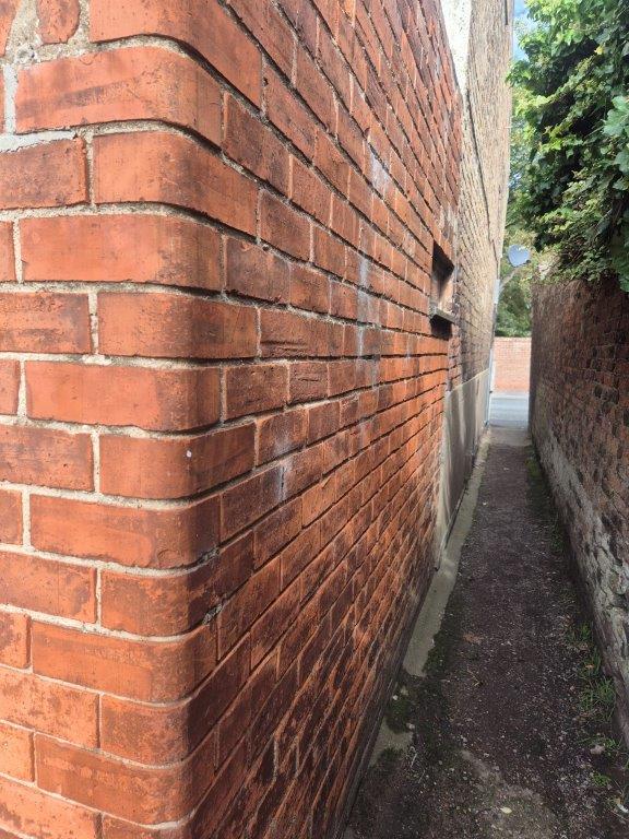

The extension at the rear of the property which incorporates the kitchen is constructed with single brick (see pics)
Can anyone tell me roughly what would be the requirements of building control, and would for example 100mm of kingspan insulation on the inside be acceptable to satify their requirements?

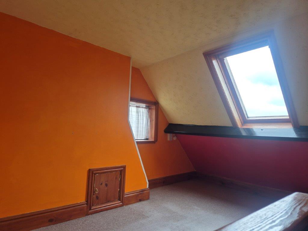

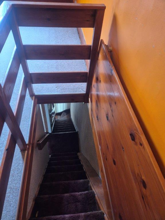

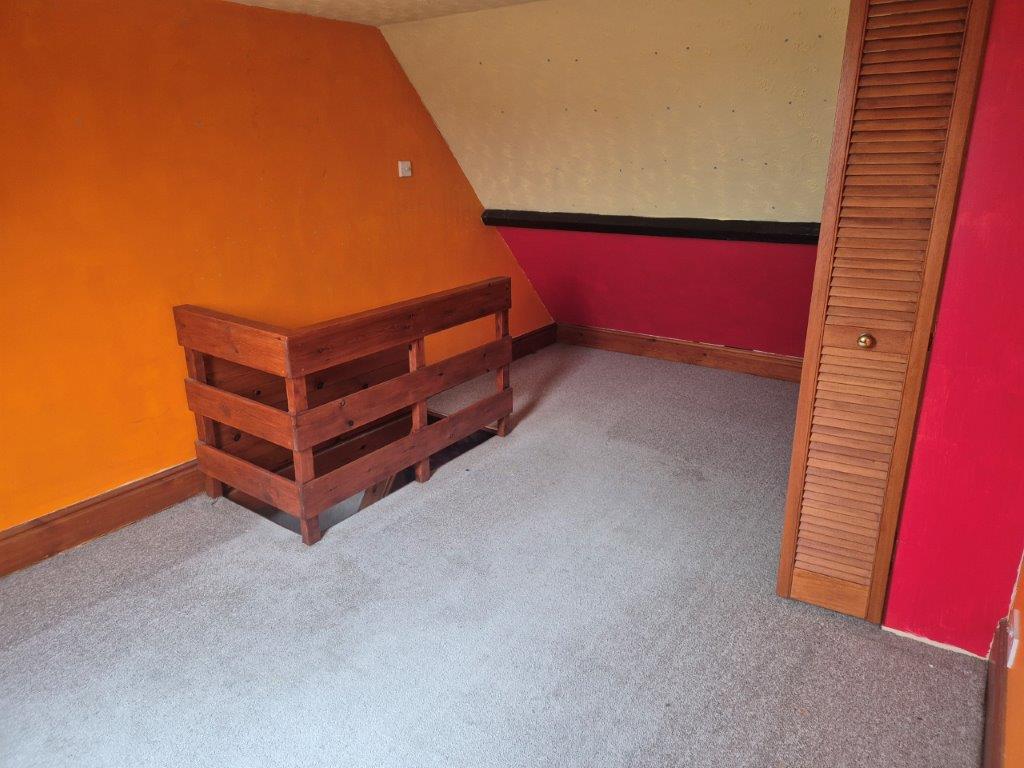

Also, the property will need to be brought up to MEES standards to meet current EPC ratings. Its was built around 1890, now with a concrete floor throughout, and solid brick walls. It has a loft conversion, with what I am guessing was constructed on the existing ceiling rafters, and not with an independent supported floor. The staircase leaing to the loft looks to be acceptable. Does anyone know (again roughly) what are the building regs required to recognise the loft space as a habitable room (bedroom)? and going by the pics if possible, would it mainly be down to insulating it to current MEES requirements?

How long is the piece of string? You've not got proper headroom off the stairs and the rails don't comply for a start.
You need to take someone round who has some experience to guide you: you cou;d be opening a nasty can of worms.

In any case I would build a landing and fit a fire door in the loft.
Fire doors all around.
Insulation: yes for loft and extension.

I fully get what your saying Johnny bit unfortunately Mr rusty is right and I cannot get around BC. I would be surprised if the single brick kitchen extension was ever done through regs. Do you think there is a possibility that bc would make me demolish it?
No that won't happen, but you'll struggle to get any EPC with a single skin wall, and any changes then invoke BC if you want to try and get a better EPC.

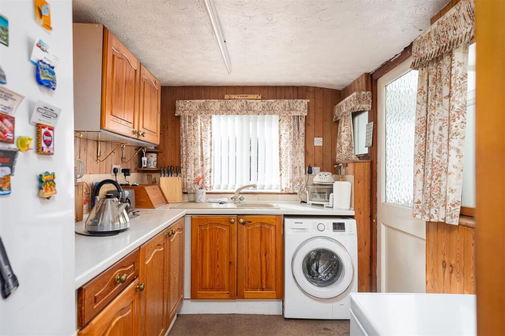

The current EPC rating is F, and I would have to involve BC to sign off on works to acquire a new EPC with improve ratings, My guess or hope is that roughly 100mm of Kingspan to the single brick extension would be sufficient to bring the R value within an acceptable range, however between the ceiling and roof of the extension may be a problem. its a low pitch tiled roof (shown in pic above), but BC may force me to raise it to accomodate sufficient insulation? What do you think? Any further advice very welcome.

You'll only have final answers from BC.
All BCO are different, some very very forgiving, some unnecessarily and unreasonably strict to the point of going beyond regulations just in case.
Lots of Mickey Mouse building companies in London employ private BCO who can pass almost anything...
Just saying...
Does the EPC say what the achievable rating is and how to obtain that?
I know modern ones do, so you could start from there to get an idea of how much work is necessary and if you will ever reach your target.
If you send detailed information to celotex or other insulation companies, they'll tell you how to achieve the u-value required.
