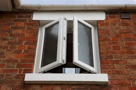

There are obvious safety issues with regards to having windows such as those shown below on the first floor of a house.
I was wondering if anyone had any thoughts on safety issues? Should this type of fully opening window only be installed on the first floor if the bottom of the window is a minimum distance from the floor to give some additional deterrent from falling out? If so, what minimum distance from floor?
You have got the safety issue the wrong way around in that they are opening like that as a safety measure --- its so you can get out in the event of a escape.
Thanks. Yes, well one window upstairs would have to open fully as a fire escape, though would this be restricted to one window upstairs?

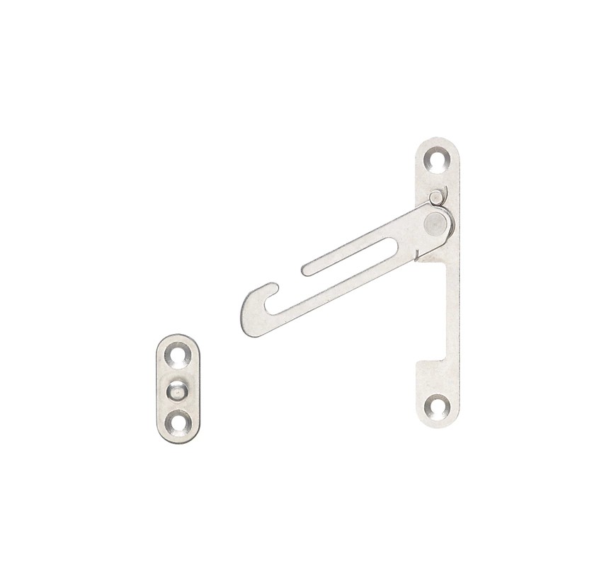

As Randomgrinch says , fit the restrictors if you are concerned. Double glazing companies generally don't fit them as standard but we do have a ' duty of care ' as we are deemed experts in our field ( i know right lol ) . Therefore if it were me then we'd be fitting them in lower level windows , first floor and above , and also in rooms where we see beds below windows.
The minimum gap required for a fire escape window , is a clear opening of 450mmx750mm , and is set at this , not for escape, but apparantly for a fireman/woman to access the property with breathing apparatus...or so I was told by a reliable source

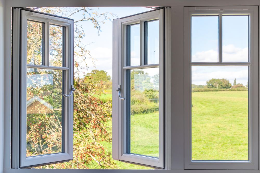

Makes no difference if it's a child's bedroom or not , if you need to meet the minimum requirement and this is the way to achieve it then this style will be fitted. Any habitable room ( deemed by if a single bed will fit in the room ) upstairs has to have at least one means of ' escape ' . Bizarrely there is one exception , which is if you are not making the situation any worse you can replace like for like ( doesn’t work replacing upvc for wood as hinges work differently) , which any reputable double glazing company will try and talk you out of and get you to install Fire Escape windows

No each habitable room has to have a separate escape
