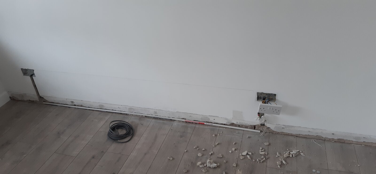

So I'm wanting to install another socket with the dining room area so I'm hoping to install a spur.
However i bought this house 5 years ago and as far as I was aware the circuit is a radial circuit but when I had a look behind some of the sockets in the kitchen they are have 2 legs going into back of them which makes me believe they have done a ring main in the kitchen and dining only and radial rest of house

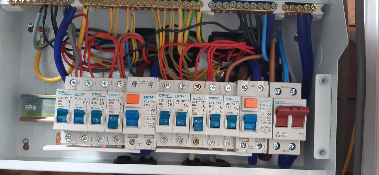

The consumer unit has 2 cables going to a 32 amp fuse for the sockets then lighting etc is run of 6amp fuses with only one wire going into that
Am I okay to run a unused spur of of this socket or a fuse spur then onto a socket?

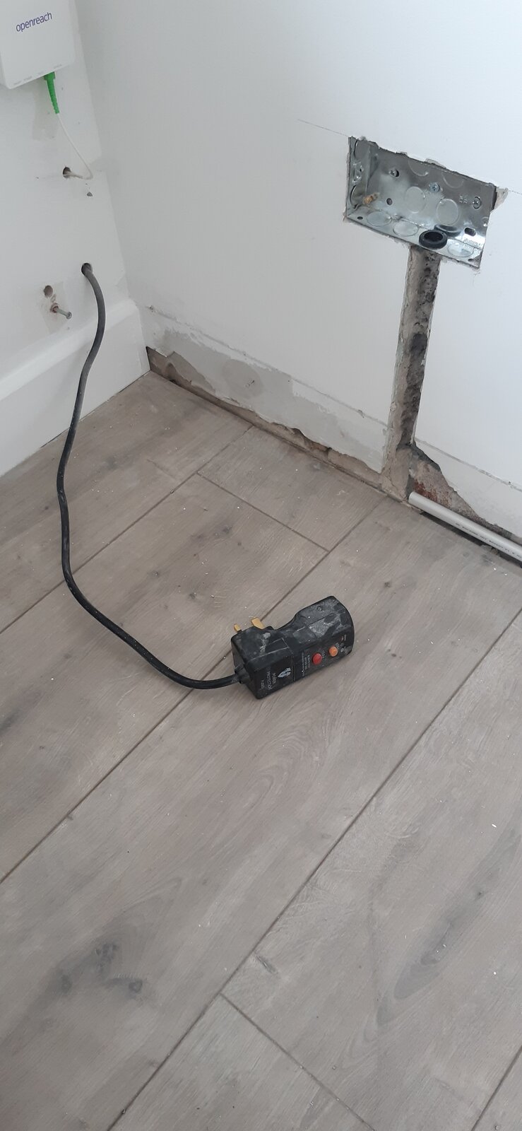

The socket I'm installing is to power the open reach WiFi router and I also have an outdoor weatherproof socket with an rcd plug on that to plug into my potential spurred socket
Just to keep things simple is it safe enough to keep the spur unfused or fused?

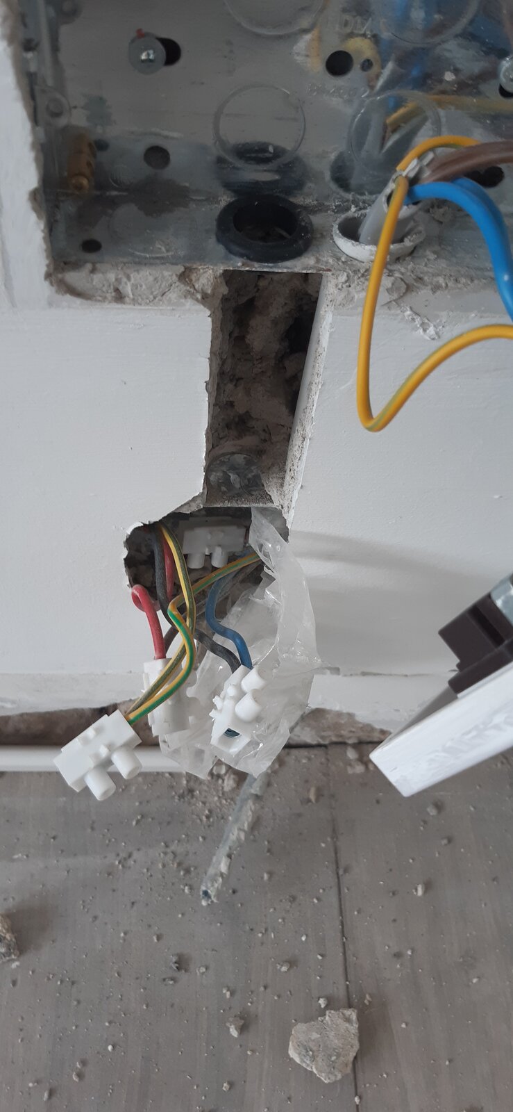

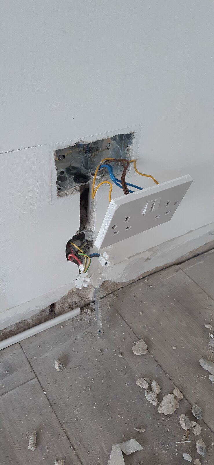

When making the channel I also came across where i think they commented into the old radial circuit using connector blocks and just seemed to plaster over it. Should I place a terminal box here?

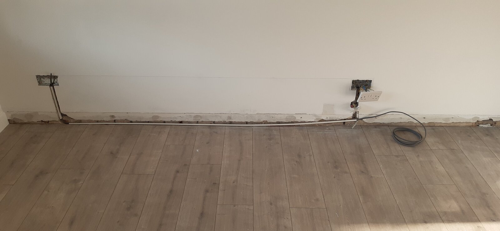

Hi thanks for replying but for what reason is it not advisable as the cable is inside trunking protecting it.
Is it in case someone decides to nail into the skirting?
I don't follow your logic, as taking a random socket face off in a house will highly likely reveal two cables regardless of whether it's a ring or radial
If it used 2.5mm² cables it would likely be a ring. If it used 4mm² it would likely be a radial.
A better assessment of ring/radial would be made by counting the number of cables leaving the fuse/mcb/rcbo rather than at a socket
Regardless of safe zones the cable is still gona be staying behind the skirting board simple as that
I doubt anyone will put any nails that low
Be more of a hazard if the cable was in the safe zone half way up the wall where ppl hang pictures and TVs etc so imo ut much more safer behind the board
Drop the cable(s) beneath the floor and keep the installation safe. . you know it makes sense(y)
Neither checking at the MCB, nor at the socket, will definitely confirm it is a ring - The only reasonable way to be reasonably certain it is a ring, is by checking continuity between them, when the two conductors of an assumed ring, are separated. Even that method, is not absolutely fool-proof.
What's the best thing to do with these cables that the previous ppl had jus plastered into the wall?
