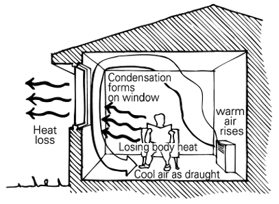

To control a room with a TRV, we don't want the TRV to get cold, before the whole room gets cold, so we want the radiator on an internal wall, once running it does not matter, but you don't want the heating to fire up before required, but years ago, the idea was to heat the cold part of the room, we see diagrams which look really good, showing what should not be done, circulation2.jpgbut it fails to take into account that modern double glazed windows are far better, and to put the radiator under the window means the TRV is colder than most of the room, until the heating is running, so turns on the heating too early.
