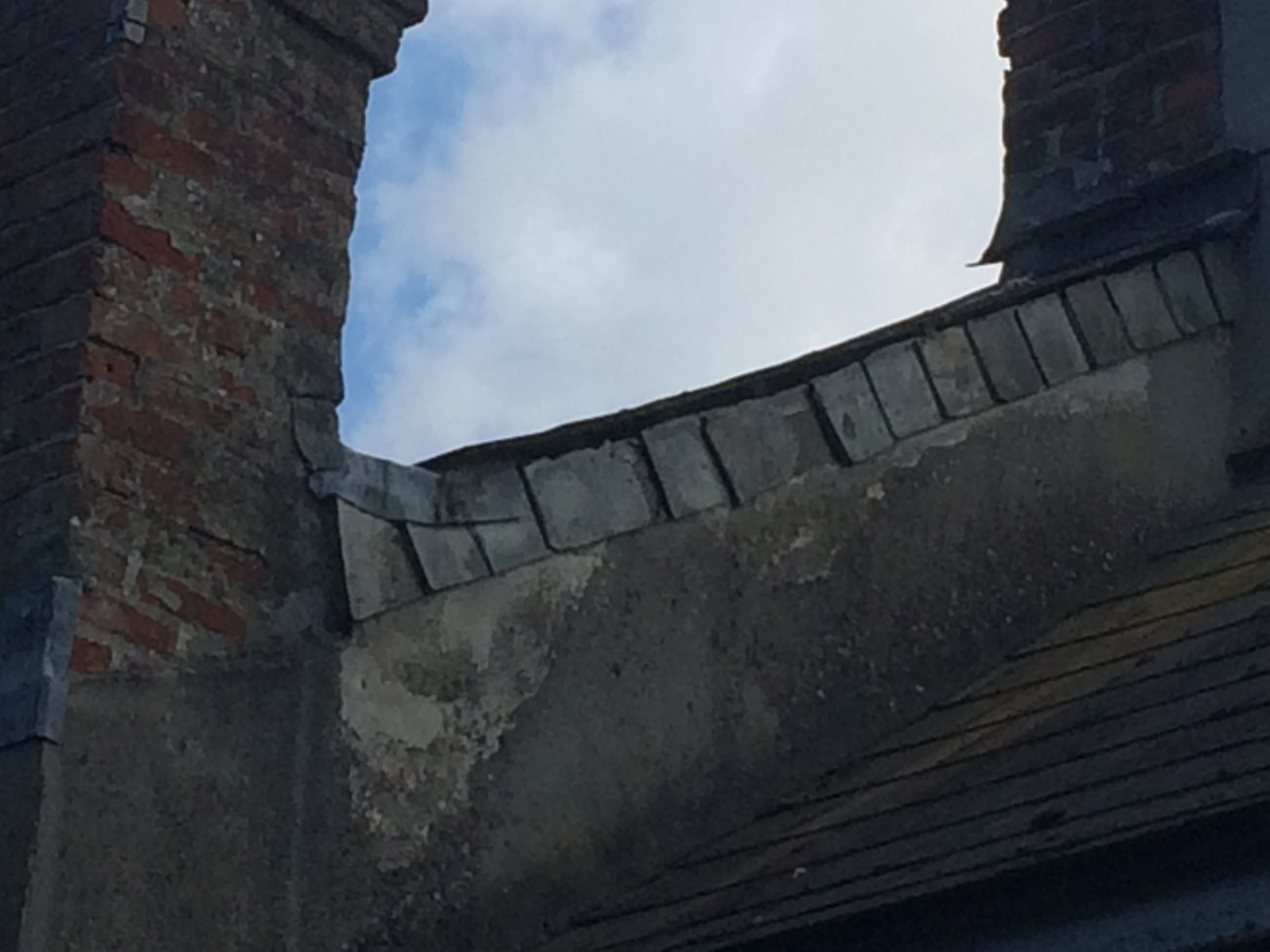

Gable end missing slate.....best way to repair?
14 Jul 2018
2
Hi, I'm new here and looking for advice on best way to repair the gable end of my cottage?
Thanks in advance
Ronnie
It's weathering the verge. I'm not convinced it is doing an awful lot but a piece of lead will suffice.
What would be a better alternative for it ?
Could I take it all down and replace with something else?
If there is nothing inherently wrong with it, why you would want to mess about with changing it?
A timber bargeboard brings with it the faff of altering the verge and ongoing maintenance every three years. And I don't think plastic is a realistic option.
Get someone who knows what they are doing and repair or overhaul it, and not replace.
