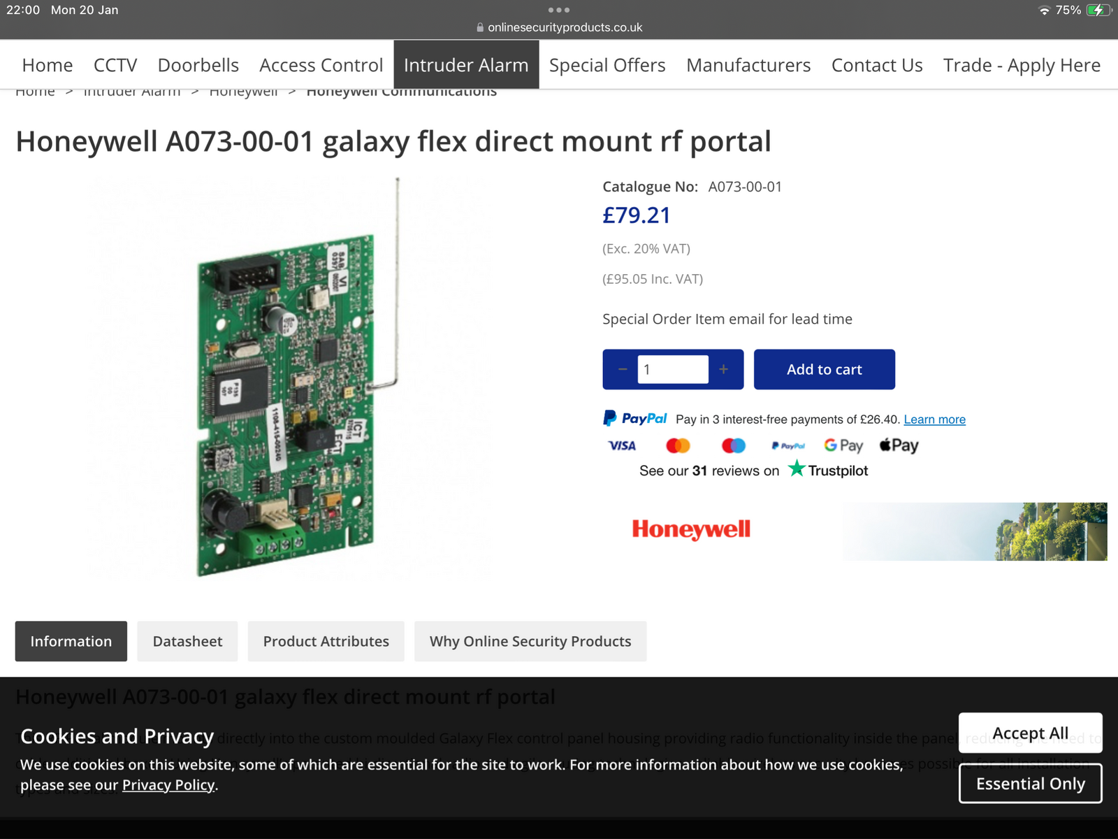

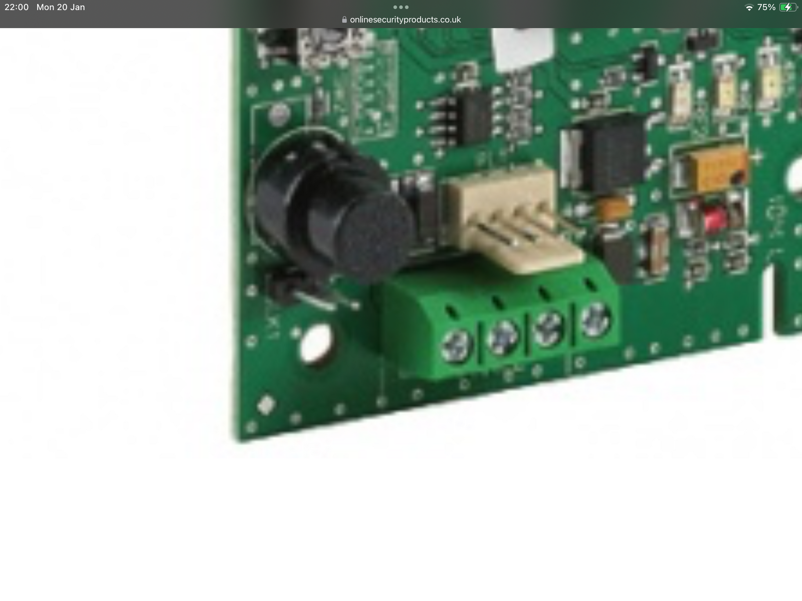

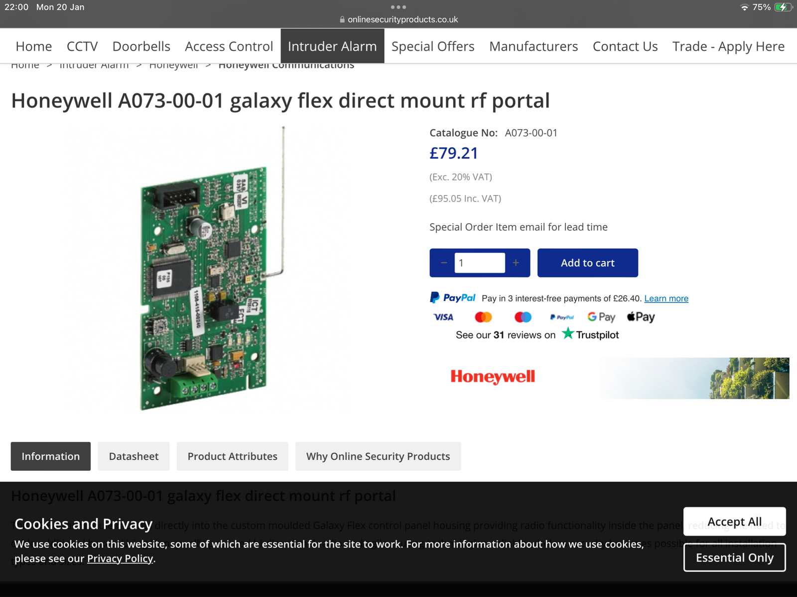

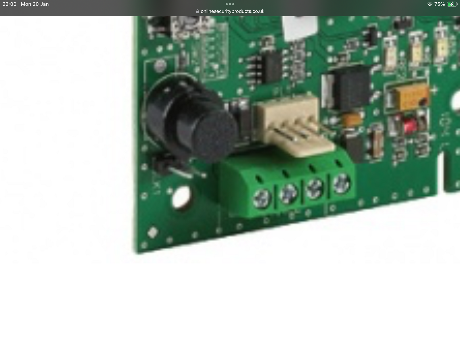

Hi
This is going to be very simple for someone to resolve, however i've fitted a direct mount RF module inside my Flex Control Panel.
However i cannot exit engineering mode due to RF Tamper
I cannot find anywhere in the manual or leaflet how to disable the tamper for the module, seeing as it sits inside the control panel and not a separate panel with a lid to close the tamper!
thanks
Put a link on the two pins near the tamper switch ( black button ) ?
